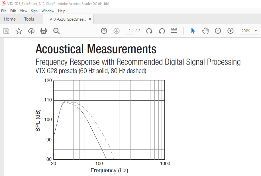

biggest JBL prosound subs do go to 20 hz. example: VTX G28Actually read some of the threads over the years. I've been posting here 20, not since last week.
and those are 18" not 21" ...
Now George, you're not expecting to be taken seriously with that comment are you?
Here's JBL's own frequency response curve for that box, with processing, from their own spec sheet:
It's clearly well over 15dB down at 20Hz, with maximum level at 30-40Hz.
Specs say 22Hz at -10dB. Published measurements agree.biggest JBL prosound subs do go to 20 hz. example: VTX G28

Fs of the 2269H is listed as 28Hz.
Now, because it can do 30Hz, are they typically used that low? I'd be surprised if they are unless absolutely necessary for the particular job.
The cone diameter of a driver does not determine it's LF -3dB point.and those are 18" not 21"
Half power has been the standard for a very long time. i win.i didn't say anything about -3db.

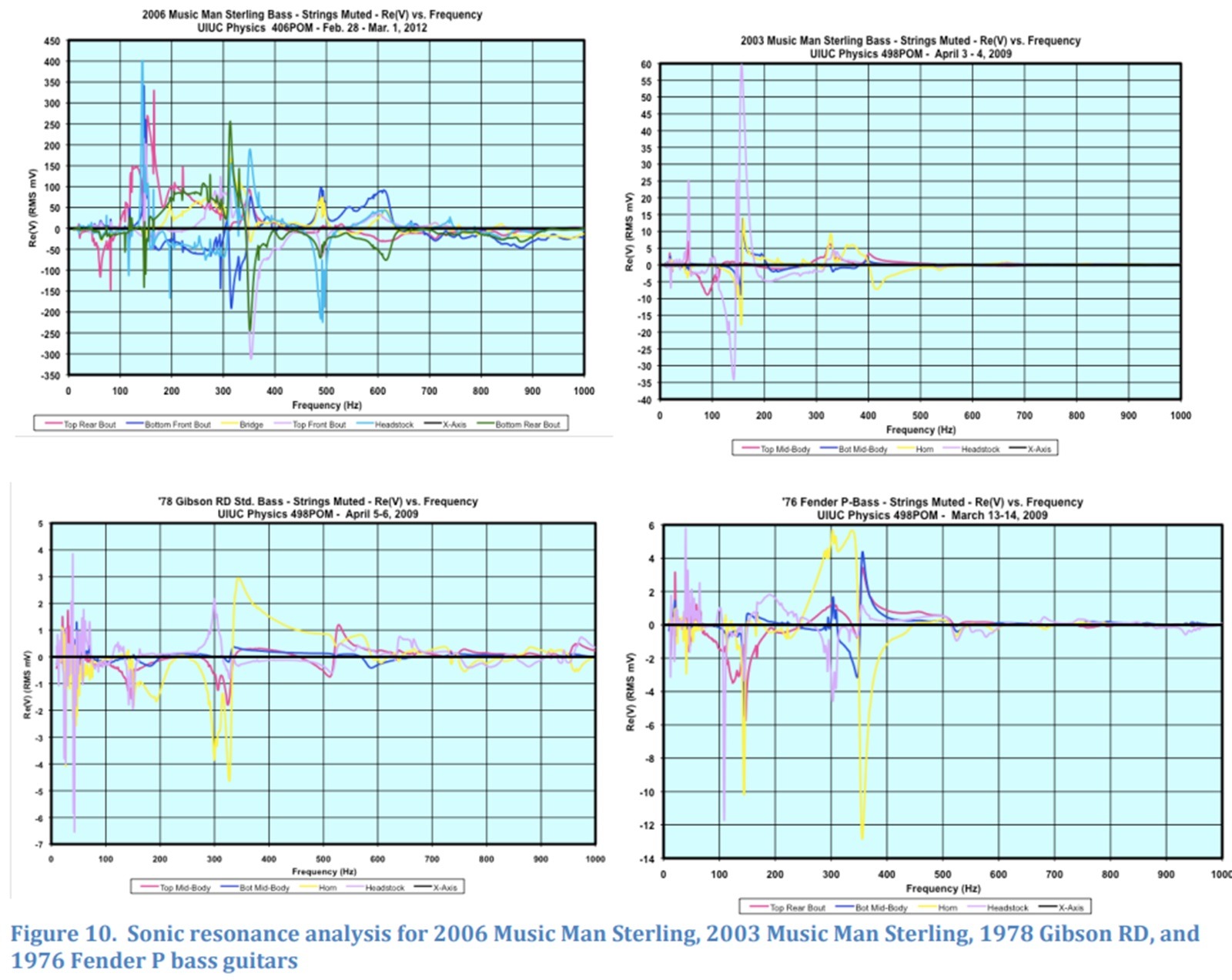

About music signals, most instruments resonate also below the fundamental frequency, and eg. double bass player often plug strings and thump the body. These very low freq tonal effects get reproduced best with closed box pa or hifi speakers. Same applies for classical orchestra recordings, hall sound is not just sum of fundamentals... Closed box bass typically goes lower (specially with room gain) and has better timing (lower GD), which is important for transient thumps. Some manufacturers like B&W use low BR tuning (around 30Hz) to help this, while typical hifi floorstanders are tuned around 40Hz, bookshelves around 45Hz.
https://courses.physics.illinois.ed...12/Michael_Zevin_P406_Project_Report_Sp12.pdf

I've read it all now, and have owned a couple of EBMM, P, and though not an RD, I have had TBirds.
It's very hard to read the linear scale, but I'm not sure in the electric basses there is anything musically useful below E1 displayed.
The key take home for me from that study (wrt Electric basses, I don't play double) was that it was looking primarily at the body (etc) resonances with the strings muted.
It would therefore only be highlighting frequencies at which the body might add or take away energy from the string when played normally.
The actual string fundamental and harmonics will be as we already expect.
I know both of these use guitars, and not quite the same as the study, but I still think they're relevant and interesting to watch anyway.The key take home for me from that study (wrt Electric basses, I don't play double) was that it was looking primarily at the body (etc) resonances with the strings muted.
