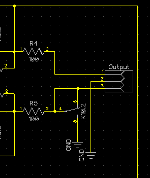

Yes, I added a relay for the output GND now.Unused output makes no problem i think, its not input, it will not pick-up noise. Making it disconnected from output jack in single ended mode will need to use additional relay , but you can do that.

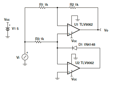

Buffer would make divider output have exact voltages as calculated ,if you care about exact decibels .I'm unsure if with current schematic load of both dividers is identical - it means you have worse common mode rejection like mains frequency noise, because for any active variant of conversion input voltages must be equal. Also ,why you used two opamps to convert from balanced to se ? In post #2 i gave you link to simple schematic , which does same ,but uses just one opamp, so less noise probably and complexity. And second channel probably can be used as rectifier .I remember exists a circuit with opamp and two diodes ,which uses again one opamp to rectify AC to get DC .Even biased NPN emitter follower can serve as rectifier , loaded with resistor and capacitor in parallel.

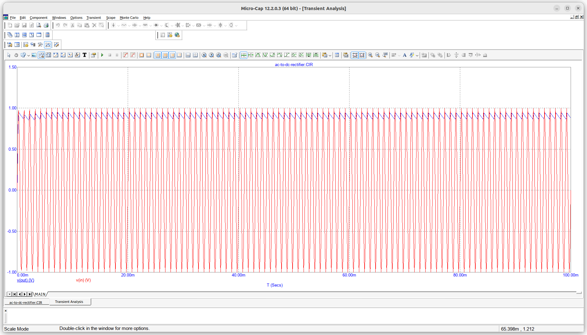

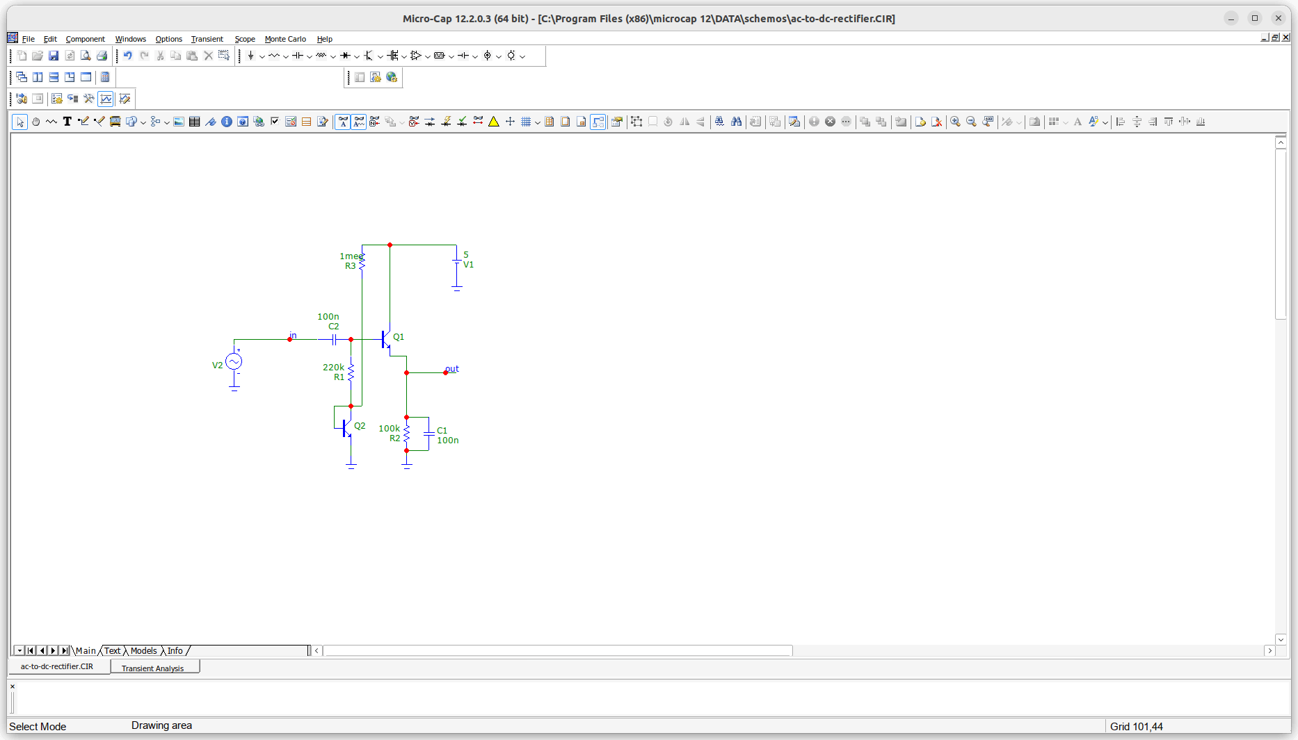

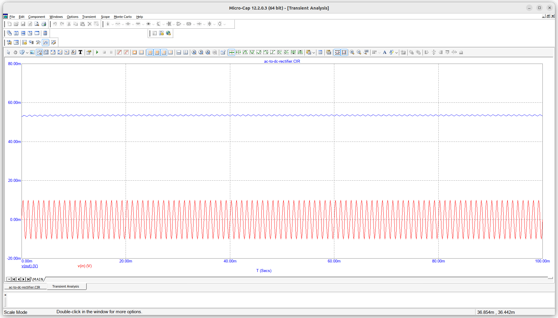

Have just simulated simple rectifier circuit and its output .May be useful. Output waveform with 1 KHz 1V input and 1KHz 10mV input .
Nice sim.

I will consider this also, but reason I used the other circuit is, that I belive that the idea with the rail to rail TLV2462 with this circuit TI is good.why you used two opamps to convert from balanced to se ? In post #2 i gave you link to simple schematic , which does same ,but uses just one opamp, so less noise probably and complexity. And second channel probably can be used as rectifier

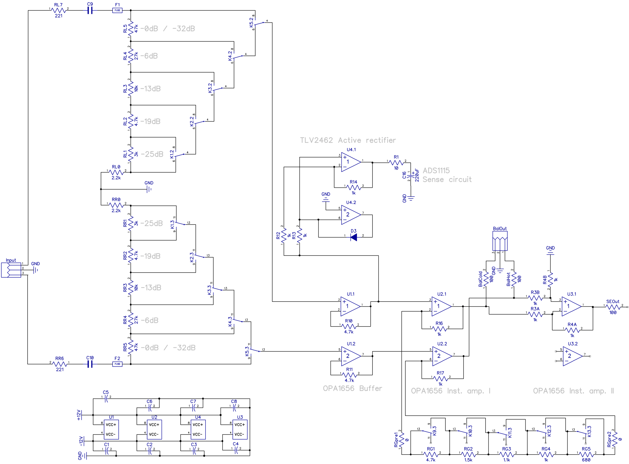

Hi all...
I simplified the schematic I use, to only show the "analog" part of it.
The ESP32 is controlling the inputlevel, through the sensecircuit (TLV2462 active rectifier).
This is in ~6dB levels from -0dB to -32dB giving the circuit a working window from 300mVrms to around 45Vrms when output around 1200mVrms is chosen.
The output is controlled via the OPA1656 instrumental amplifier part I.
The output can be set in 100mV levels. E.g. when you choose to have output at 1200mV, an input from around 300mV to 1000mV can be scaled to this.
This is working fairly good, using combinations with relay's K9 to K13, giving gains close to x1,2 ... x2.2 in 100mV steps.
This way, I can reach the best scale on my soundcard.
I hope I can also success in coding this to other windows like e.g. 2500mV to 3500mV, let's see... It should be possible to do soo 🙂
The SingleEnded (SE) is send through the OPA1656 instrumental amplifier part II to the soundcard.
The balanced output are supposed to be used between the instrumental amplifier part I and part II.
But I'm not sure this is the right way of doing it?
I see other autoranger's where they convert the balanced input to SE, and then rebalance it at the output, but I would if possible avoid this.
Also I'm in doubt where I must GND circuit when using it SE ?
Comment's about the circuit is also very welcome.
