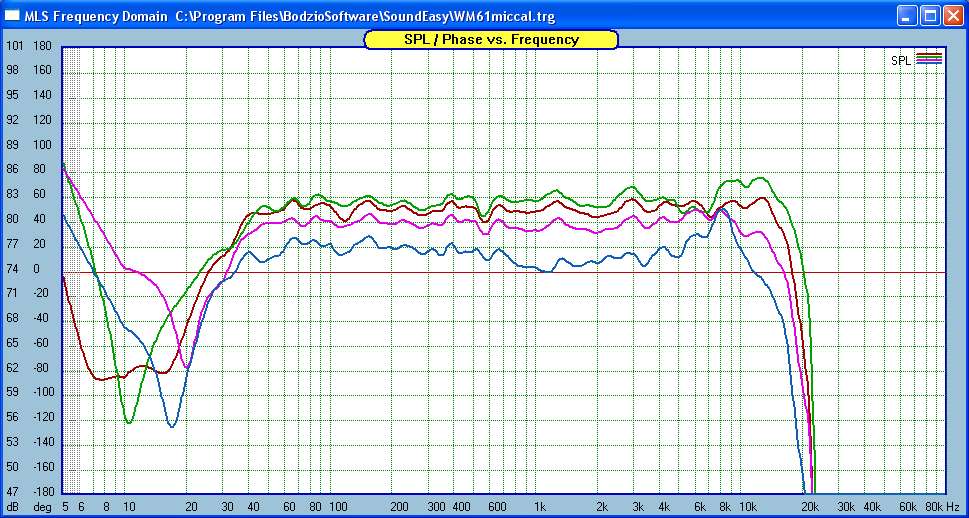

This is a measurement from a dipole speaker at angles 0, 30, 45 and 60 degrees. If this isnt good CD over a very wide frequency range, I dont know what is.

My point is that a proper dipole can have quite close to perfect CD. Making such a speaker takes more than just putting a driver on a flat piece of wood.
