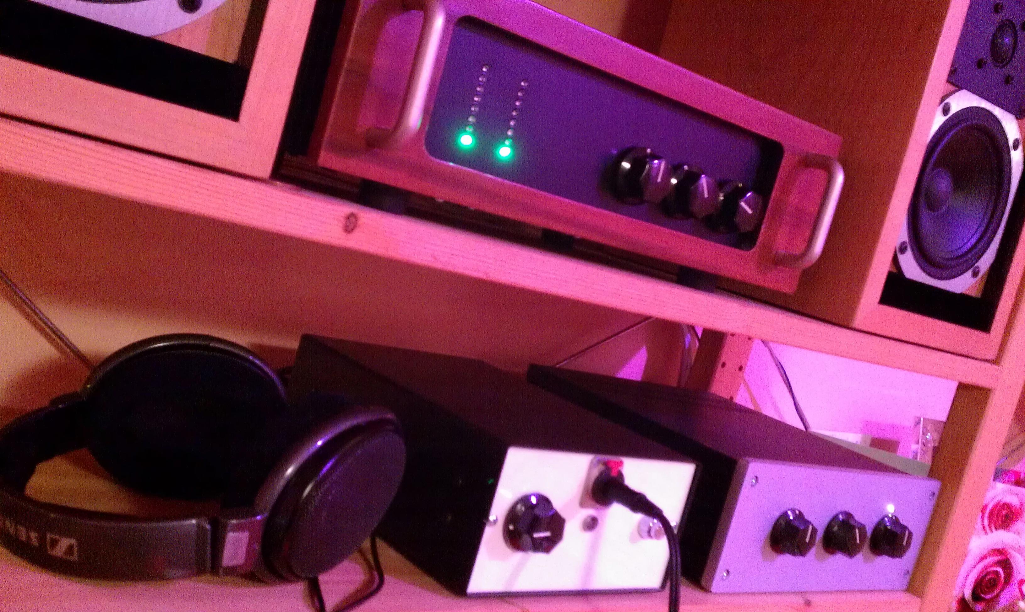

I was thinking of building something on veroboard temporarily. I got plenty of compos i'm sure I can put something together. Any suggestions of a simple approach welcome.
I'm using SDS headphone amp. It might not be very best but it is cheap to build and it delivers plenty of power. If I remember correct I have to modify it slightly. I also tried Gyraf's tube amp but it's not working for me...and also Gyraf's HP amp which is also cheap and simple to build. SDS is more Hi-Fi and HP is mor ''studio''. Both work fine for me. Again just my personal experience and taste. I might have specific and corrupted taste as I'm mix-man living in London, not Hi-Fi enthusiast and I prefer to keep things simple.
If you need any additional info let me know. I might have even some spare pcb boards back at home.

That tube amp use only four tubes. Double triodes of course so that's 8 sections for stereo.
I have no idea about what you are asking and I'm unable to measure anythin due I left that amp at my home town. If you really want I can arrange something. If I remember correct there I have some problems with oscillations, and I really can't tell what I do about that. Maybe I install some grid stoppers? Who knows. I might have some spare boards if you want.
But. That amp can't drive HD650. At least not for me.

Anyway I get some information about Gyraf tube amp. I asked my brother and he has made some measurements. Voltages are always just before clipping with different loads and input voltages at 2kHz
in 0,5V, out 11,7V , open circuit
in 0,1V, out 1,8V, 680E load
in 0,06V, out 0,8V, 270E load
in 0,04V, out 0,3V, 100E load
in 0,03V, out 0,14V, 47E load
in 0,03V, out 0,1V, 33E load
in 0,25V, out 0,06V, 22E load
My advice, don't use it with some low Z Grados !
