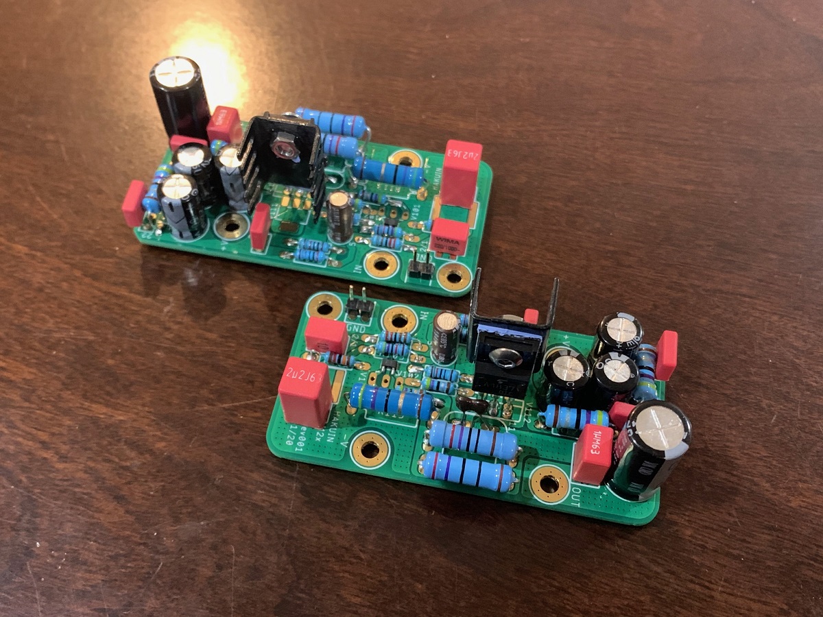

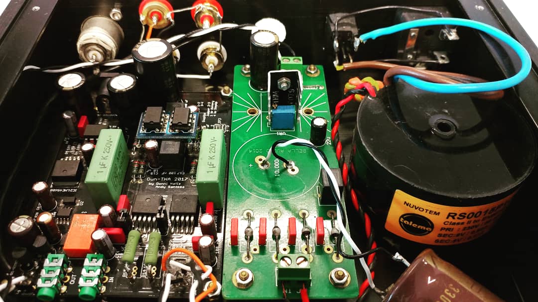

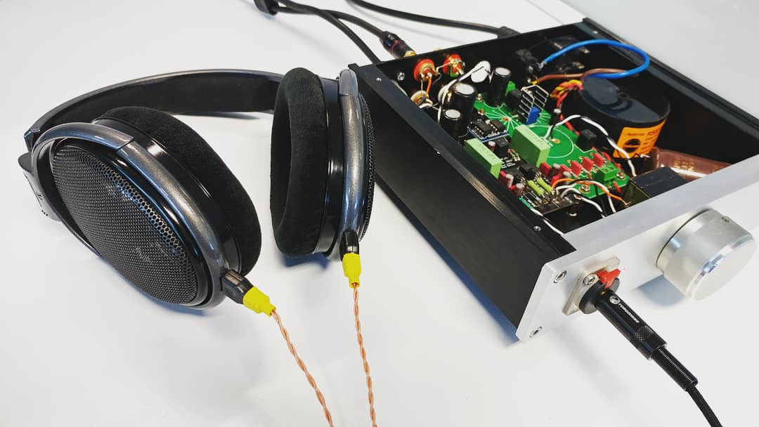

I have been using my HD650 for a year at my office using headamp design based on opamp. if i recall my memory, i thought that i read somewhere that someone plug HD650 to class a amplifier F2J and other user connected it to 300B
i am always tempted to plug my cans to either J2/M2/SIT L'amp that i have but worried if i burn the voice coil
any advice to protect my cans? maybe adding parallel high power resistor?
thanks

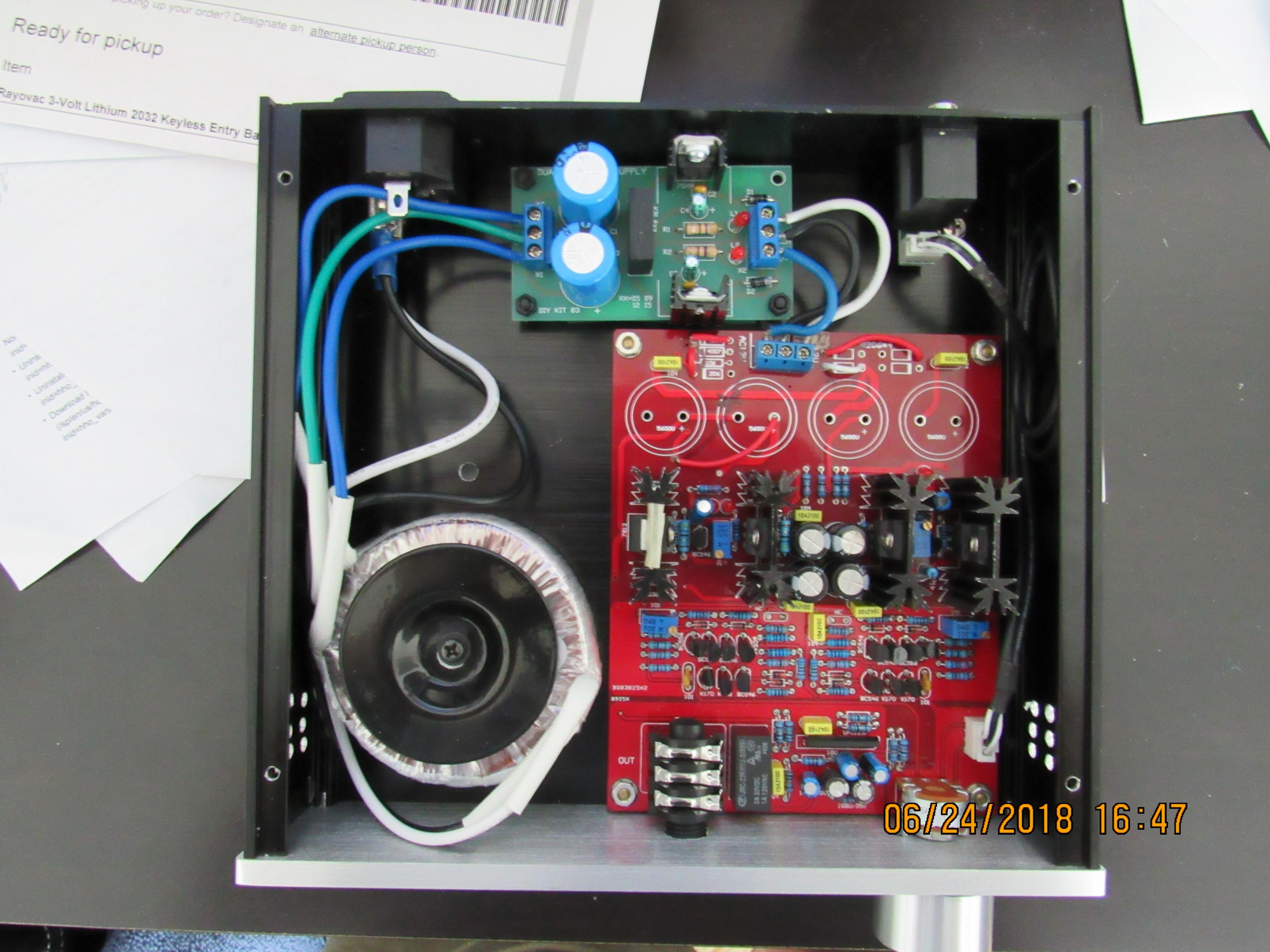

I use a highly modified DIY amplifier described here.
Depth of sound stage and imaging are best with SE Class A amps with zero global feedback. They make a huge difference IMO. No more than two transistors is needed really.
I just finished the Hakuin amp and it sounds magnificent. Better than a MOSFET follower. This is 2SK209BL and 2SA1837 output in CFP.
