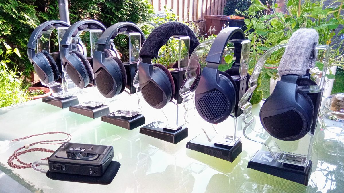

Big Sennheiser fan here too!
My first pair were HD565's bought new back in 1995. Both drivers have since failed and I replaced the cushions a multitude of times but the chassis has survived well and they are now reborn with new HD565 drivers, cushions and a selection of my own hand-made cables and are a very 'fun' headphone to use, especially with Walkmans.
One of the great things about the Sennheiser chassis design philosophy is that they use a lot of common components, especially the driver 'capsules'. To that end I use a hybrid HD565 chassis with HD600 drivers for monitoring duties, another HD565 chassis with HD650 drivers for extended listening periods paired to an Audio-GD DAC/AMP with a balanced cable as well as a few more pairs in the mid-90's HD range.
I compared my hybrid HD565/650 headphones to a 'proper' pair of HD650's and to me at least mine actually sounded better, especially in the low end of the FR. Possibly due to the slightly more enclosed nature of the HD565 capsule enclosure. The overall sound seemed more dynamic and intimate if not as open as with the normal HD650's.

Does it share the same driver shape (or baffle) with the HD600?

Yes, as stated the driver capsules are fully interchangeable between the HD series of that era. Very easy to swap in and fit baffles and cushions but needs a particular technique.That's a collection!

So one of those 565 chassis contains 650 drivers (black headband), 600 drivers (grey headband). The others are refurbished 565's. There is also a 545 in that lineup and I have since acquired a 535.
Afaiac the 565 chassis is the most comfortable headphone ever made, period. I can wear it for hours, possibly even days and not get fatigued 😆
