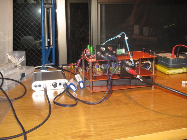

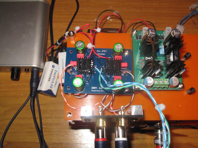

Just because I wanted to be the first to post the built.
I did only the SEN now, in my zen (kinder)garden.
The evaluation setup is done like this:
1)Hiface
2) AD1865 from Quancho board, powered with three sets of four AA batteries.
3) (X)EN
4) O2 headphone amp
5) Audio Technica ATH A900
Today I had the SEN working, I plan by next week to have the CEN working as well. It sound good.
I wanted to have the possibility to swap IV easily, so I am using the best connector for the output of the DAC I had available. It's an expensive LEMO, that I have leftover from some office work.
I have another DAC board connected to a tube output stage I plan to compare. The truth is that I never manage to make up my mind which one I like more, but I enjoy the process 🙂.
Thanks to EUVL, for this interesting opportunity.
