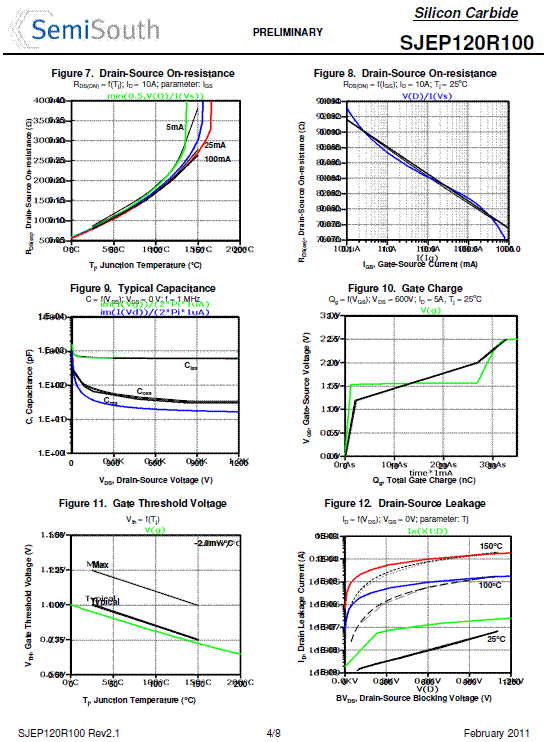

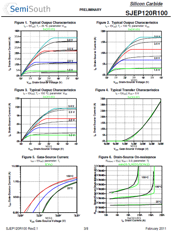

Over on the LTspice yahoo group, analogspiceman just made a very accurate model of the SJEP120R100 for us to enjoy.
  • SemiSouth.zip
hey guys!
I made a model of the depletion SiC-JFET (SJDP120R085)...or at least I tried to. I took the model and the LTspice files of analogspiceman and changed them. The only thing that doesn't want to work properly is the Gate Current (Fig.6) [and I cheated a bit in Fig.10 Typical Capacitance: I think the "0.01uA" from "im(I(Vg))/(2*Pi*0.01uA)" should be "10uA" if I interpret the .plt file of analogspiceman correctly].
Do you have any idea what I'm doing wrong?
  • SJDP120R085.zip
