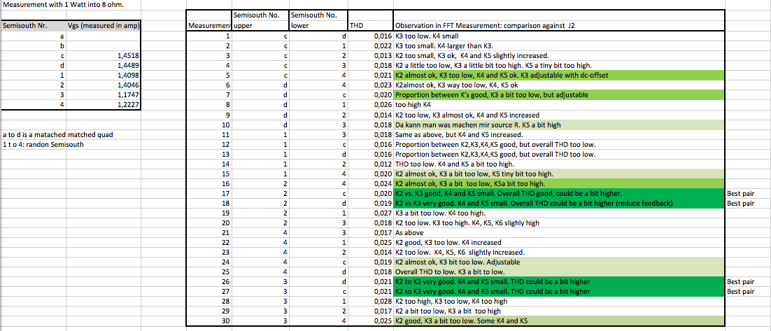

I do have some matched pairs and quads of Semisouth.
But when building my J2-inspired amp, I did not get the results I wanted with the matched ones. Seemed matching for Vgs was not enough....
Out of frustation I took a matched pair and 4 random unmatched Semisouth.
This 6 transistors gave me 6*5 = 30 different combinations for upper and lower half in one F6/J2 channel.
I measured all 30 combinations for THD, 2nd, 3rd, 4th and 5th harmonic distortion.
Those pairs, that gave me the results I wanted, were not the pairs with best matching !
(yes, that is totally stupid approach, but it worked for me 😀)

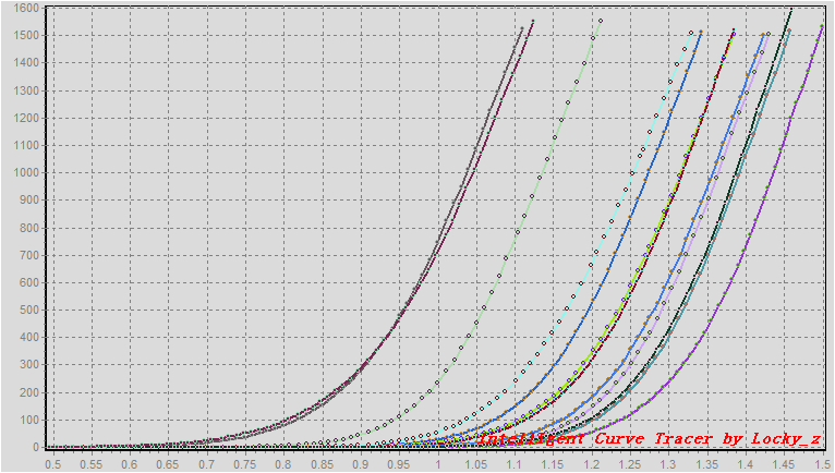

was inspired to get lockys lovely curve tracer and let it at my R100s...
These are from a random tubes bought from SS UK distributor. I bought 17 IIRC and 3 were DOA. These are the rest less two which are in an amp.
Tea-bags were 100As so I havent show them together with the above.
Depending on your standards I think I see between 2 and 4 pairs here....

When you look at the distortion values dsdjoy showed on his J2 try,
you could say, I do not care for the small distortion difference of 0,012-0,028 %. But keep in mind that the distortion spectra concerning K2 and k3 was very different and that we were looking for the unique sound Nelson 😎 J2 had, so we were searching in the bits.......🙂
But some bits we never found.... AAAARG! 😀
