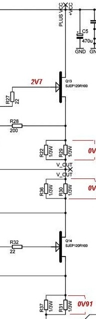

Hm...confused...All gate resistors are 100 Ohms. Measured voltage in idle mode is 300 mV over one gate resistor and 6 mV over the other. Measured on both channels - the same situation - One 300mV, other 6mV. 😕
which one 0V3 , which one 6mV ?
V over R32 – 300mV
V over R27 – 6 mV
Thanks for the info. As I suspected looking in the datasheets, power JFETs of Semisouth have peculiar behavior at ‘low’ currents (remember they are primarily designed for high current switching). So at low Vgs (1-1.5V) the gate current is not negligible.
Even more strange is that Ig decreases when Vgs rises, meaning dynamic impedance of the gate is negative. Only at much higher currents Ig starts to rise again and is several tens of mA when Id reaches about 20A (Can’t help recalling Papa’s words that new devices require new approach to get best of it).
I think difference in Ig between devices you’ve measured can be explained with variations of parameters of individual devices and/or difference in operating point as small variations in Vgs can result in significant variations of Ig.
Even more strange is that Ig decreases when Vgs rises, meaning dynamic impedance of the gate is negative. Only at much higher currents Ig starts to rise and is several tens of mA when Id reaches about 20A (Can’t help recalling Papa’s words that new devices require new approach to get best of it).
I think difference in Ig between devices you’ve measured can be explained with variations of device parameters and/or difference in operating point as small variations in Vgs can result in significant variations of Ig.
Even more strange is that Ig decreases when Vgs rises, meaning dynamic impedance of the gate is negative. Only at much higher currents Ig starts to rise again and is several tens of mA when Id reaches about 20A.
That's interesting. I have tested a lot of R100's and I have
not seen this phenomenon.
Tested at Vds=10v at 1 amp the Gate current is positive
into the Gate (that is to say electrons are flowing from the
Gate). The value ranges from less than 1 uA to as high as
30 uA, typically less than 10 uA. The current is
proportional to the Ids and to the Vds. It increases slightly
with temperature. There is no indication of negative
resistance.
