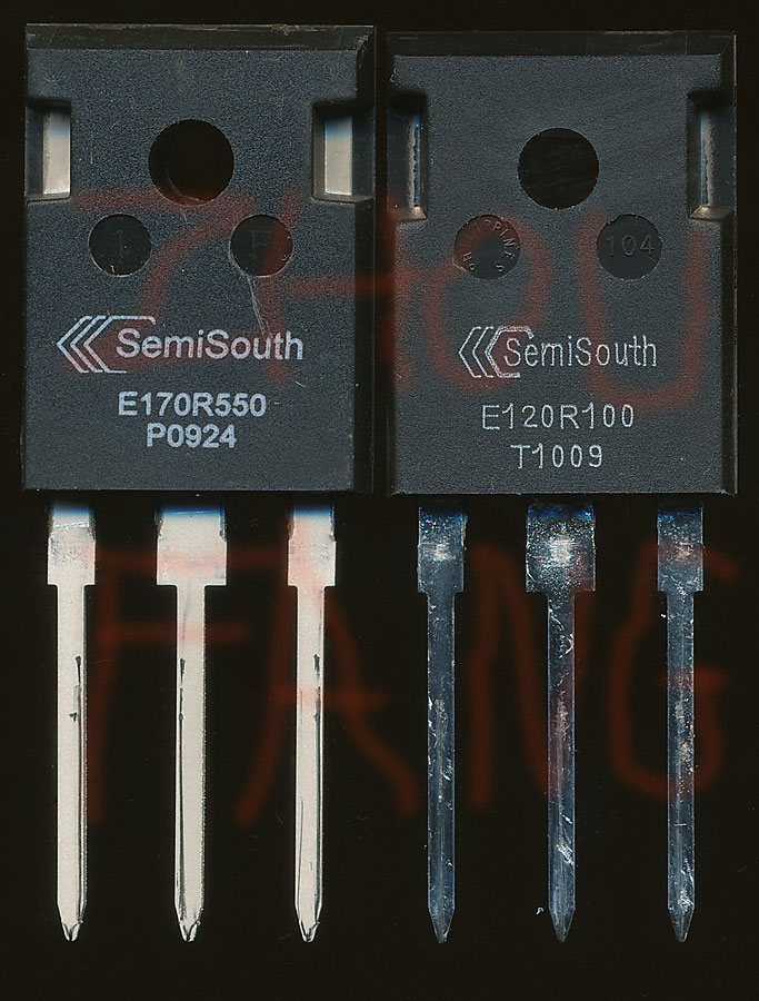

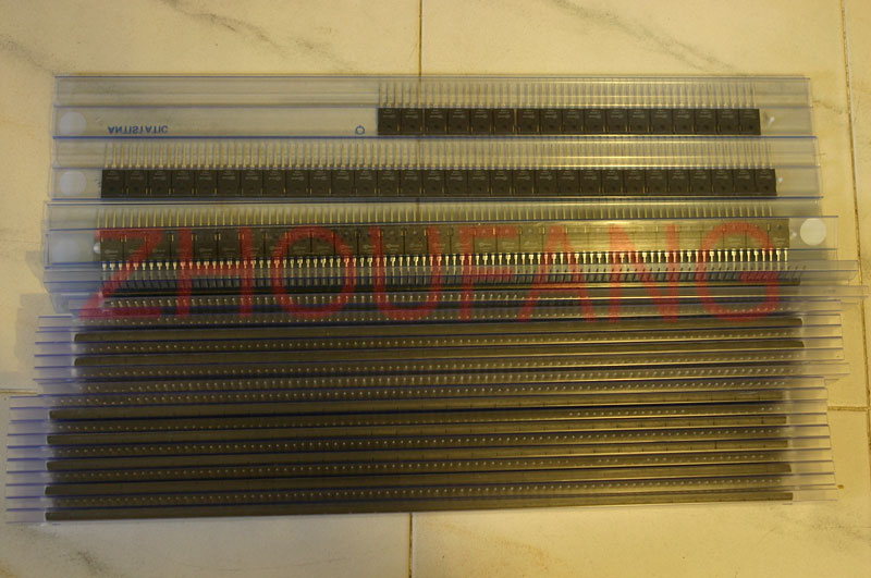

SJEP170R550 - new 1700V part with lower capacitance, lower transconductance, lower power dissipation.
Price: $20/ea for the first 4 pcs, $17/ea for the 5th to 8th pcs, $16/ea from the 9th pcs onward
SJEP120R100 - the original part used in FirstWatt J2.
Price: $29/ea for the first 4 pcs, $26/ea for the 5th to 8th pcs, $25/ea from the 9th pcs onward
