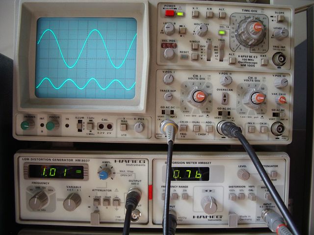

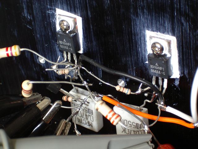

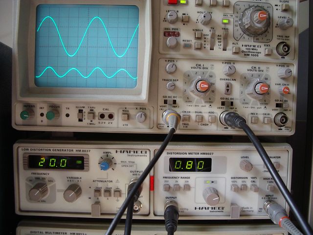

RF devices are good because the nonlinear capacitances are much smaller, so their contribution to distortion at 20kHz is much less. For example, here is a test setup with 2x RD16HHF1, Zen Classic, 30V/2A, 1W/8ohm, measured at 1kHz and 20kHz. While at 1kHz the RD16HHF1 measures very similar to the original, the distortion at 20kHz is essentially unchanged - big improvement.
This is really great, the Zen design is probably the most pathologic case for Crss induced distortion, because Crss lies there parallel to the feedback resistor.
Using an ordinary VMOS or a Power-J-FET provokes Phase Intermodulation Distortion in the range of a microsecond or so.
Nobody would ever like to listen to digital Audio with a Jitter of 1us at 20kHz.
PIM and Jitter have the same mechanisms behind of them and sound very similar ...
Let me guess, the RD16HHF1-Version sounds more open, less blurry, much wider and deeper in sound stage etc., even when the 1 kHz THD is not (much) better ...
