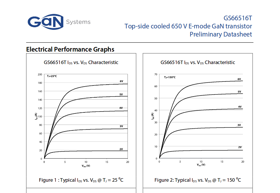

I have been eyeballing these for some time now:
http://www.mouser.se/pdfdocs/PreliminaryTO220GANDatasheetPGA26C09DV.pdf
Gallium Nitride semiconductors seem to have huge amounts of transconductance for very low amounts of gate capacitance. Every transfer-curve I have seen is shows a very high tranconductance and linear device.
http://www.mouser.com/ds/2/692/GS66516T%20DS%20Rev%20160318-913407.pdf
I am very tempted to buy a few of these and clamp them to a solid block of copper, to see what can be done with these small surface-mount parts.
They have quite spectacular electrical properties.
