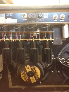

My partner Jim continues to improve the solid-state "tube" based on the SJDP120R085 SemiSouth SiC JFET. Here's an image with a full set of four installed in his Fender Twin guitar amp. Accomplished musicians that have played the amp with the latest version of the "tube" say it sounds amazing.
We are working up new data and a studio quality demo tape. More soon!

Thanks for the update. I'm very interested to hear the result of your work. Will the audio file(s) be downloadable do you think?
The amp really looks cool fully equipped with your SiCfet creation!

To build something like this for my bass, I'd need 400W bare minimum. Is this design easily scalable up to 400W?

Looking forward to hearing it. Will there be an A/B with real 6L6's in the same amp with the same guitar?
