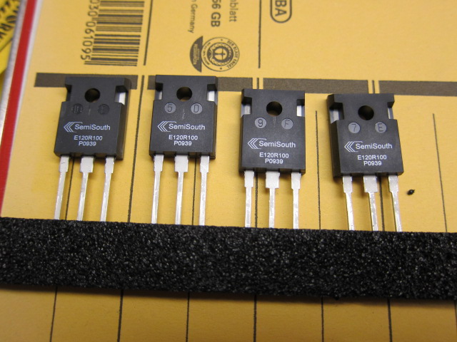

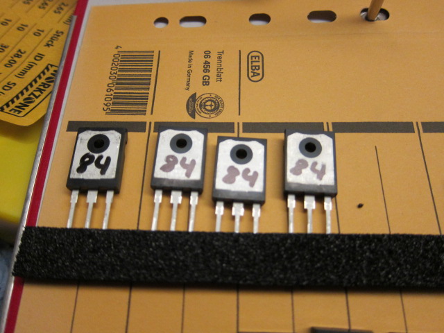

Matched Quad of SS R100 for sale
the matched quad is from a group buy of tea-bag.
I do not have the time for building an amp with
Not used and stored in static foam
Diy'er with interest , please send me a pm.
Regards Sam
Regards Sam
