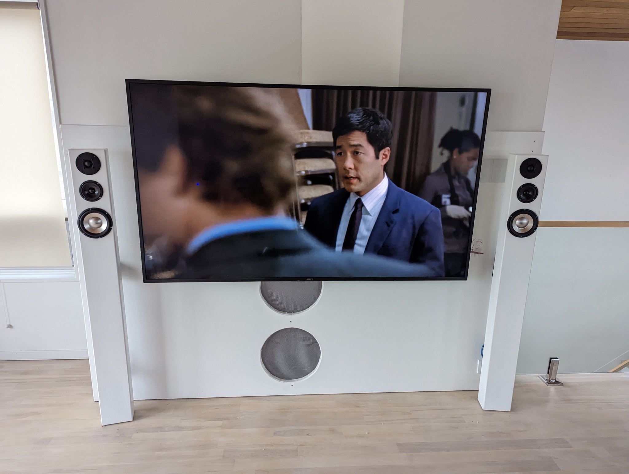

Finally finished my speakers. Diy open baffle subwoofer with 2x Eminence Beta 5, 8Ohm in series on a 1.5x1.5m semi open baffle. Two 3 way satellite tall slim speakers. Minidsp, 2xICEPower125asx2, Behringer A800. First i was building the lxmini with the speaker drivers but I was not happy with the sound result for my beloved music, so i switched back to closed speaker for the satellites crossed over at 80hz. Woofer 80-1lHz, midrange 1-3kHz, tweeter 3kHz and up. The built video is here:

How come you didn't flush mount the drivers. It really makes a big difference for tweeters, but also a positive effect on midrange and woofers too.
I admit visually it might look better but without CNC it decided to simply mount it from the front. All drivers are working in their omnidirectional Frequency range except the highest frequencies, so no diffraction is expected at the 150mm (half=75mm=>4kHz) wide speaker front. The tweeter has is own flushed faceplate with a diameter of 100mm .
With omnidirectional I meant in the front of the speaker... So no beaming.
