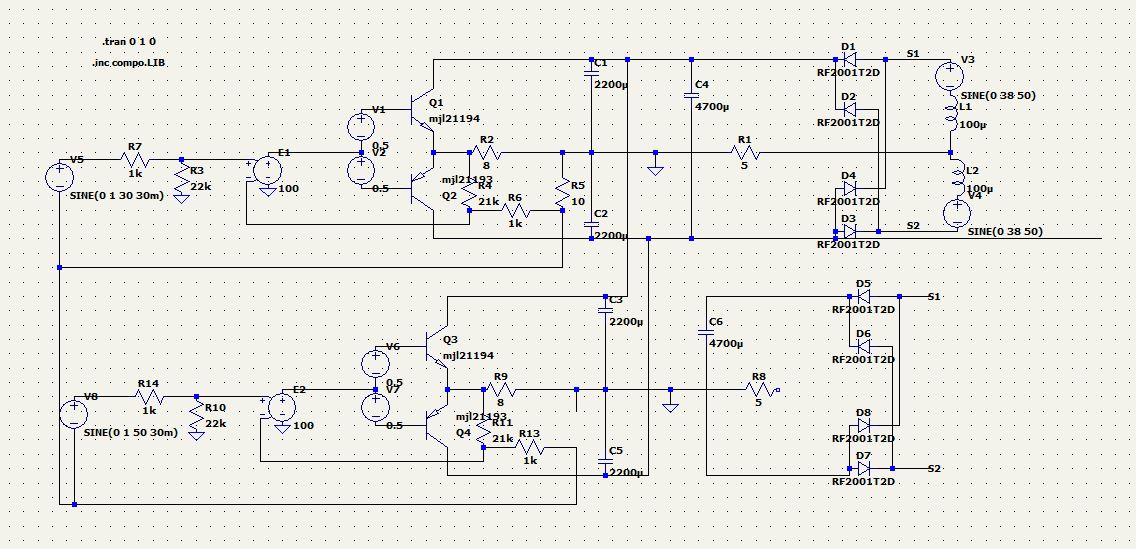

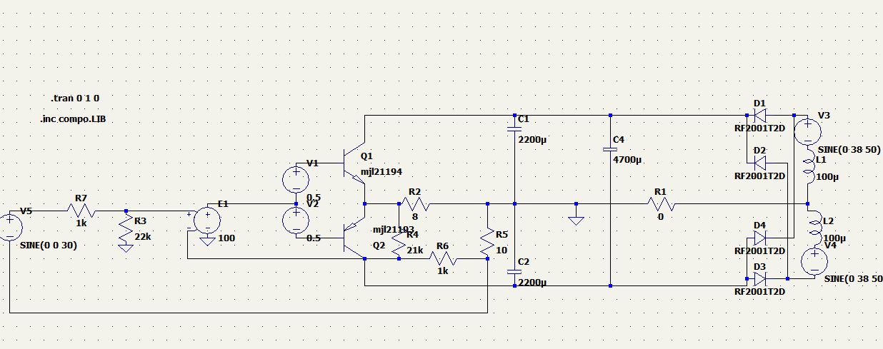

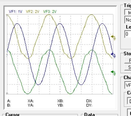

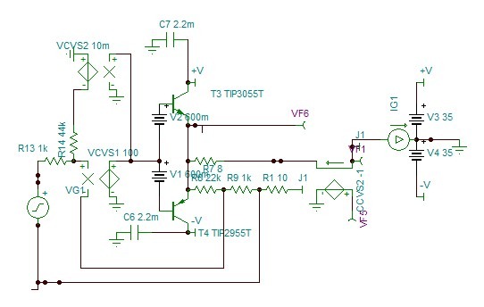

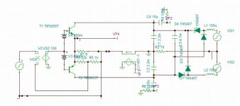

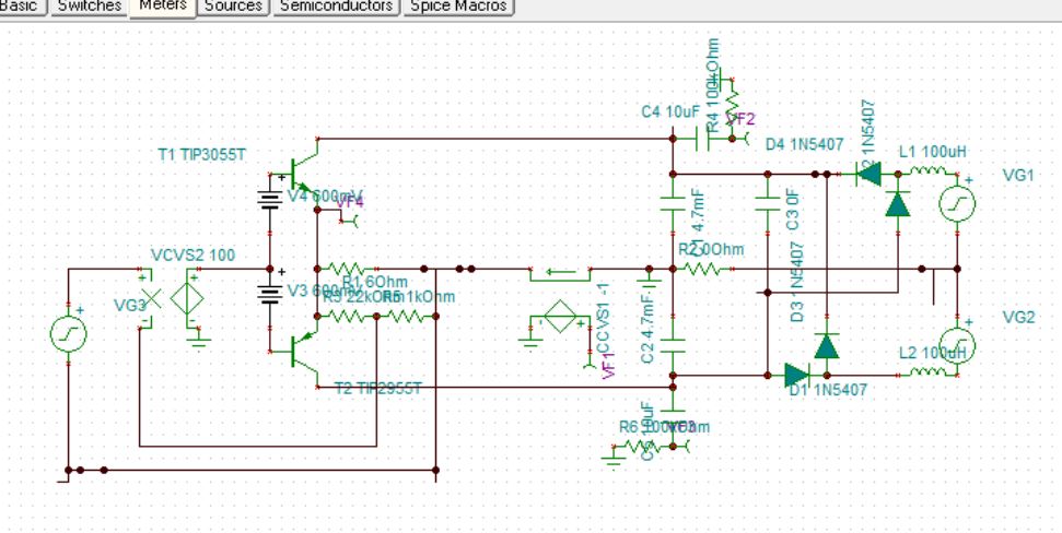

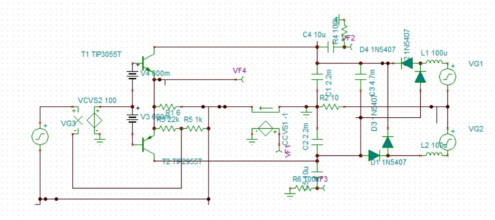

Shouldn't your "using equivalent capacitor" for C3 in the semi-floating PS be 1.25mF?
My reasoning: C1 and C2 in the standard PS are 4.7mF -- become 2.2mF in the semi-floating PS. You are removing 2.5mF from each. So put 2x2.5mF in series in the semi-floating PS for C3. That's 1.25mF as one capacitor for C3.
I reduced the capacitor but adding a common on of 4.7mF. The total In first case is 9.4mF and the total in floating Case 8.9.F. on the other hand the voltages are different as the common 4.7mF is twice the size. What to note that the 10 ohm resistor and the rail capacitors make a low pass filter reducing the 100Hz component and at steady state, not transient, when the output is at its max, the supply is at its nominal instead of minimal in standard.

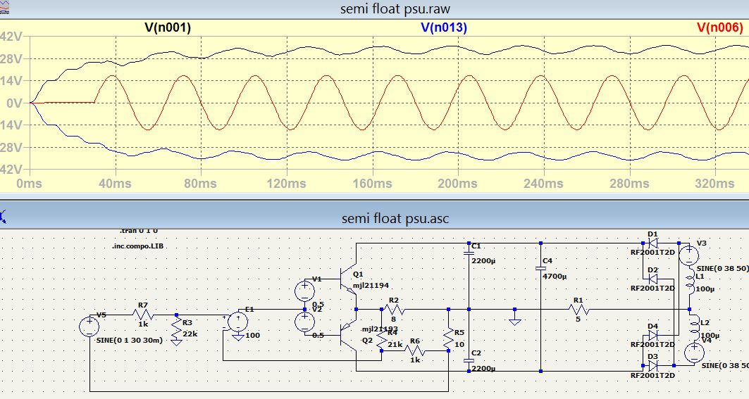

Some additional ideas:
-use a signal having a non-harmonically related frequency wrt. mains, for example 21Hz
-test the dual autonomous supplies case: each having it own winding, rectifier bridge and filter cap
-measure the winding current, rms and waveform for all situations

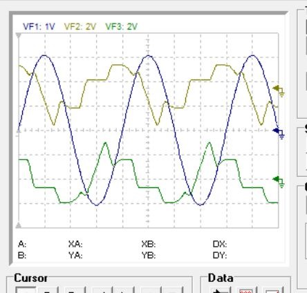

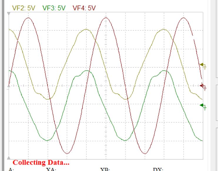

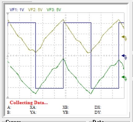

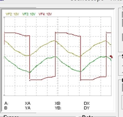

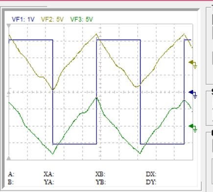

Try a 21Hz square wave signal, same capacitor values for both circuits, and take to the point of clipping to see where that is in each case. Present all the waveforms on the same voltage scale relative to the same ground as that's going to show the problem of the extra droop. If your simulation allows, what happens if you make R10 negative 10 ohms? Could that be physically realized somehow?

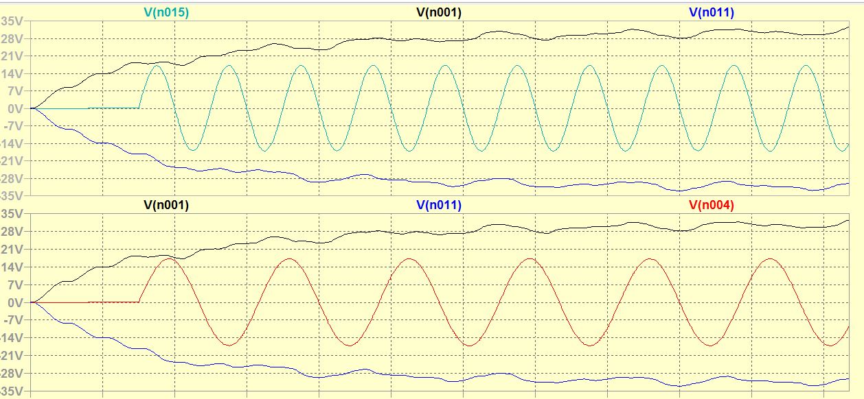

I did simulation with 21Hz square wave with 2.2mF on rails and 4.7mF C3 mutual. As there is a beat, I captured the min. and max.
I increased the output to let it starve showing the output voltage instead of current with floating and standard 4.7mF rails.
The resistance 10 ohms or 3 ohms doesn't change mutch.
The real reason I am dealing with floating supply is lack of bass in split supply.
I realized first from single supply of bridged amp bass performance compared to split supplied single with LM3886 which is notorious to lack deep bass. By using a full floating supply which is called floating ground, the same circuit got the bass frequencies resuscitated. I thought then to have invented it, but not, Onkyo had produced high end amps using it with a pair of diodes linking the ground to the central point of the secondaries to limit the voltage of rail capacitors. Minek showed an old Russian design of late 80's using such supply. The problem with floating supply, each channel needs its own, whereas here as low frequencies are common for both channel the crosstalk is not a big problem.
About a year ago, I wanted to try the Chinese TDA2050-LM1875 chips, they have the same chip, to my surprise it is a new design with unity gain stable. I first tried it with two 24v SMPS, sounded full bass. When I made it with floating supply using single 48v, it didn't get any better. I tried the same circuit with the Shanxin TDA7294, with two SMPS, dried out bass. I bought dual +/-36 SMPS , in vain, the same result but better with floating.
What if the positive input, referenced to ground is the one that is making the amp positive feedback, so with the same dual supply , I let the positive input referenced to virtual ground made just by two resistors from the rails, by passed to eliminate only high frequencies. The bass came back as could with floating supply. If virtual ground can be used with SMPS, it cannot with linear type as the ripples that aren't always symmetrical, enter the input to be amplified. This is why the real reason of semi floating supply.

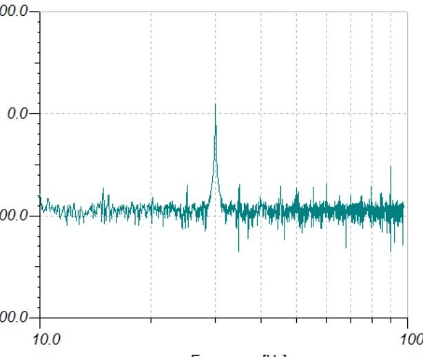

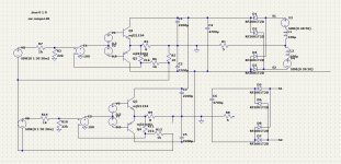

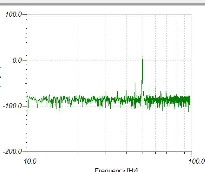

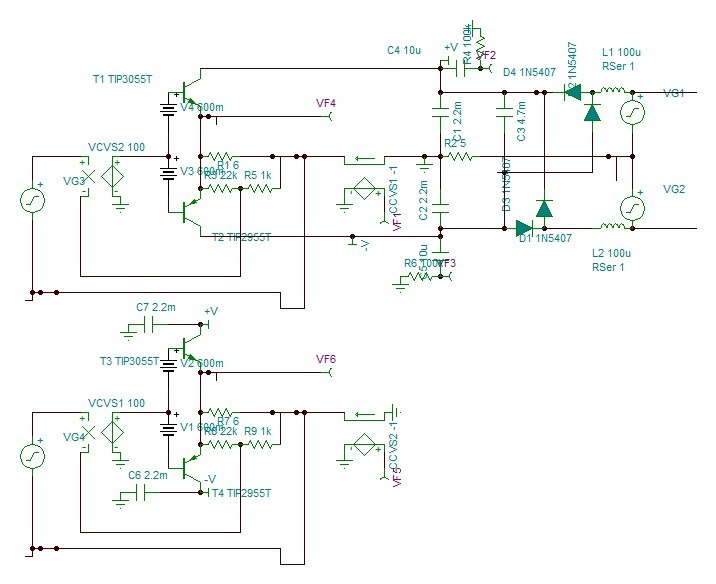

The question here is, does each channel needs its own bridge rectifier, and 3 capacitors ?

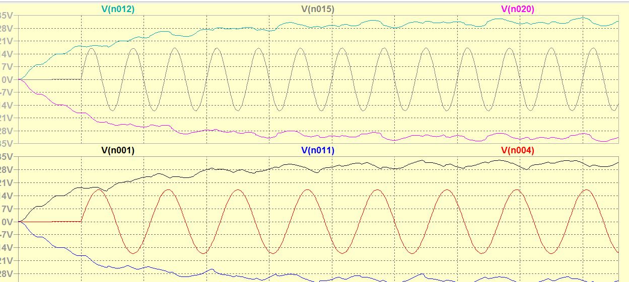

I simulated 2 channels one 30hz other 50hz with each rail capacitors, it looks on the spectrum, the crosstalk can be acceptable.
On steady state, the semi floating provides higher voltage than the standard. The loss due to resistor occurs in infra sonic to DC region that allows you to add a fuse and protect the loudspeaker in case of amplifier damage. This saves speaker protection circuit but in expense of double voltage rating of rail capacitors.What's the max output voltage with semi-floating PS vs standard PS? What's the power loss on R2 in case of semi-floating PS?
