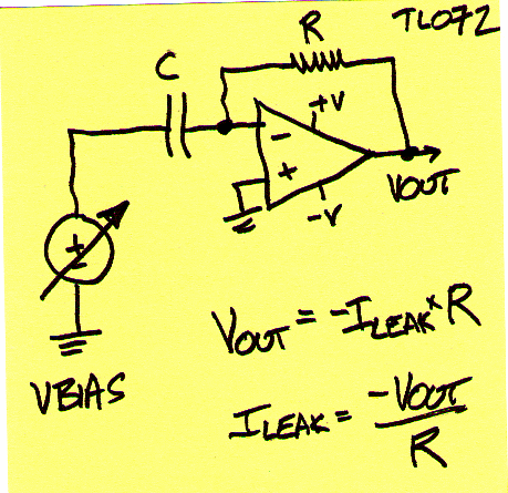

I'll bet if you measure the leakage of the 470uF nonpolar electrolytics that you haven't yet stuffed and soldered, you'll find it's waaaay less than 0.1 microamps.
Easiest way to do so is to haphazardly slap together a transresistance amplifier made from a low Ibias opamp, namely an FET opamp, on your solderless protoboard. This lets you try any and every bias voltage you might wish. 15 minutes of your life.
Pick the transresistance R=1Meg ; or if you are feeling timid, R=100K.

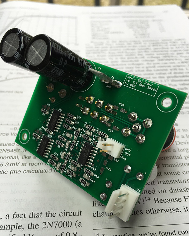

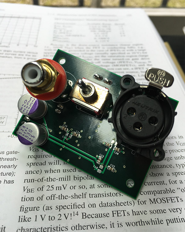

It seems that the second manufactured version (ver 2.4) referenced in post 111 has passed "ASTX certification" with flying colours. Toni mentioned to me by email:
PS: I have a few spare PCBs which I can make available at my cost
I get noise down to -132dB A weighted referred to 4 Vrms RCA input - my measurement limits.

The 40 ver 2.4 PCBs (10 panels of 4 boards each) I had produced cost me £6 each once I factor in the cost of production, shipping, duties and the first draft which was binned after it performed badly in testing.
I will therefore offer them at this price per board (plus P+P which will obviously depend on where the recipient lives).
I'd also like to say a big round of thanks to Toni. He conducting tests on both the first and second version boards. After a discussion regarding typology he pushed me to redo the routing, use the larger resistors and fix the supply bypassing. He also pointed out that I had the toggle switch back to front! (It didn't occur to me that a toggle switch wouldn't activate the pins the toggle was pointing to...)
So anyone who uses these boards owes Toni a big thank you also!
I've been doing further testing of this board. One thing which came out of my attempts to measure its noise is that it needs a minimum load. It doesn't need much of a load - I tested a 10k resistor across the output and all seemed fine - but I would recommend that R28 be populated with, say, circa 2k resistor assuming R27 is jumpered/shorted. (See post 111 for circuit.) If anyone uses a voltage divider on the output the resistor values will need to be recalculated. 2k is easily driven.

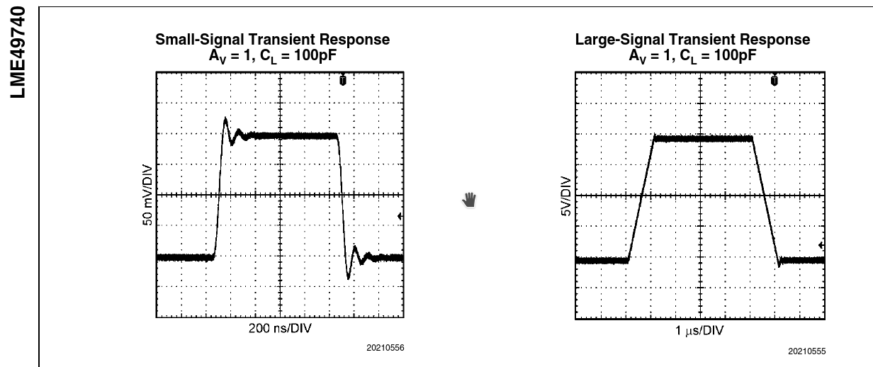

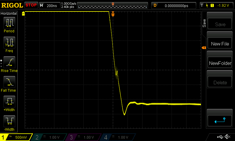

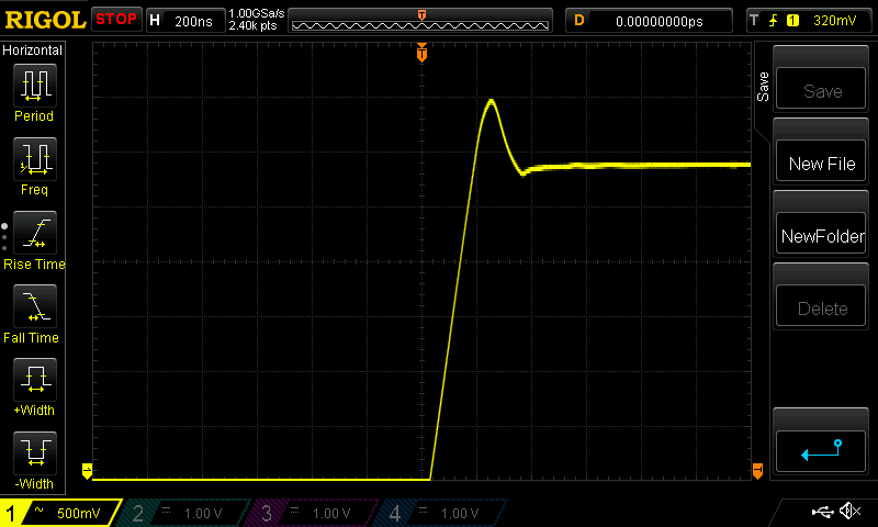

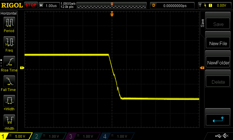

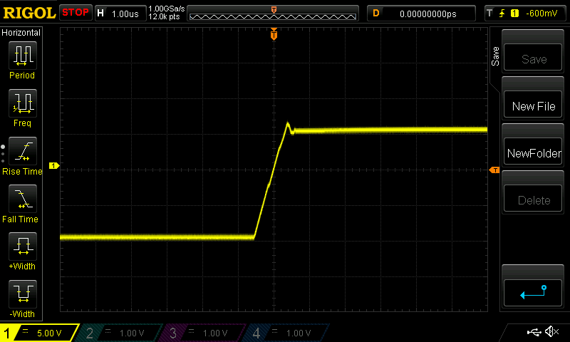

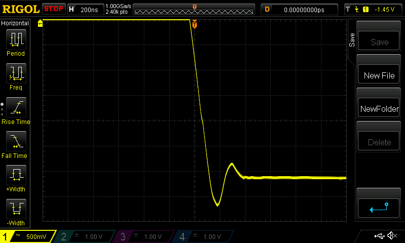

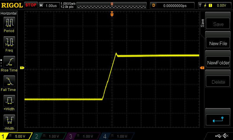

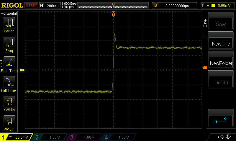

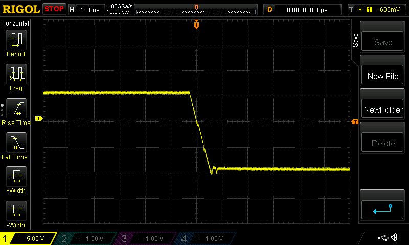

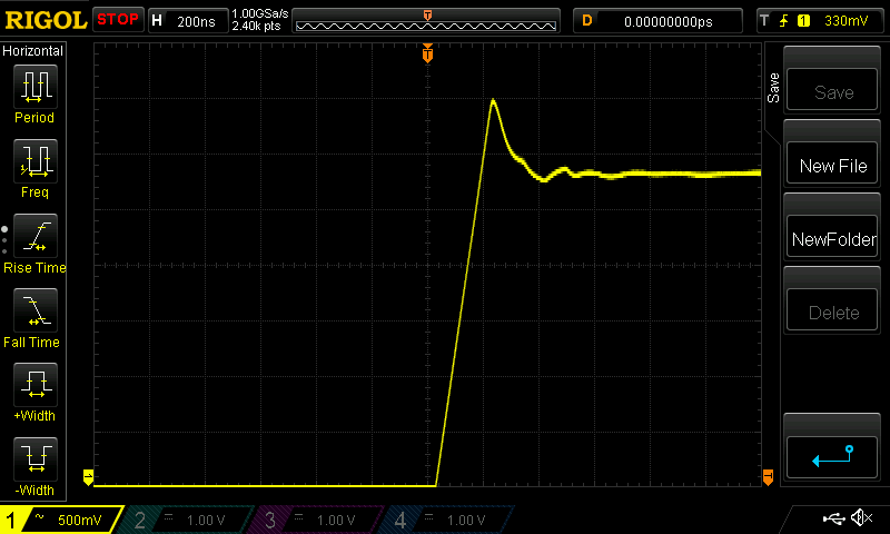

I have also looked a little more at whether the 27p caps can be removed. Attached pic 1 shows a transient reaction to a 150mVpp with the caps removed. The 'no cap' waveform is still better than that shown in the data sheet (pic 3). Pic 2 is with the 27p caps in place - the overshoot is gone. I also tested larger transients. Pic 4 and 5 are 15Vpp transient response with caps and pics 6 and 7 is the same but without the caps. The caps dampen any ringing but there's no sign of instability without them. Removing the caps seemed to lower noise but I am still refining my test setup for this - at the moment it is still too variable for this type of work to reliably distinguish between, say, -113dBu and -115dBu as a result of board changes.
I'd welcome thoughts on this.
No thoughts on whether the caps are necessary/ideal?
The extra noise without caps sound logical; without the caps, the noise gain goes up with frequency, and can ultimately lead to instability.
It *may* be OK in your setup without, but you want to be sure it is fine in all different setups, so I believe it is prudent to include the cap. The datasheet value always is to make sure it is stable worst case, also with the spread in opamp production.
But maybe 15p is also sufficient. Have you checked it with lower cap values?
Jan
Hi. It appeared to me that there was lower noise without the caps, but then again my test setup isn't reliably fine enough to distinguish between one or two dBu. That would seem to make sense given less components are in the signal path. I have not checked lower values. I did check 47p.

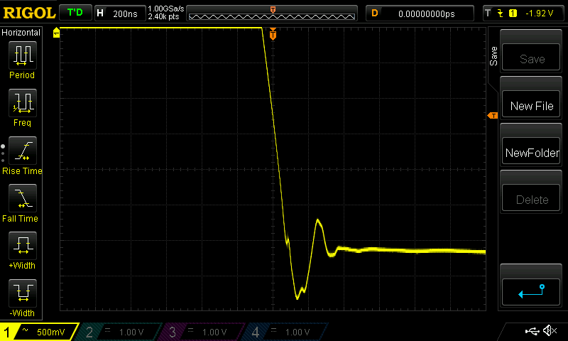

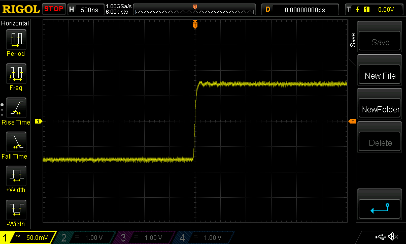

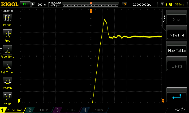

Attached are some pics zooming in on the output waveform from a 10Vpp square wave (much, much bigger than anything this input board would ever have to suffer).
First two are with 27p caps. Second two are without caps. Pics 5 and 6 are with 47p caps. I thought the difference between pic 1 (27p trailing edge) and 5 (47p trailing edge) surprising.
My original implementation of 27p was a rather thoughtless copy of what Self did in Fig 18.9 of Small Signal Audio Design (2nd ed.). But I note now that he was using 27p in conjunction with 10k resistors, leading to a -3dB point of 589kHz. Here, with much lower resistor values, the -3dB point with 27p is way up at 7.2 MHz.
