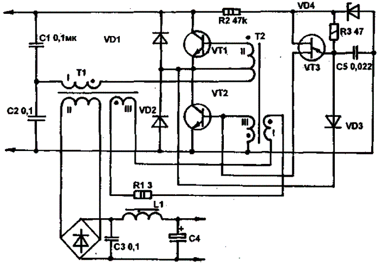

Self-oscillating SMPS with saturable drive transformer
Does someone neve an experiense with such topology?
I have designed such supplies for up to 200W , but now I need 500W to 1kW... It should not be stabilized, but simple and cheap...
I'm especcially interesting in current-proportional-drive in this SMPS (I didn't use it in 100-200W designs ) and reliability in this mode.
Does someone have proved (or not so-proved🙂 ) designs of this topogy? Thank You all.

Hi there......A well designed high power switch-mode psu should exhibit s/c ; o/v protection amongst a host of other things.
On low power designs the self oscillatory mode or (gain limited switching) is capable of higher o/p currents than a flyback.
Drawbacks (serious).....Core driven to saturation, for high frequency operation, a square loop low loss ferrite is used...however may not always start with extreme squareness ...critical material selection; good Fe material selection can result in poor switching performance.... high loss and low effic.
Primary side switching stress is high........semi's rated for 2x bulk Vin DC.......
Result.....limited to low Pout applications.
Personally (sorry) I would put cold water on this idea!

But this is not just an idea - I have built such supplies and successfully used them for powering 2x90W audio amplifiers, it worked just excellent. I was too young to measure all it paramerers as I plan now 🙂, but as I remember at 180W (+/-35v) it had about 10% rippel @100hz and about 4% @30kHz, output impedance was ~0.6-0.8Ohm - all parameters are comparable with "classic" 50/60Hz PS designs. I didn't measured efficiency, but no parts were hot above 60C.
Now I need simple and cheap PS and I think "to restore" my old design, but I'm not sure that it can be simple forced from 200 to more than 500W by transformers enlarging... I think proportional-drive should be used, but I have never dealed with it...
About "a host of other things" in good PS - this simple design has a lot of hidden things - it hasn't overvoltage problem, it does have overcurrent protection and magnetic loop autobalance etc.
I'm thinking about more modern designs too (like IR2153 + IRFxxx), but this design is also is an option, and not worst option to my opinion. It's very old topolgy , of course, so what ?
I've used proportional drive for more tan 1Kw output with bipolar transistors in a full bridge configuration. It works reliably and outperforms MOSFETs in efficiency at low frequencies ~30Khz, but it requires a control IC in order to provide a stable oscillator and active turn-off
In proportional drive circuits the Volts*Second product applied to the pulse transformer is usually proportional to the load current so saturable reactors are not practical
Eva - it's not exactly: Volts*Second product applied to the pulse transformer depends only of Volts applied to transformer and Seconds that it's applied. The voltage applied to drive transformer is always = Base-Emitter voltage of saturated transistor, and it doesn't depend of how we obtain it - from voltage feedback or proportional current feedback. It more or less stable (about 1V at deep saturation). Off course, with proportional drive base current is not constant, but Vbe changes will be not more than 10%.
Only the problem I see in this mode - with proportional drive we can lose "built-in" current limit - with voltage only FB, base current is limited, so collector current is limited too, when overcurrent occures - power transistors just exits from saturation to active mode, it's very hard mode for transistors, but no problem to stand in this mode couple of milliseconds until protection fuse will blow. With proportional drive power transistors will kept opened and saturated in overcurrent mode, so no current limit in this mode. A possible solution is to minimize proportional drive and prevent keeping power tr-rs be saturated (if for example hfe of tr-rs is about 10, so proportional drive current ratio should be less than 1/20 - only a half of required base current will obtained from the collector current), so it will not enough to keep tr-r saturated due to high output current, but on-off behavior will improved. But it's ony my theoretical ideas and should be tested.

Dem: Hi! I tend to agree with Rich on this one, at the power levels you require. And if you have to employ 'add-on' control electronics to get it to work properly, you might as well go for a more conventional topology suited to the 500W-1000W range: If fed from 300-400VDC, half bridge or full bridge is typical. If fed from battery supply for car stereo applications, push-pull is popular.
Whatever you choose: Design in some cycle-by cycle current limit mechanism, preferably with latching shutdown if the overload is sustained. When 1000W goes BANG 😱 right under your nose it's not nice.
Rich: I stand corrected, but is the design posted by Dem not what is called a Royer oscillator? I remember similar circuits being popular in 1970's capacitor discharge ignition system designs, like the Practical Electronics Scorpio. Also in inverters for fluorescent lights and other stuff 100-200W.

You are right - this is so-called Jensen variation of Royer oscillator, and it really great for up to 100-200W.

50~100W is not a problem for such SMPS, but typical electronic ballast / halogen electronic transformers use pure current-feedback with proportional-drive, and it has 2 disadvantages:
1. It stops to work at no-load or very light load;
2. It continues to work under shorted load.
It doesn't matter when load is more or less stable (electronic ballast / halogen ) but for audio (It's DIYaudio forum, isn't it? 🙂 ) 50~100W I suggest You voltage-feedback, up to 200W it should be OK to my opinion.

Proportional drive requires a proportional negative base current of about Ic/2 for optimum turn-off. This is achieved by inserting some components between the drive transformer and the base pin, and as a side effect, the volts*second product seen by the pulse transformer is no longer constant but proportional to Ic

I don't have deep knowlege or experience with royer/Jensen oscillators , that's why I started this thread - to look for people who knows more...
But I know that the problem of current-feedback driving self-oscillator is when magnetizing current is greater then load-reflected current, in other words - at light load.
If You reduce the primary inductance, You increase magnetizing current, so as I understand it, it will even worse. In addition, lower primary inductance increases max flux density towards saturation point, but You want be sure that driver tr-r will saturated before the output tr-r, so I always kept high inductance and low B at primary.
But for Your power level, voltage FB is good enough to my opinion.
