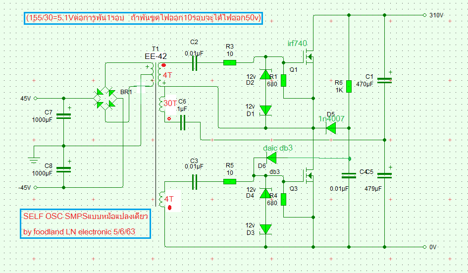

this circuit use ee-42 pimary 30t and gate dri 4t
