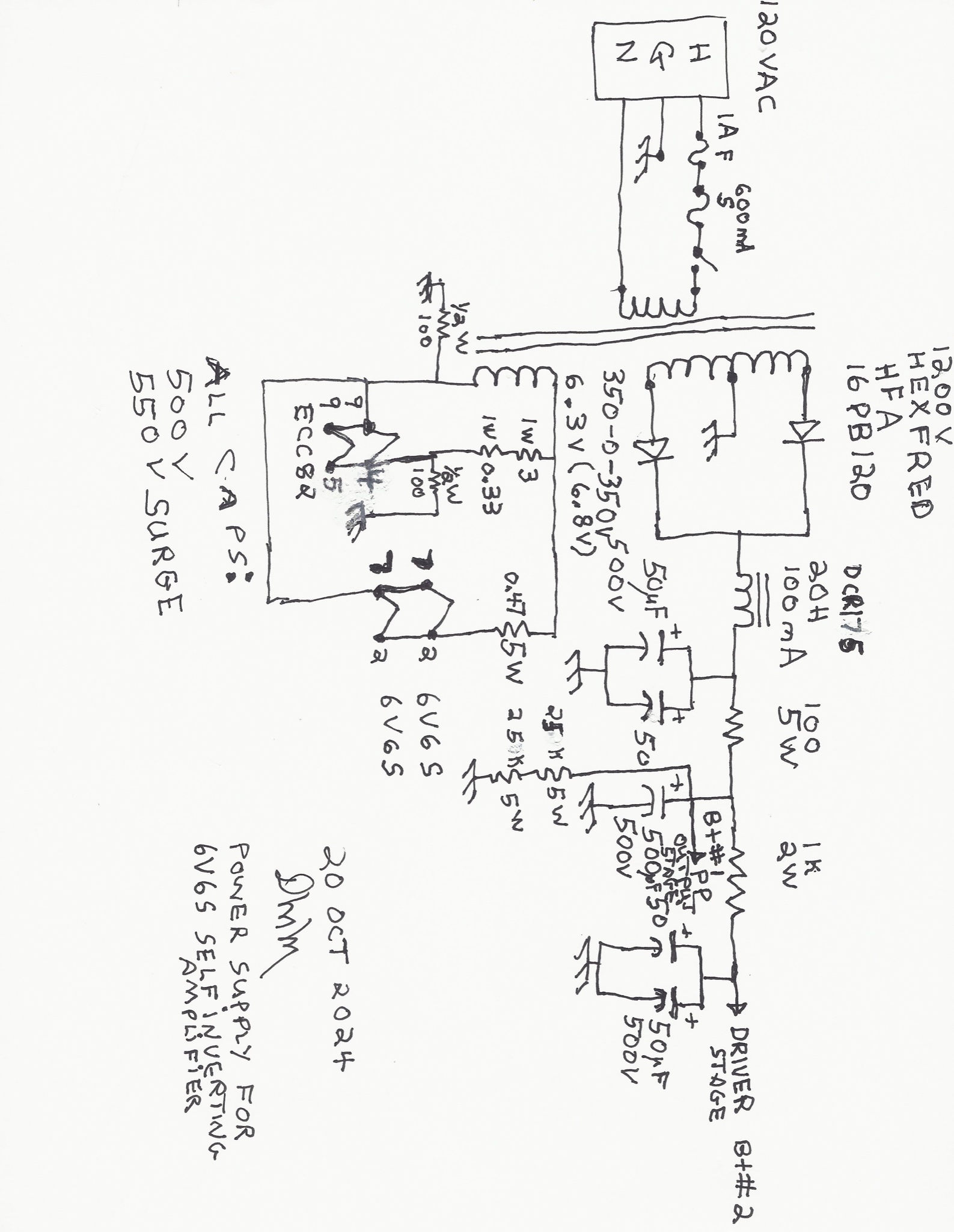

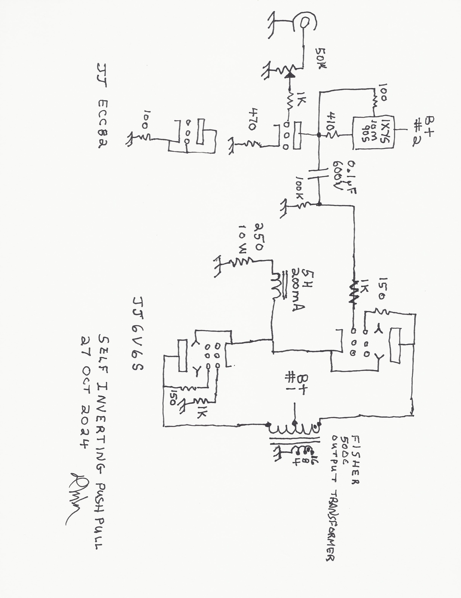

I designed and built this low power amplifier to drive an Usher S-520 two way speaker at my computer desk (near field, 2 feet speaker-to-ear).
With the bottom plate back on today, I am enjoying listening to a Kenny G Duotones CD.
I am attaching the following:
1 Amplifier Schematic
1 Power Supply Schematic
(Sorry for the sideways view, print them and rotate them; or play with software rotations and re-sizing).

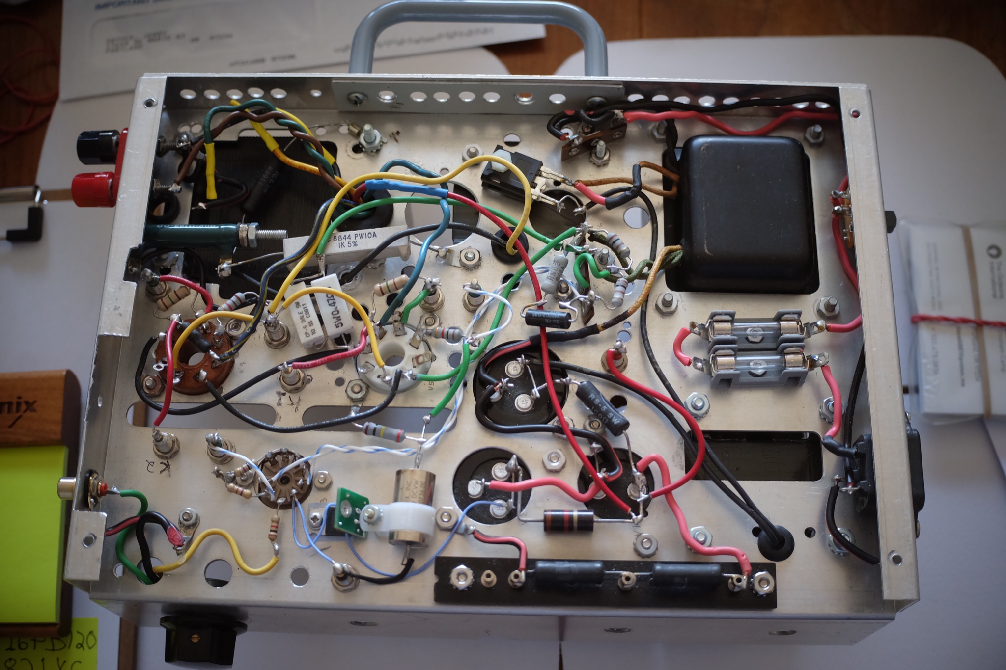

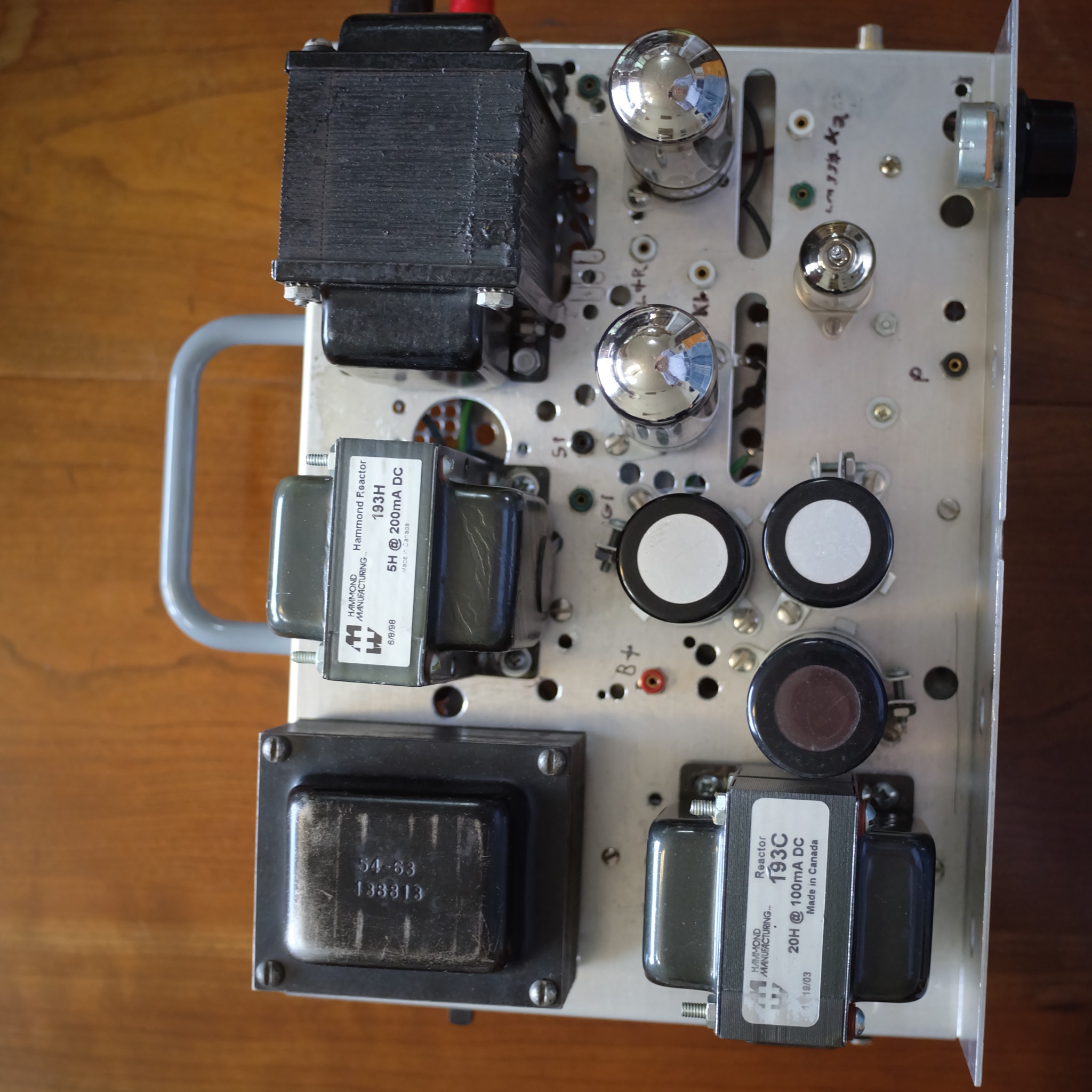

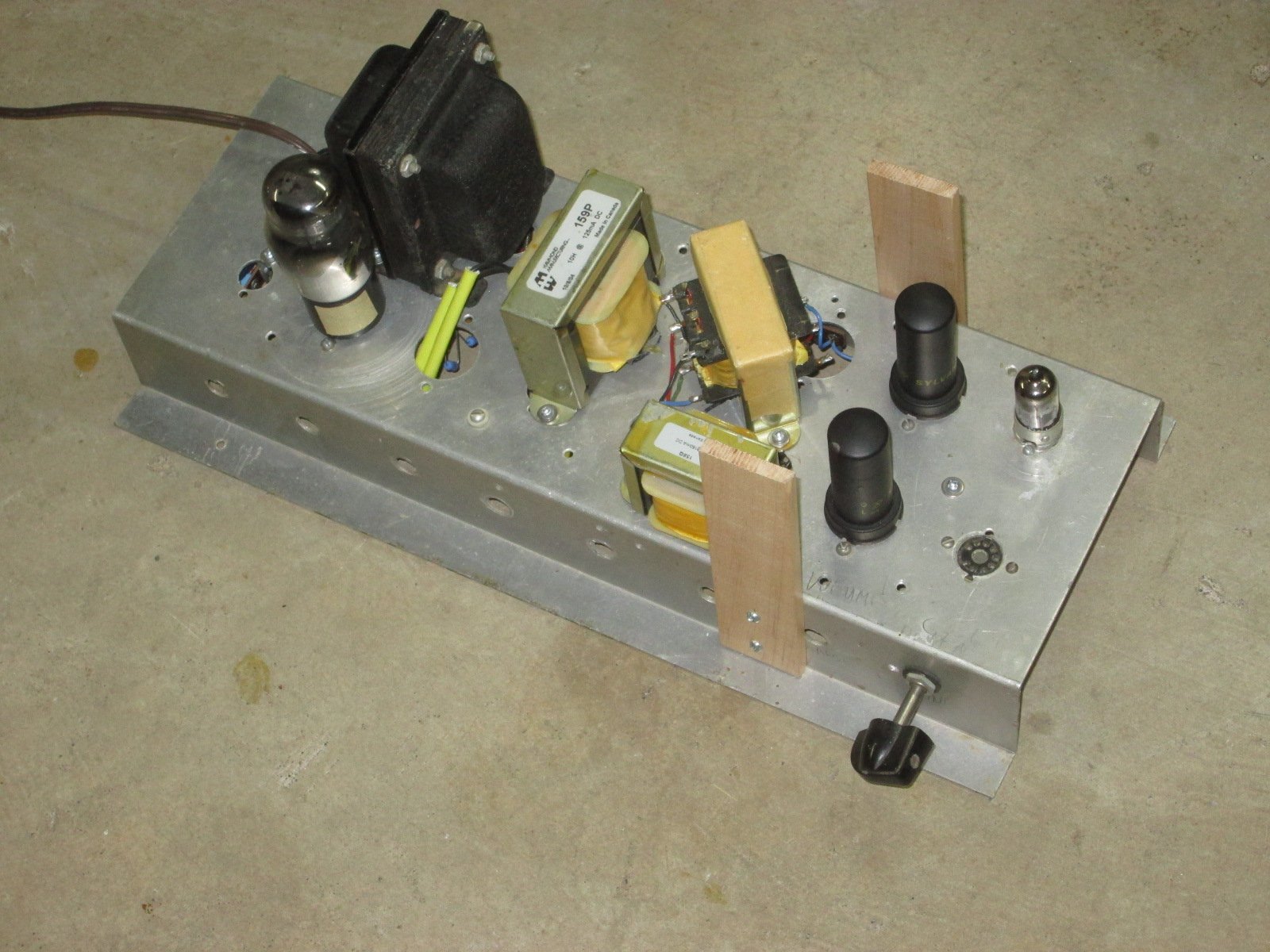

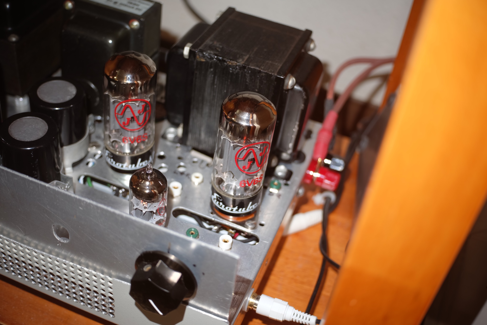

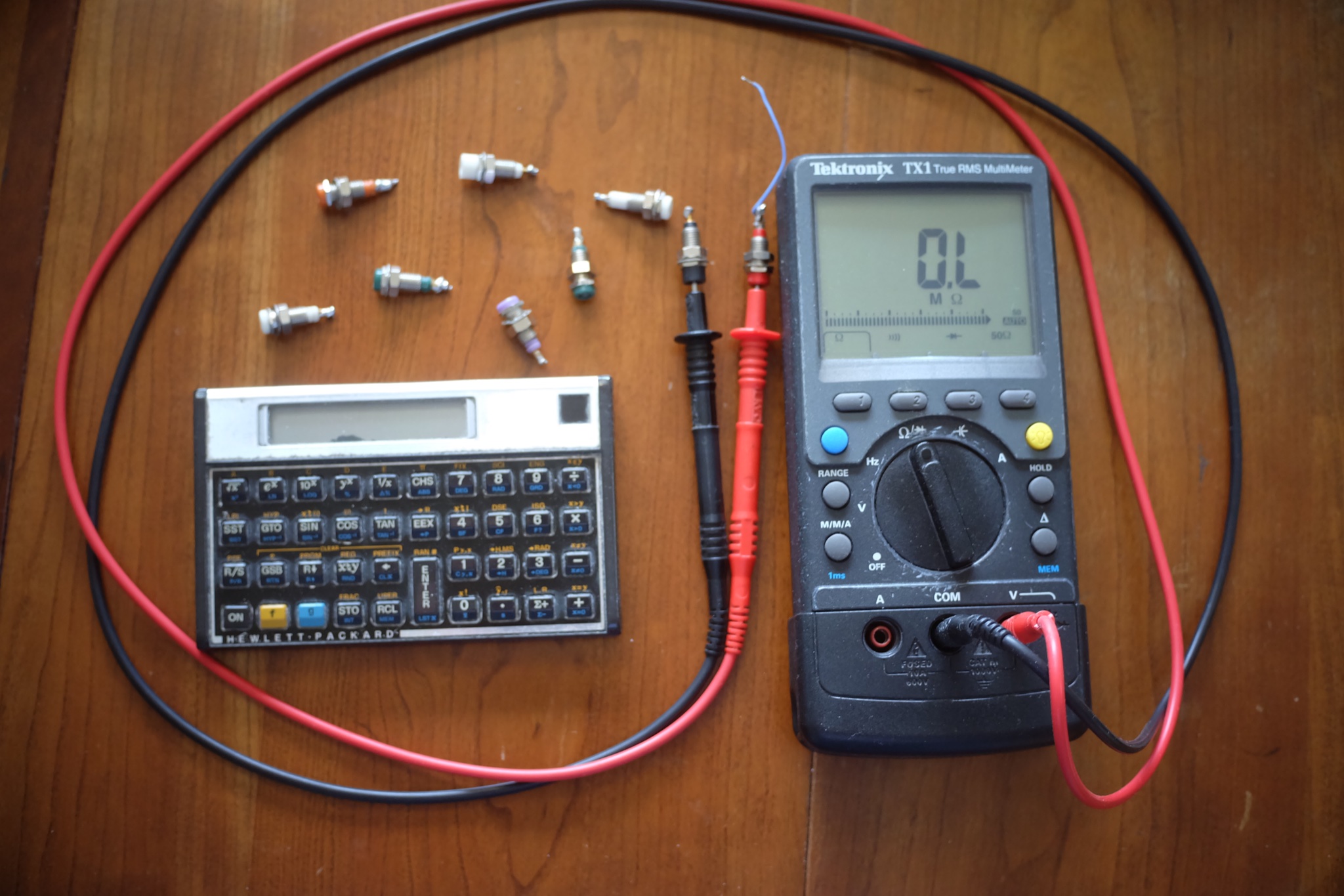

2 pictures of the top of the amplifier showing the tip socket test points (it's nice to measure voltages without turning the amp upside down and removing the bottom plate).
1 picture of the messy insides (the power transformer and chassis have been a good host to at least 4 different amplifier topologies).
1 picture of tip socket test points, with, and without meter probes inserted.
I hope the schematics and pictures are self explanatory, if not, this thread has space for a few posts of questions.

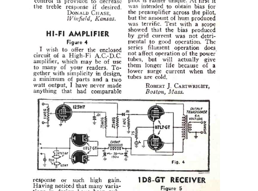

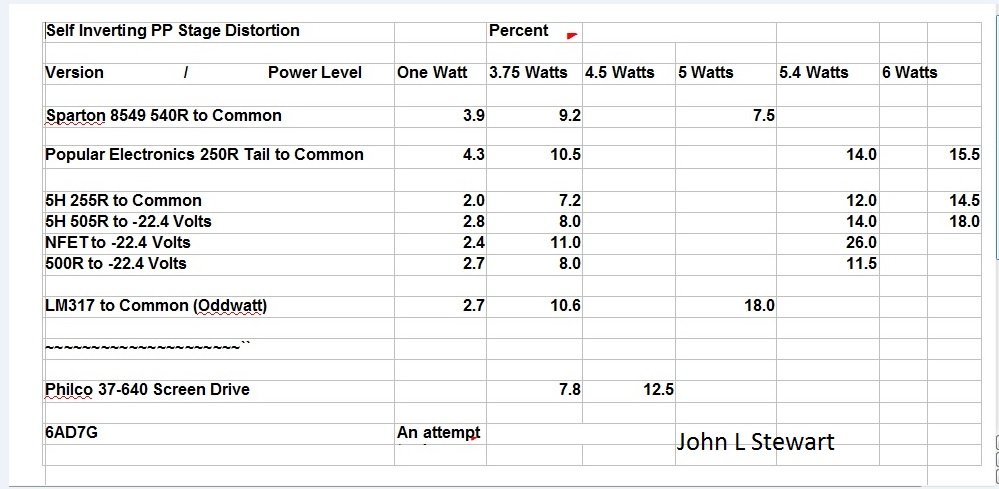

A very old circuit, the earliest I've seen is from about 1944, WW2 using PP 117L7GTs.
Many experimenters have built versions of this circuit including yours truly.
All my results were posted here on DIY. late 2016 & early 2017..

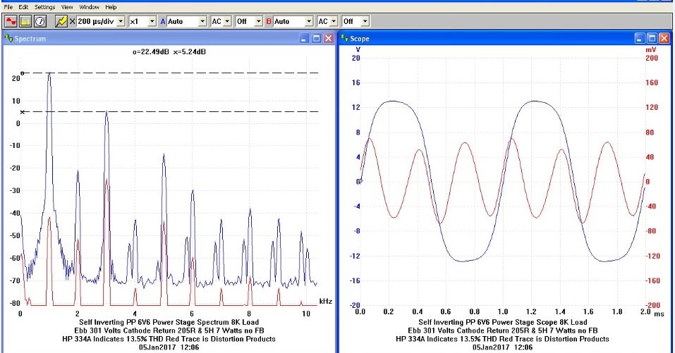

Best performer was using a choke in the tail, some of the measurement results at 7W.
And a photo of the test mule.

Summary of Performance Self Inverting Amplifiers Circuits
Conclusion, this circuit is not worth your time. Some versions use a Cascode Driver,
the 2nd triode is better used to form a normal inverter followed by regular PP final.
Many results for the curious still here on DIY.

jxdking,
I had a good reason to use the IXYS CCS:
The ECC82 u = 20.
Note: No bypass cap across the 470 Ohm cathode resistor, Rk.
But the "missing" bypass cap raises the plate impedance according to u x Rk.
20 x 470 = 9,400 Ohms.
The new plate impedance is 7,700 + 9,400 = 17,100 Ohms
17,100 rp has to drive the CCS that is in parallel with the output tube's Rg, 100k.
Some would suggest that Rg can be much higher than 100k, yes it can . . .
But I wanted Rg, 100k, to effectively "swamp out" any grid current that might occur, when the peak signal swing puts g1 voltage at the tube's contact potential.
Many know that the g1 starts to draw a little grid current when g1 voltage is Very Very slightly positive versus the cathode voltage . . .
However, there Also is grid current when contact potential is reached.
I estimate the ECC82's contact potential to be somewhere between -0.5V or even -1.0V.
Because the self inverting pp output stage cathodes only see a choke and resistor in series, there is No bypass cap, (and self inverting can Not have a bypass cap).
Those who "hate to see" capacitors in their amplifiers, the only caps I use in this amplifier that see signal voltage, or that see signal current . . .
Are the coupling cap, and B+ # 1 cap, and B+ # 2 cap.
Those capacitor haters ought to be 1/2 way to Heaven, because of the low number of capacitors that see signal voltage or signal current.
(Do Not forget that as always . . . B+ filter capacitors Are in the signal path).
An interstage phase splitter could eliminate the coupling cap, and allow a change to the output stage cathodes.
But do not forget, B+ # 1 and B+ # 2 caps Are in the signal path.
I wanted to make a push pull amplifier that is as simple as any other push pull amplifier. I purposely decided against using:
an interstage inverting transformer; an Input inverting transformer followed by 2 triodes, a paraphase inverter, an LTP inverter, or a gain triode and concertina.
Make your own decisions about which topology you will use . . . and enjoy the near field listening sessions as much as I do.
The above tradeoffs were mine to make, when I designed the amplifier.
YDMV (Your Decisions May Vary).
