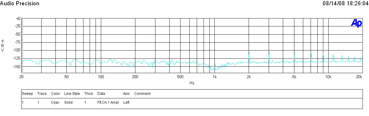

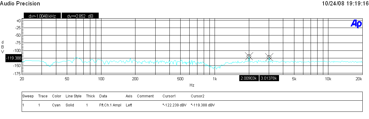

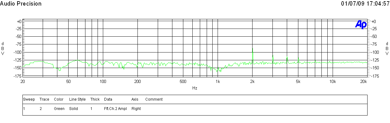

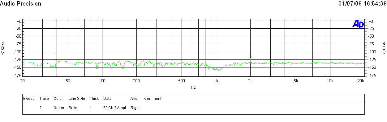

I have a few more AP plots of it here. These tests are at unity gain, 1v into 50 ohms ("typical" level on the ATH-A700s is actually more like 100mV so this is worst-case). You can see that THD-1K is about -117dB, THD-10K is about -106dB, IMD-10K+500 is about -106.

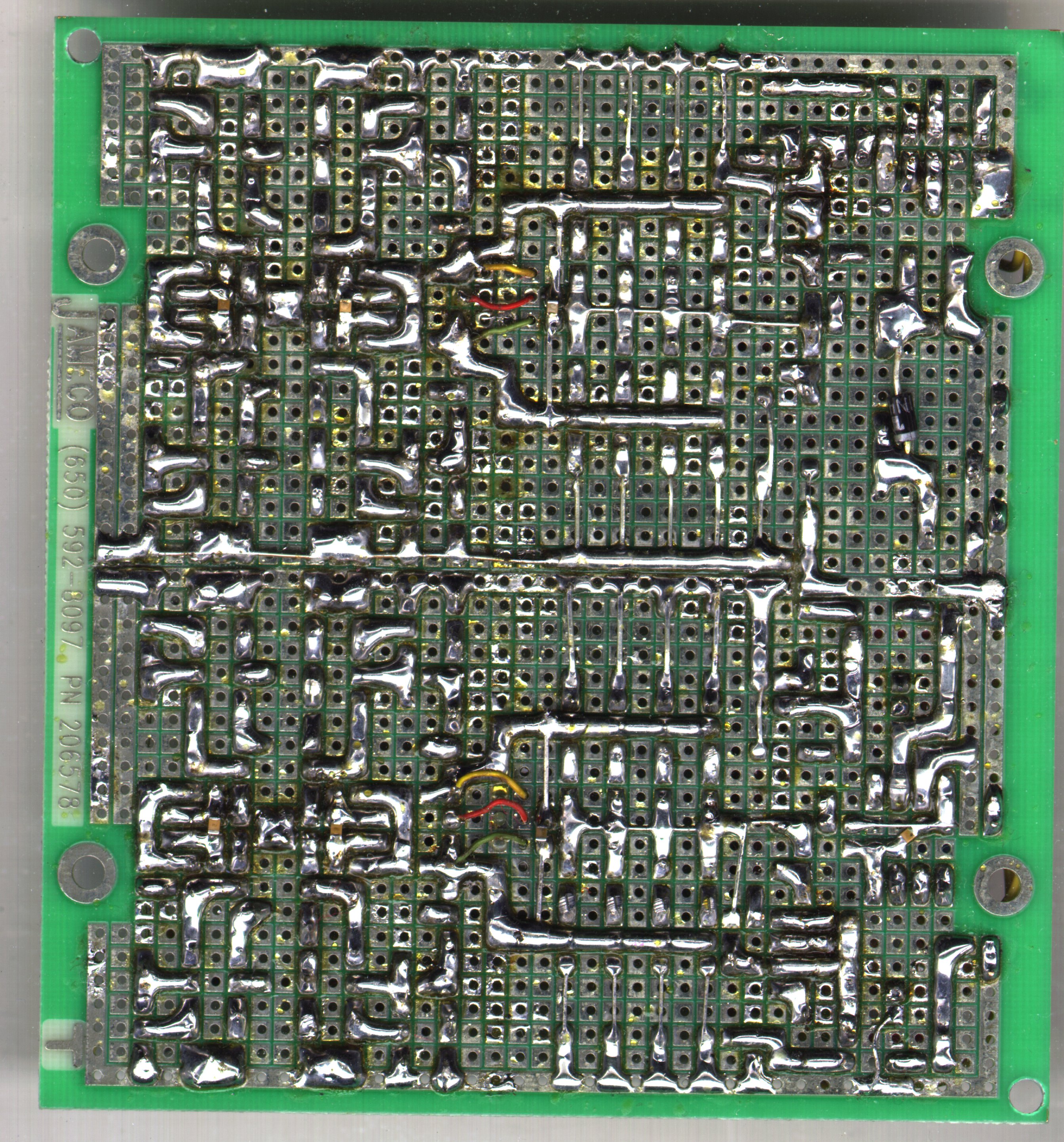

And of course, some obligatory pictures of the actual prototype: top, bottom. The TL082 is the DC servo. The soldering may look a little excessive, but keep in mind this is a pad-per-hole board so I connect adjacent pins by bridging, which requires a large blob.

Bipolar diamond buffer version, MOSFET version. Check out the nasty set of high-order odd harmonics. The difference is -100dB versus -117dB, not a small one at all IMO. Those last few dBs are the hardest to get!
It is worth noting that the MOSFET version pulls 0.0004% THD+N, unweighted, 20Hz-20KHz. The "sweet spot" where THD+N is minimized for a 50 ohm load is from 1v to 3v of output.
