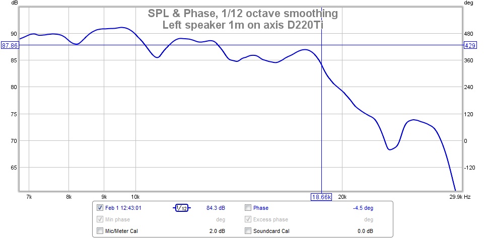

I have the Selenium D220Ti in this three-way system designed by Bob Crites. Sounds excellent.
If there was a nit pick, it would have to do with the measured frequency response not quite living up to Selenium’s spec of 21 kHz.
See attached measured response.

There's certainly smoother HF extension out there than the D220ti, but I don't think the rolloff in your measurement is accurate, or at least it's not the driver's fault.

I would expect it to look a little less smooth at 1/12 octave smoothing, it looks like you're not using a calibrated mic, and it's really easy to lose a little bit of your frequency extremes anywhere along the chain. Do you get flat to 20kHz measurements from other speakers? What's it look like from, say 5cm straight out from the horn?Not accurate? Please explain...
Also, while I totally support using better, smoother compression drivers (although I don't know about what's going to be a good drop-in for your crossover), as far as the specific issue of 18.6kHz extension vs 20kHz extension, it's not much different. It's D10 vs D#10. It's equivalent to difference between 30Hz and 32Hz in bass extension.

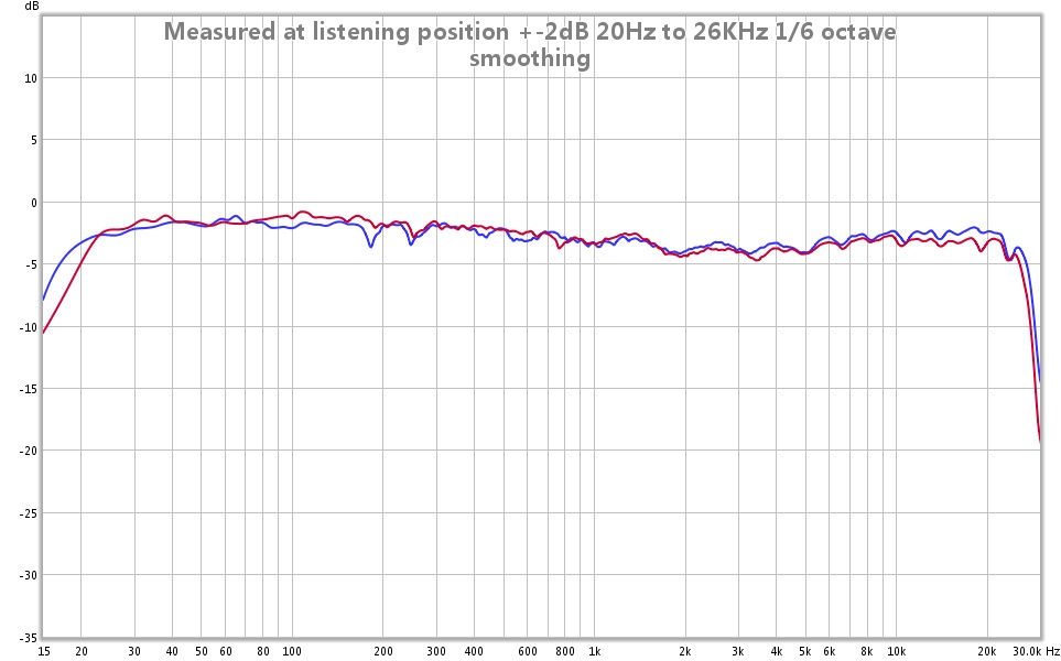

Thanks. I am using a calibrated mic and have measured systems flat out 26 kHz - see attached. The electronics have been measured flat to beyond 48 kHz (using 24/96 in REW).

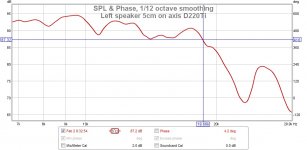

Attached is the D220Ti response at 5cm. Not much different.

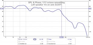

The D220Ti starts to rolloff at 18.6 kHz., whereas looking at the product graphs for the BMS 4540 rolloff at 30 kHz. That's a significant difference.
My question is has anyone heard the BMS 4540 or measured actual frequency response? Or can recommend any other 1" screw on compression driver with extended HF response? I am more interested in HF extension than smoothness for my application.
Thanks.
I see. Most the measurements I've seen of the selenium actually have a bit of a peak around 20k, looks like break up, but I suppose they vary. Have you tried measuring the driver on the horn without crossover? Doesn't look like anyone else has (except Crites, one would hope.).
Anyway, as far as what you want, I guess ring radiators are what you're going to need.. Besides the 4540, for threaded ones, hmm... JBL 2407 or 2406? I think at least one of those is threaded. I have heard the 4550 sounding very nice, whatever that's worth. Never heard the 4540, as far as I know.
