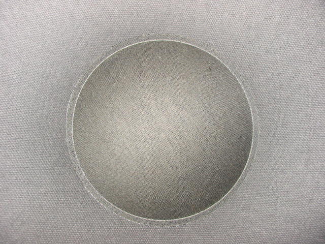

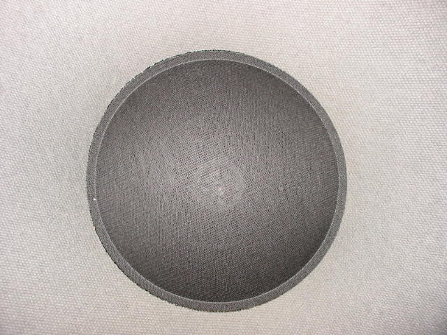

Well, the long awaited 15's arrived this morning. And surprise, surprise they have a different appearance. As you can see by this pics, the cones are a different colour.

Nice tablecloth...
I'd at least contact the vendor... you did order a "Pair". Have the dat codes handy (ie if you can get another with a date code close (same is the best close) to one you have they are likely to be MUCH closer in performance.

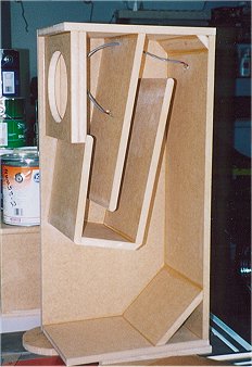

i been looking around on rear loaded horns. the ones that got my attention were these, for the fostex speakers
i downloaded the hornresp program, but i have no idea what to do no it!!?!?!?!?
lol might get someone to help me design rear horn for the coax's
anyone here able to push me the right way? i know my mate uses hornresp, but he isnt on the internet anymore, so i cant exactly get his help.
The 15C01P's semi-high Qes means a huge horn even with a relatively high Fc since you have to start with a relatively large filter chamber and a throat >Sd, so I recommend a max flat ML-TL if you have room for a pair of ~25ft^3 cabs tuned to ~29Hz, or a ~11.16ft^3 reduced Vb version if not. If this is still too big, then even a sealed cab is going to be close to 8ft^3.

After listening to them again, I am able to detect a slight difference in the high end and as you might expect it is the see through cap that has the better highs. No return phone call from PE as promised.
Cal
Edit: I have called again and got a fellow who seems a little more interested in my plight. He is going to try and track down a single somewhere and will let me know in a day or so. Will keep you posted on the progress.
