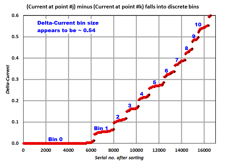

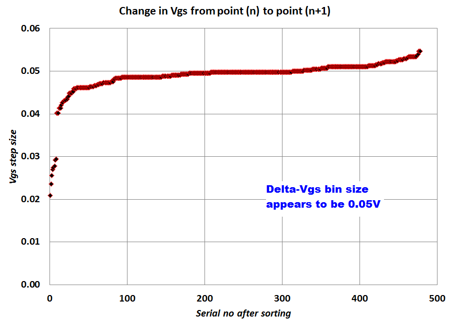

I fiddled with that text file a little bit. To my surprise, the floating point data are NOT quantized as discrete (integer measurement) / (integer scale factor) points. Instead the data fall into rather fuzzy bins with lots of sub-LSB dither / noise. Here are a couple of plots.
The horizontal stepsize, which the internal comments label "Vgs", seems to be quantized in steps of 50 millivolts ... plus or minus some fuzz.
The vertical quantization, which the comments label "Id", seems to be 0.54 milliamps ... plus or minus rather a lot of fuzz. The number "0.54" is itself rather surprising, since it's not a power-of-ten divided by a power-of-two as you'd expect from a binary ADC. All very interesting!
I encourage other readers to download that .txt file and play around with it; you may wish to view the data from a different angle than I did.

Vgs change of 50mV is the step I specified in the software, but the actual values are measured by the ADC and hence the fuzz I believe. The current are computed by voltage measurement divided by resistor in use (relays are used for different resistors), hence the unusual value.

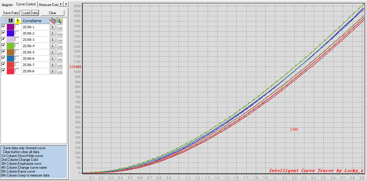

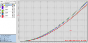

I forgot to mention that file was actually for a set of 8 2SJ56, attached is the graphs from the software. Also attached is the hardware manual, which explains everything in details.
