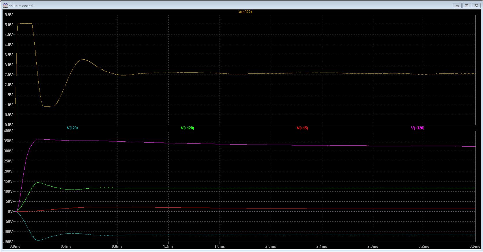

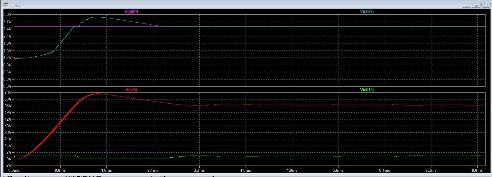

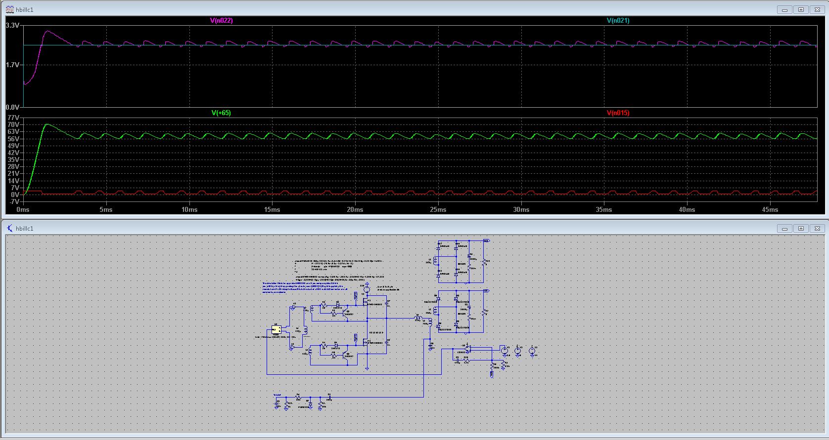

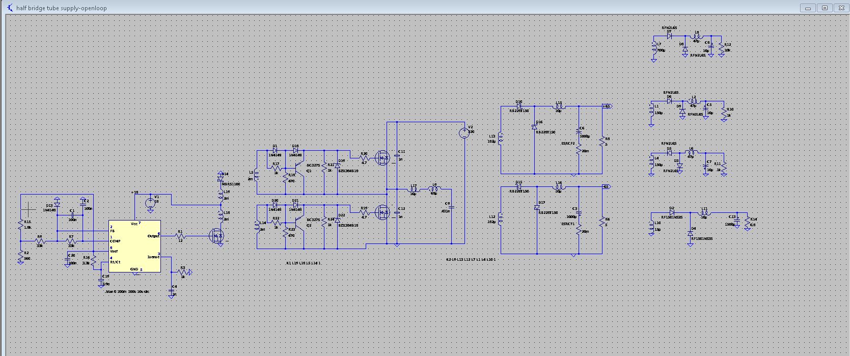

I did see this thread, I have to make choises what concerns a resoant smps for multiply voltages from one is 320 volts, two are 120 volts bothe max 250mA and 15 volts 15 ampere.
I can not well deside what kind of rectifier to use, what is best, I use single coils.
Supply is for tube hybdrid amp, and go use two, one for the mosfet 2 x 65 volts 15 amps open loop, (need no regulation, tube part do need.)
Thanks for advise in advance.
