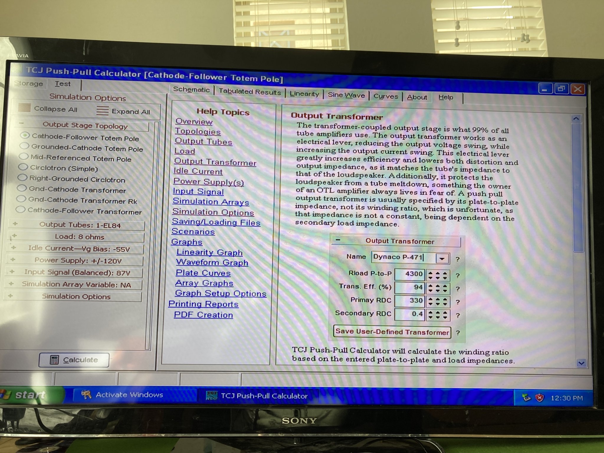

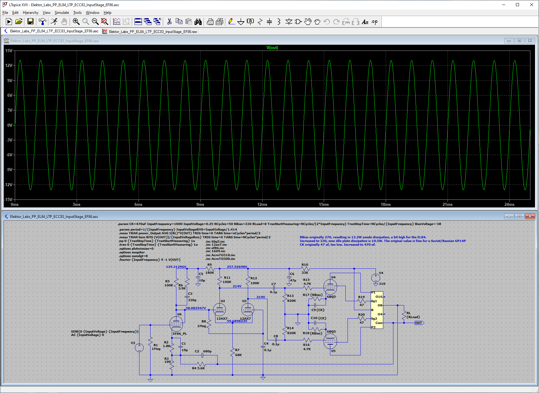

You have it set to simulate a cathode follower totem pole - there is no OPT.I have fought with the Windows XP machine for over a week, countless hours put in including re-installing XP, only to find a couple of seeming major flaws: no way to select the input tubes and no way to change the OPTs (despite what it says). I did look through the program to no avail. So then how do you simulate a specific schematic, please?View attachment 1145870
And no, it is not intuitive... At least so far. 🙂
Select Gnd-Cathode Transformer instead...
To change the tube parameters, select User Defined from the bottom of the list...

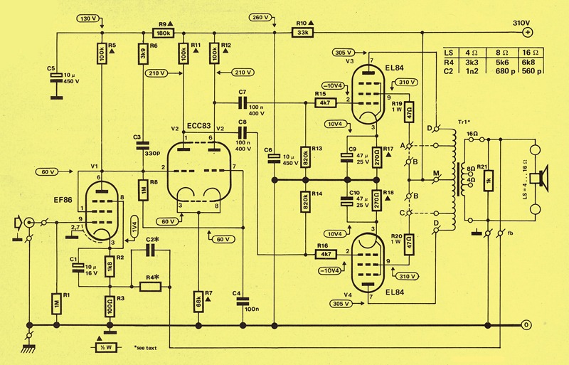

Here is my guess:
* EL84 maximum ratings:
- PIV 600V
- Max in 300V RMS
- Iout 65mA DC output current (per anode)
- Ia pk 48mA repetitive (2200mA transient)
- .----- Anode
- | .--- Cathode
GP A K VALUE={2.69E-4*(PWR(V(A,K),1.5)+PWRS(V(A,K),1.5))/2}
.ENDS EL84
Neat! 😀I updated the schematic, fixed some bugs and changed the component's references to match the ANK schematic.
Now it looks like this:

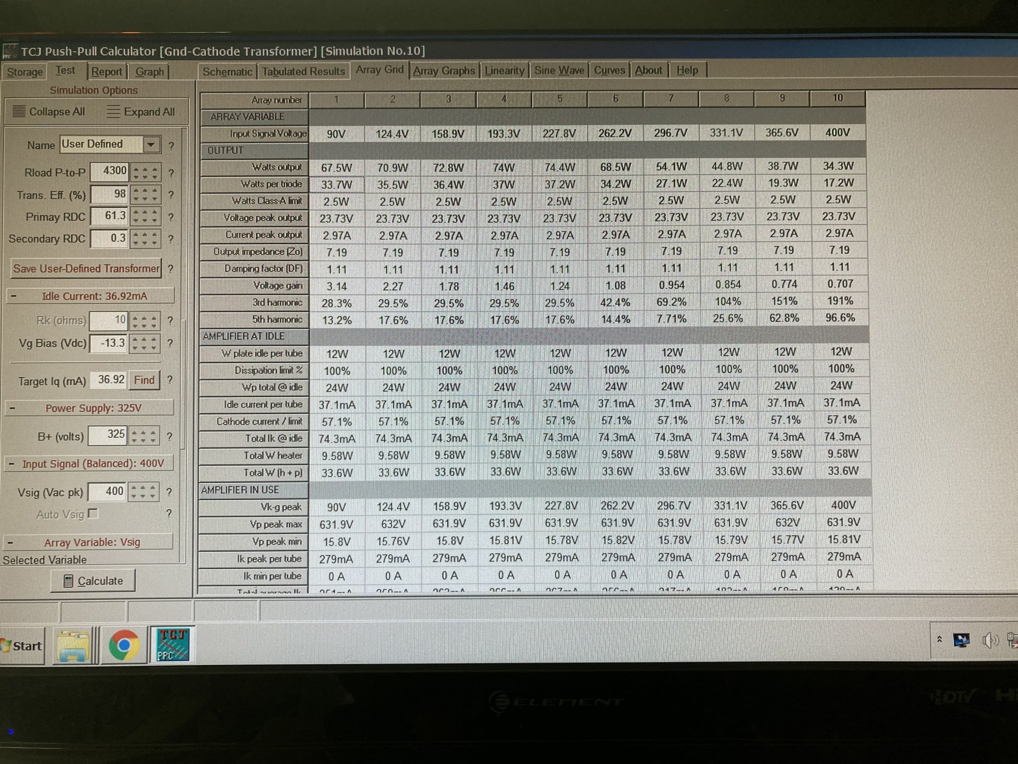

Thank you! 😀You have it set to simulate a cathode follower totem pole - there is no OPT.
Here's a shot of a sim of a Modular Amplifier with 6P45S outputs.

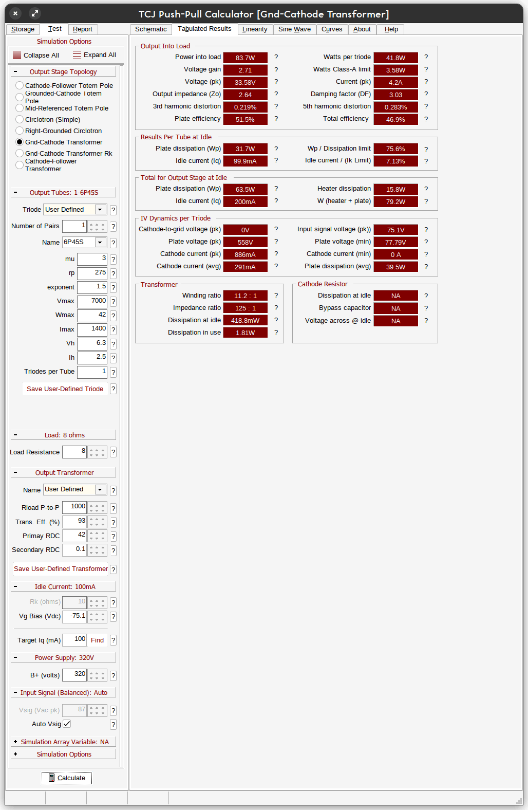

Is Select Gnd-Cathode Transformer the option to always use when evaluating amplifier circuits?
All I know is one is cathodyne and one is LTP. So for these two, what do I select?You select the option that matches the topology you're using.
How do I change the input tubes (ECF80 and EF86)?
Somehow I missed that... Oops. Thank you for the correction.It only simulates the output stage dude...
Turns out none of them quite match exactly, does this matter for high level evaluation?You select the option that matches the topology you're using.
My amps are grounded cathode with OPT and fixed bias...
If you used "cathode bias", use the one with Rk at the end.

The secondary's resistance is not a value that I can find, assumed since a high quality OPT used 0,3Ω.
Can one know from a schematic the idle current (Vg bias)?
What about "Target Iq (mA)"? Taking a WAG, maximum plate dissipation is 12 watts, 325 volts is going in, so using the elementary formula, that be 36.92mA maximum. Using "Find" give a Vg Bias of of -1,4VDC (115VAC PS) - 2VDC (125VAC PS). Interesting that it is negative and so low.
Then there is the peak signal VAC. Well, RCA gives 5,7W and 50,6mA, Sylvania interestingly gives values for 250VDC and 300VDC plate voltages: 62-74mA and 72-92mA, receptively, and Telefunken doesn't seem to give a value. Looking back to RCA, see the plate voltage is 250VDC, so 65mA (thinking logically, 11 percent over isn't going to kill a tube) is a good value for 250VDC and assuming German tubes are of equal or higher quality to American, use 90mA for 300VDC. Using Ohm's law, using the typical 4.5000Ω plate resistance, come to 292,5VAC and 405VAC, respectively. Find it odd then the default is at 87VAC.
Well, past lunch time and still have to heat it up, better sign off and come back with a run, unless some generous person provides assistance. 🙂

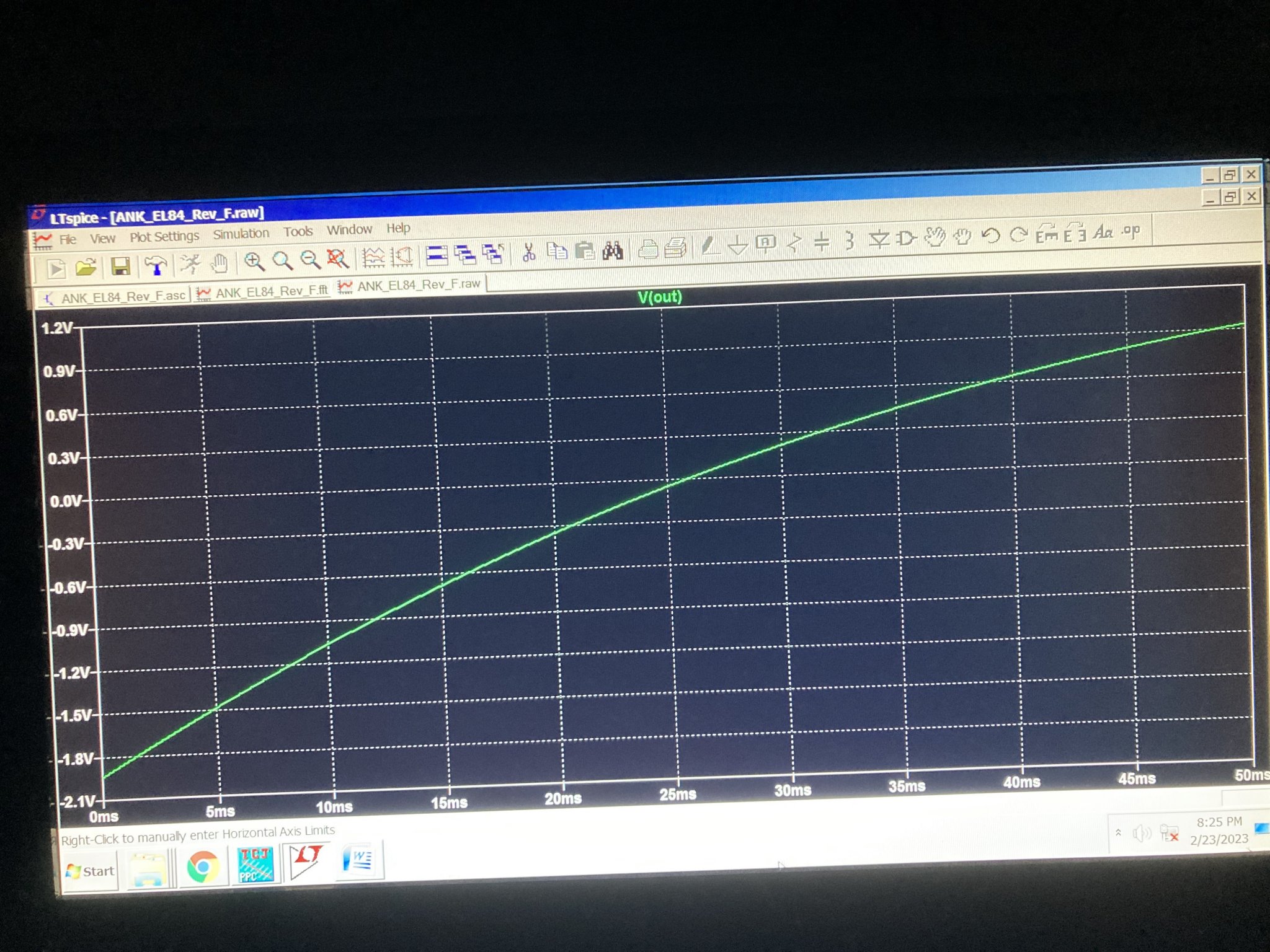

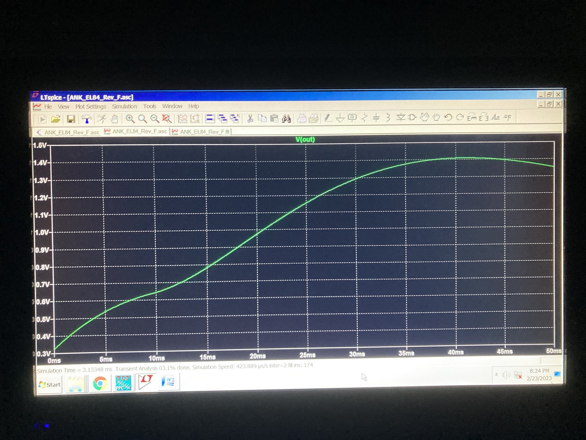

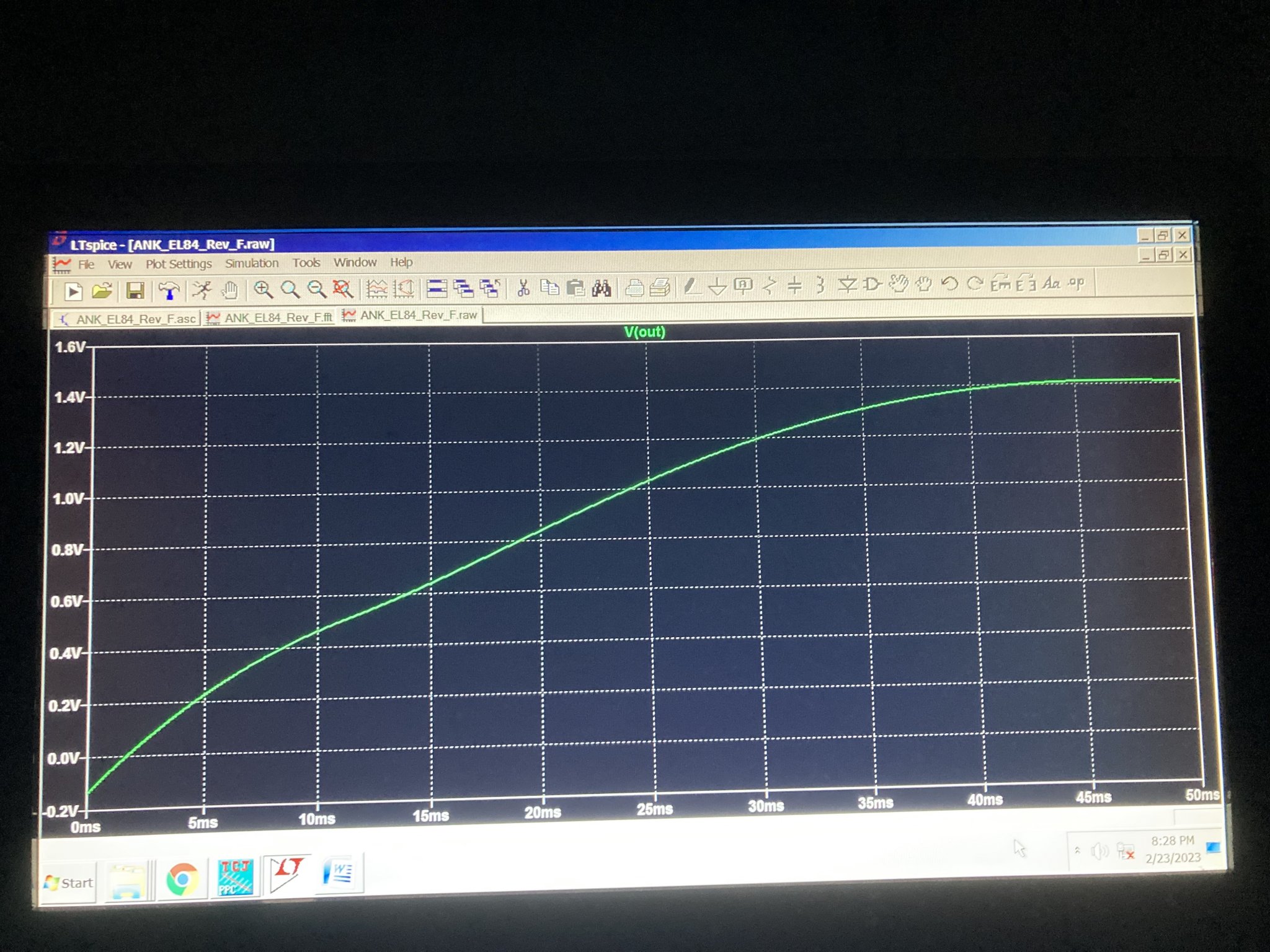

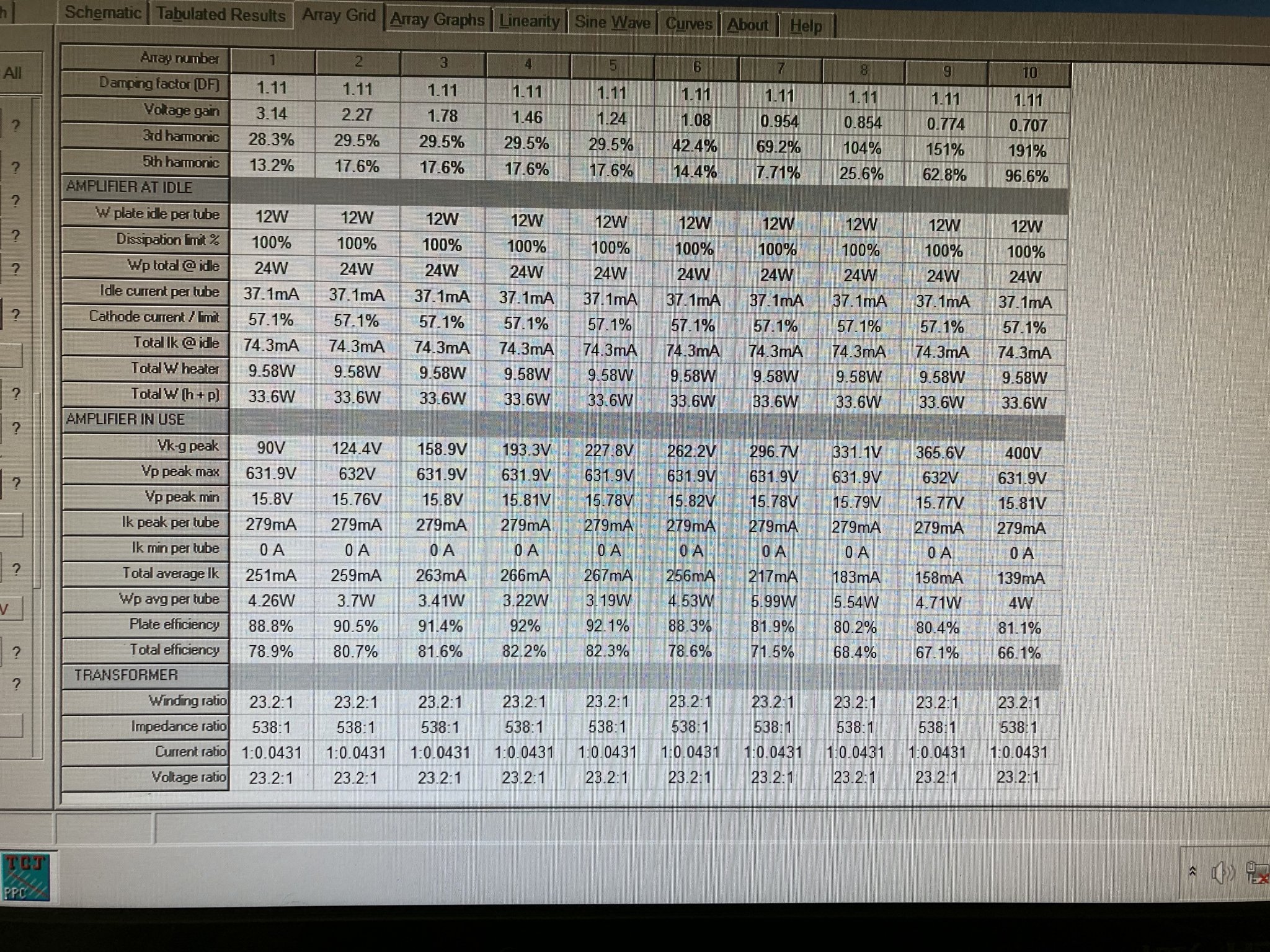

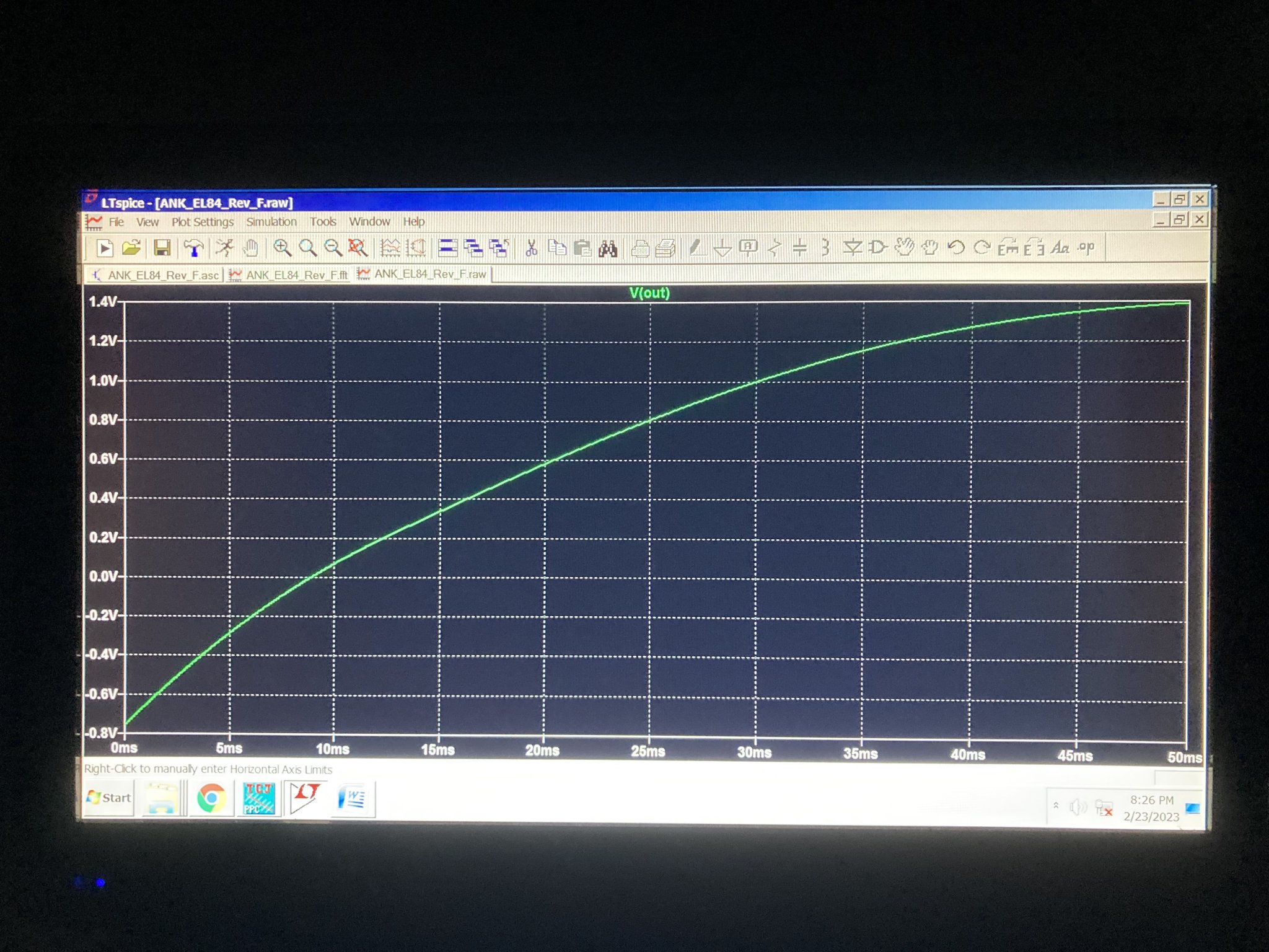

Turns out TCJ does run on Windows 7. However, something doesn't seem right with the results, either using calculated VAC maximum signal or in automatic mode. Once the bugs are worked out, can see how a useful teaching tool and maybe design tool, in can quickly view results, especially with array.
Just to show the graphs are generating.
Installing Spice now, then a 50 minute meeting.

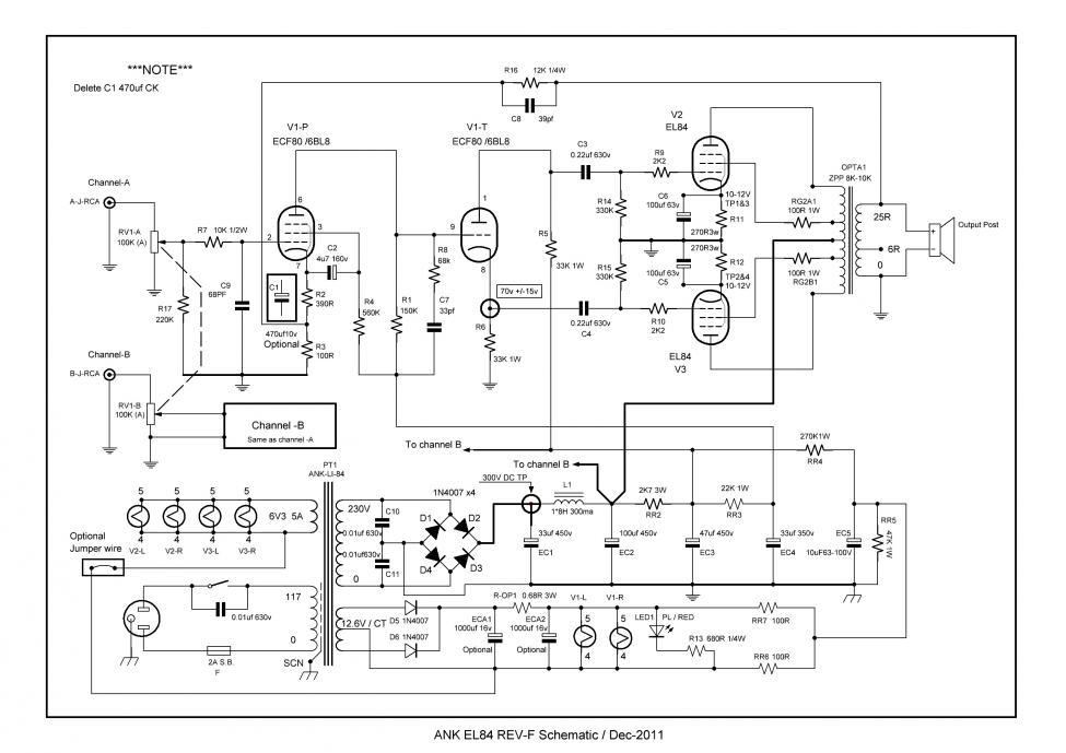

Huge shout out to José (@jcalvarez ) for providing not only the schematic, also for tube file and library, including transformer blocks (love to learn how to create, looked at the text and couldn't see how to edit, not in MDOS (done a little for an energy evaluation program years ago))!

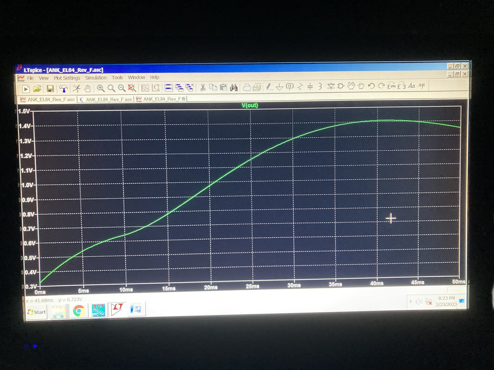

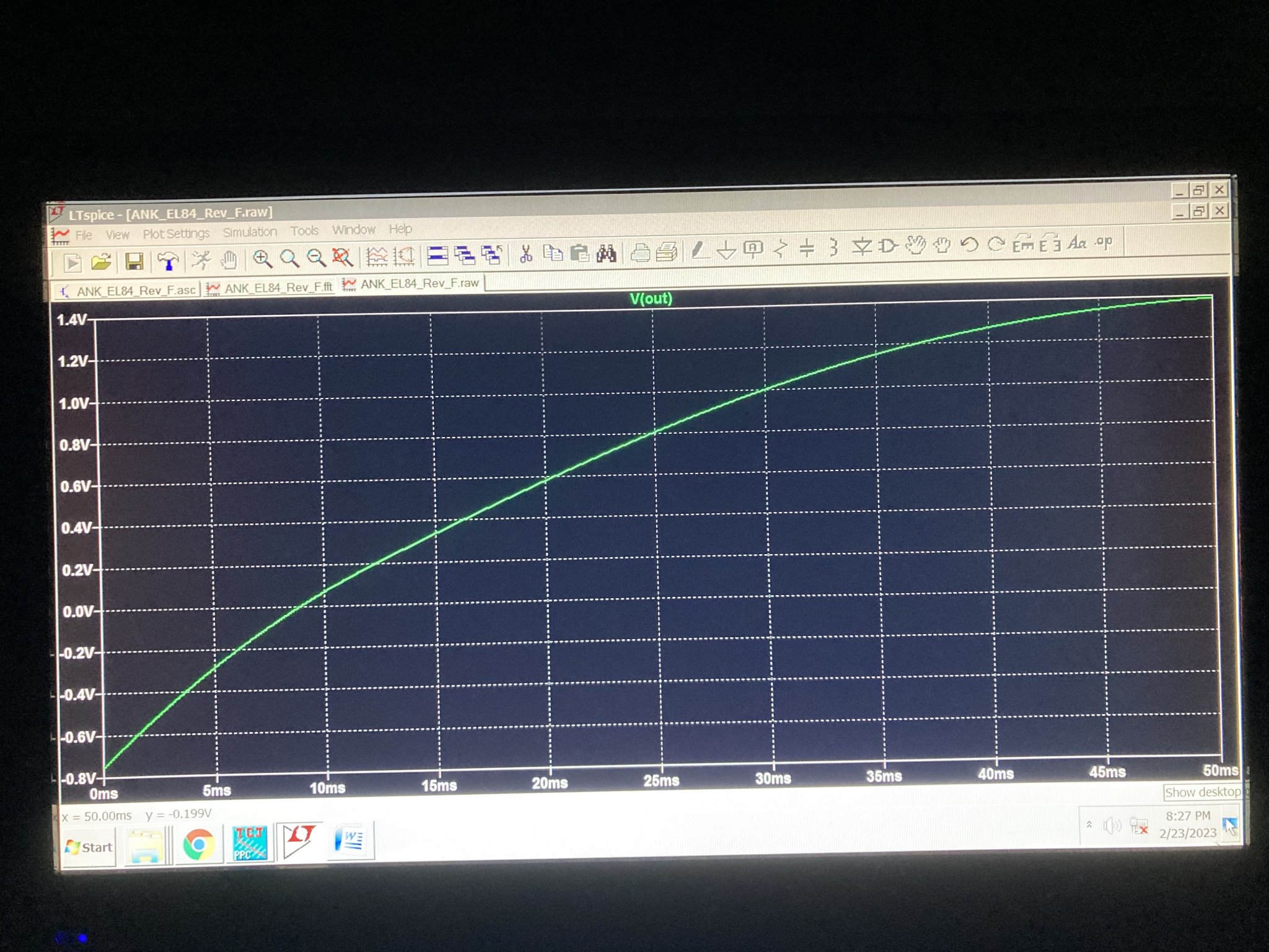

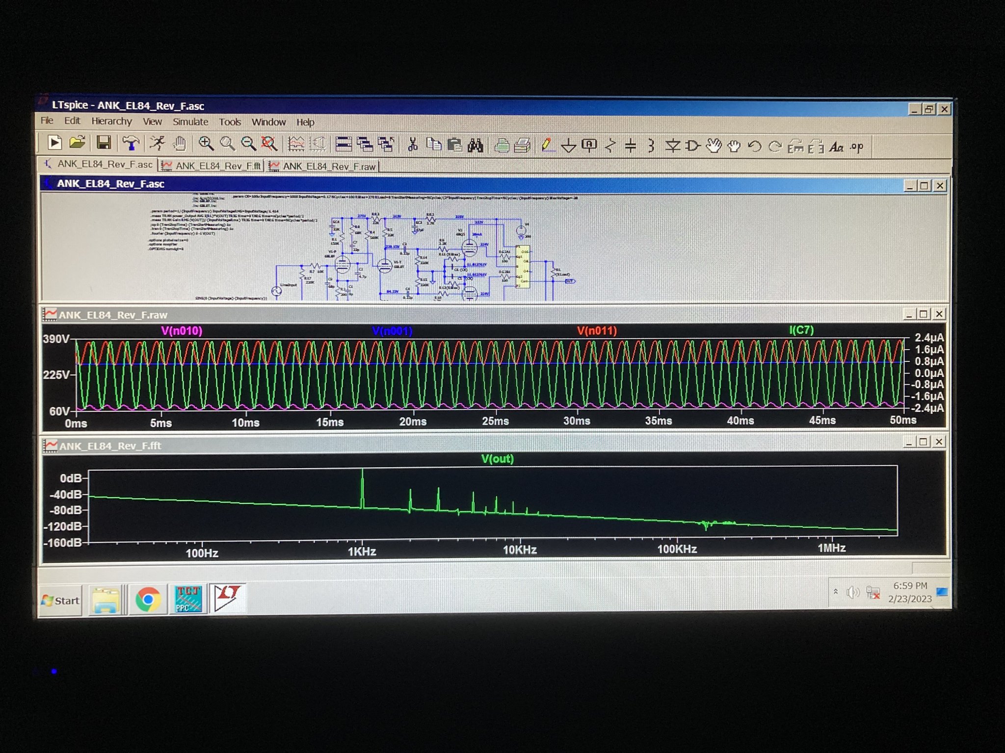

First, ran a square wave of 10kHz though (going by memory of what the instructions were) and adjusted the feedback:
5K
10K (Revision E)
12K (Revision F)
15K
20K
50K

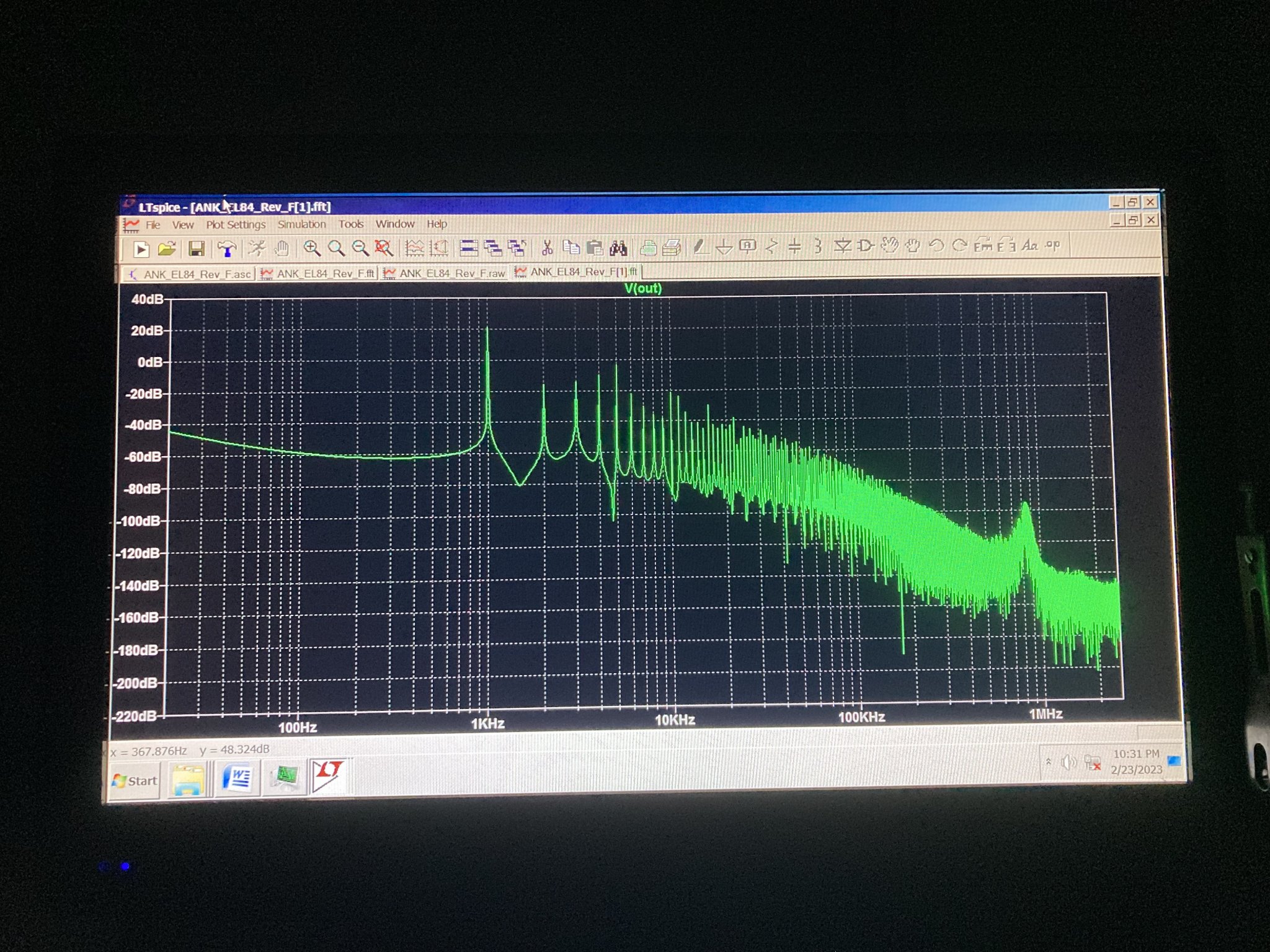

Lesson I learned from adjusting values is takes large changes from ideal to make an impact. Put in a 5K and a 50K potentiometer adjust the feedback for desired sound without detrimental distortion/harmonics based on this data; double check once built with REW or an oscilloscope.
Interestingly, didn't affect distortion, until...
No feedback. Oh my...
Here is the ECF80/6BL8 with the 12k resistor.

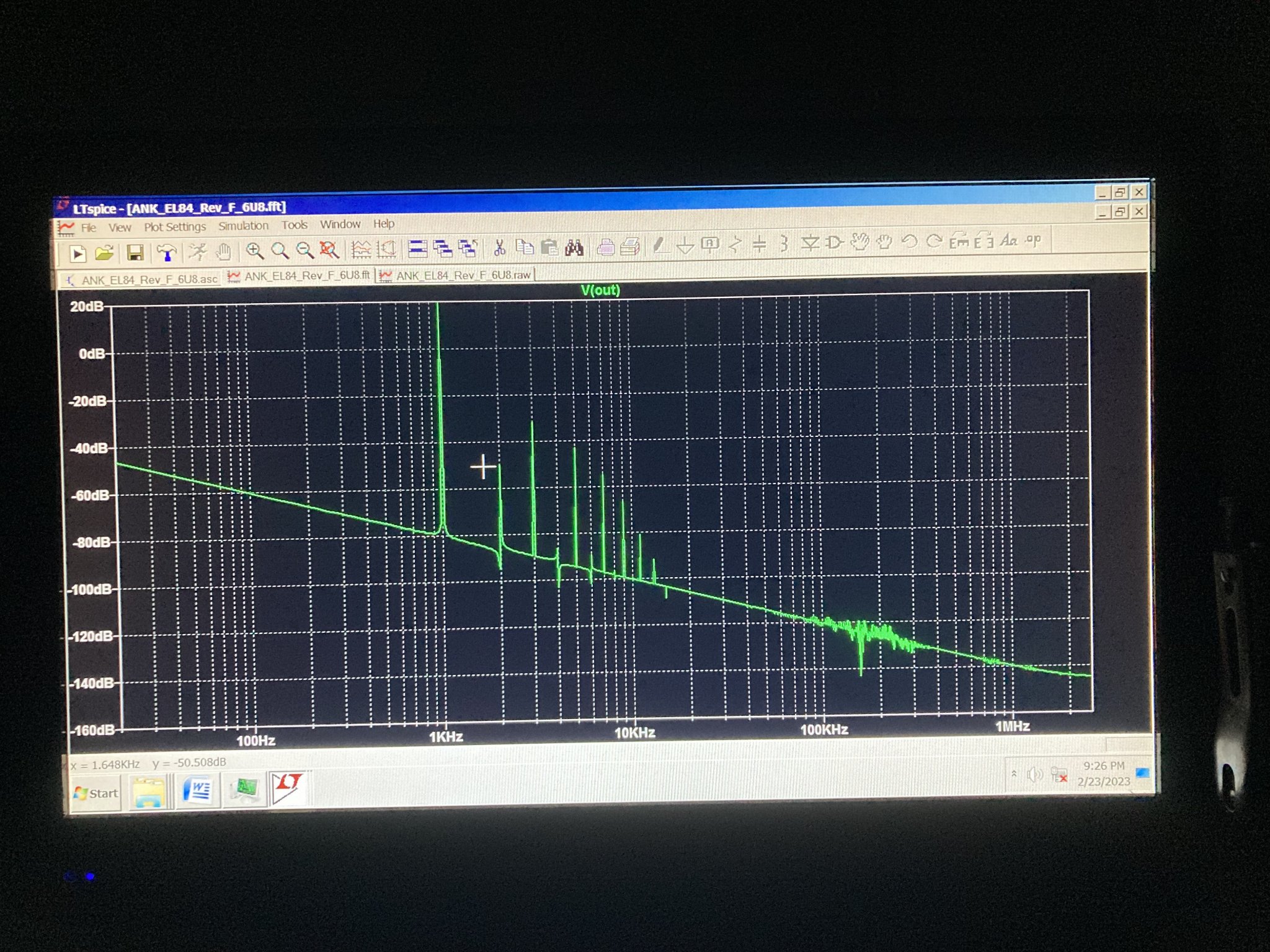

Finally, tube rolled in ECF82/6U8s and wow, think this is an improvement, went from -35dB to -50dB on the second. I did try increasing the plate voltage (per the data sheet can handle twice) though seemed to make no difference. I probably don't know enough to change the schematic for optimum tube roll.

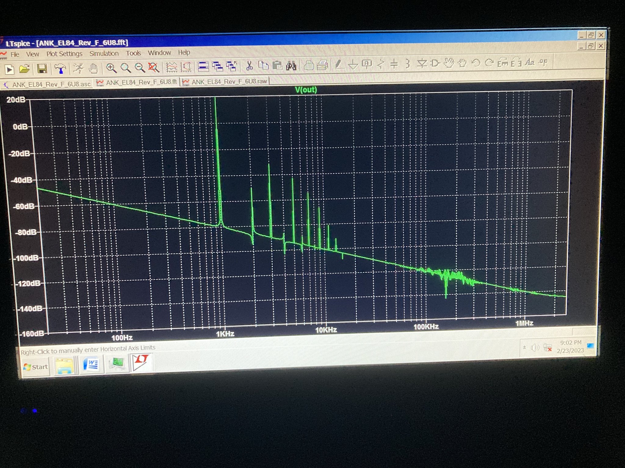

Man Spice is addicting! Where did the time go?
5KView attachment 1146313
10K (Revision E)
12K (Revision F)
15K
20K
50K
Though at 50K it finally did affect distortion.
Lesson I learned from adjusting values is takes large changes from ideal to make an impact. Put in a 5K and a 50K potentiometer adjust the feedback for desired sound without detrimental distortion/harmonics based on this data; double check once built with REW or an oceliscope.
Interestingly, didn't affect distortion.

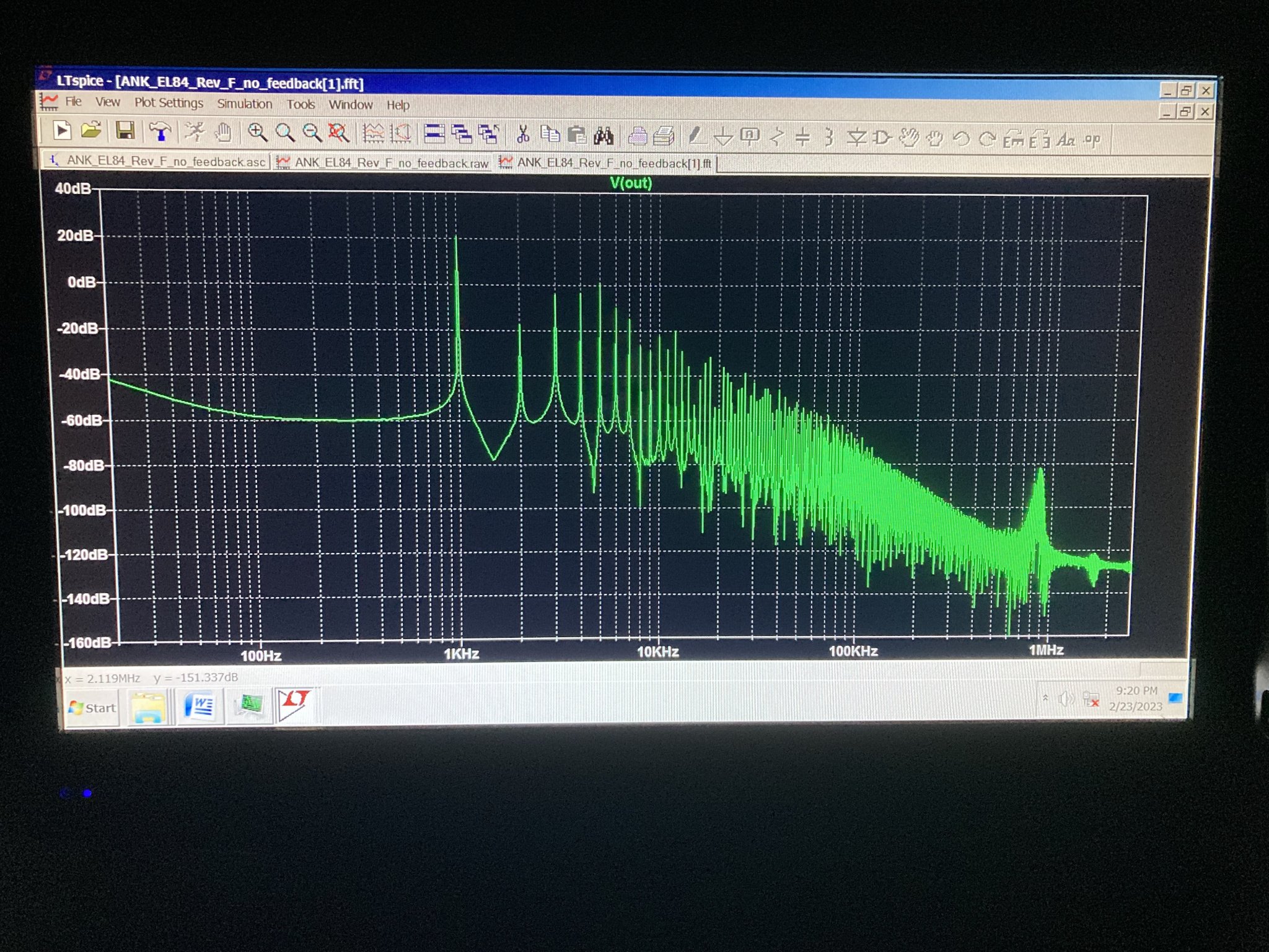

Onto no feedback, defiantly affected distortion.

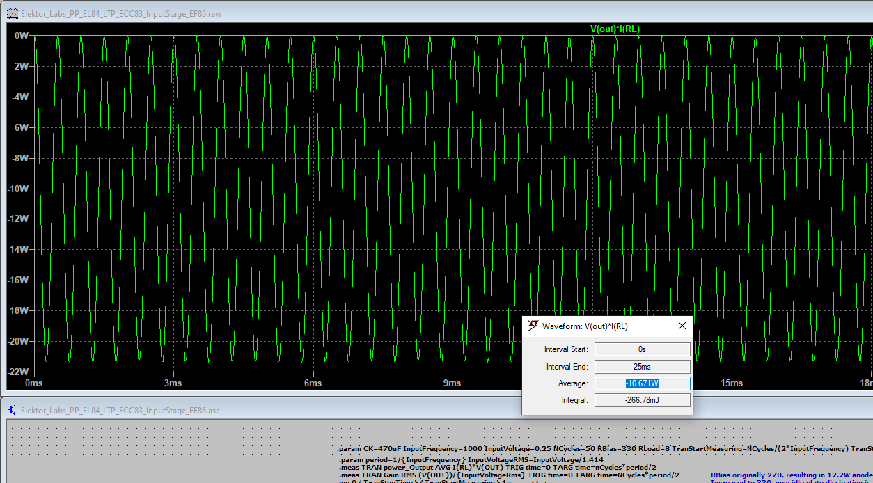

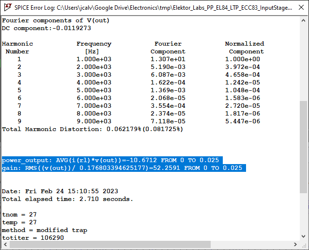

If you look at the schematics, there are a couple of measure commands:And yes, I will enjoy, especially once figure out how to view gain and watts average total.
.meas TRAN power_Output AVG I(RL)*V(OUT) TRIG time=0 TARG time=nCycles*period/2
.meas TRAN Gain RMS (V(OUT))/{InputVoltageRms} TRIG time=0 TARG time=NCycles*period/2
After running the simulation, you can see the distortion figures, power_Output and Gain, by clicking "View->Spice Error log", you will see something like this:
