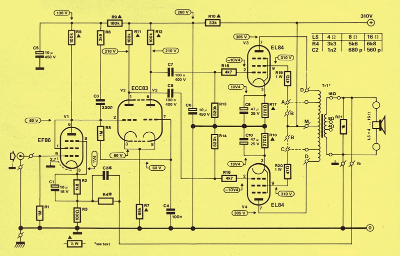

Or in the last schematic, R7 68kΩ becomes a total of 136kΩ going to pins 3 and 8, if understanding correctly.
I'm not seeing the schematic, but I would thing R7 becomes 34k.

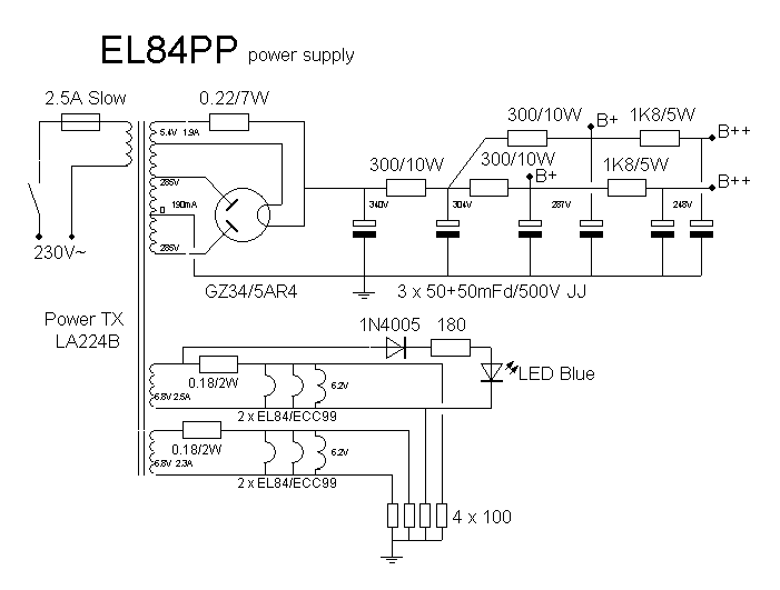

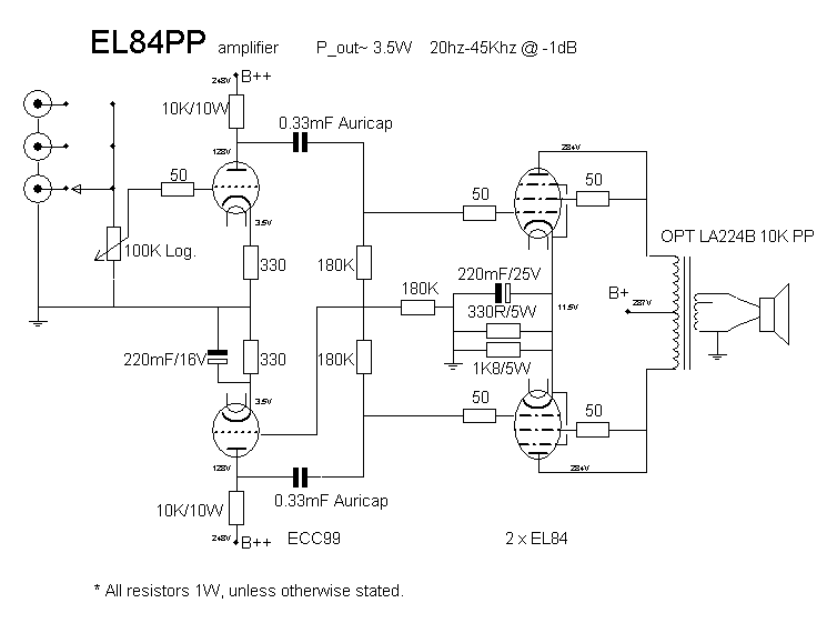

The topology being discussed, deployed in the Elektor Electronics deploys.
I assume you mean this one: http://www.r-type.org/articles/art-008.htm
There is nothing wrong with the topology, voltage amplification stage+LTP phase inverter+push-pull output stage.
But I do not like Elektor Electronics implementation of that topology, mostly the choice of tubes for the LTP, and also the fact that they use 4 tubes, for an EL84-based amplifier. There is no need for such amount of gain. Just a simpler 3 tube one, a double triode (or triode-pentode like the 6F12P or ECF80), one triode for voltage amplification, another triode as a cathodyne phase splitter and the two EL84s. That's it. That's basically Tubelab's SPP. No need for more than 3 tubes for such an amp (I'm not counting the rectifier tube).
I have realized this. Additionally, seems one should build something, then if satisfied, then that can be it.
Yes, that's the right approach, at least in my view. And even if satisfied, you can build another one 🙂. I myself find the process of drilling wholes, mounting tube sockets, transformers etc to a chassis, doing the wiring, powering up the thing for the first time etc a very enjoyable and calming experience.

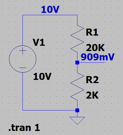

The colon means in parallel?
Sorry, I used the colon as a separator. Just a voltage divider like this:
Your input is 10V, the output is roughly 1/10 of the input (0.909V). You can of course select the right value of R1 to get exactly 1/10.
Provide it again, silly of me to think go back and dig it up.
Understood.
By the way, first time you mentioned the voltage, looked for the maximum the sound card can handle and didn't find anything stated.

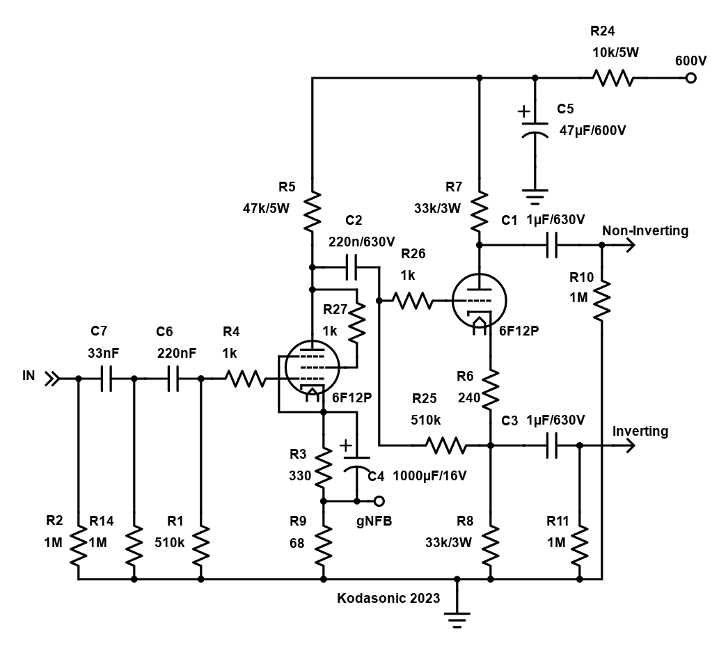

In the schematic shown, if you wanted to parallel the ECC83, you would make R11 and R12 50k, and R7 would be 34k. The voltages would be the same but there would be twice the current.
Of course in the above, there's no reason to do that - a single ECC83 will work.
We were discussing converting from ECC83 to 6F12P, as seen here:
The 6F12P is essentially 10 12AX7 in parallel, but without 10x the Cin (input capacitance).

No, we were discussing how to parallel tubes.
In the above schematic 6F12P isn't suitable. It's better when used for split load. LTP wants two identical halves.
The triode in 6F12P is like 10X 12AX7, the pentode is similar but not identical when triode connected. I should have been more clear.
Then why bring it up at all? I am confused how it applies to the conversation...

With regard to the schematic you posted, a 6F12P circuit like this can replace the EF86 and ECC83 part of it - everything on the left side of the drawing except C2 and R4 and still in theory work better while saving money.
It can swing over 150Vpp in this config, it also scales well so it can work at the lower voltages in that schematic, too.
R2, C7, R14, C6, and R1 make a 2nd order high pass filter to get rid of subsonics. The poles are purposefully far apart to improve phase shift.
