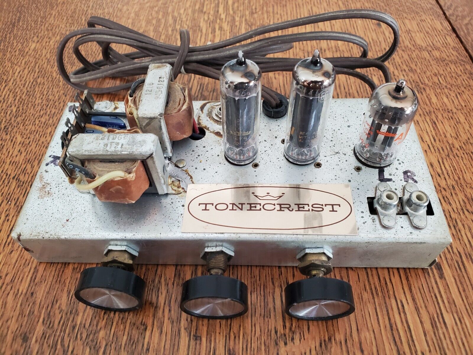

NO !!! no power transformer!! it's dangerous when you're a beginnerWhat about this to practice on before building what ever amplifier end op building?
Good suggestions. You get plenty of bang for your buck with all the hardware ready to rumble, and they could be passed on for the same or more if you get them working nicely.
Only consideration is that both need a protective base plate for safety.

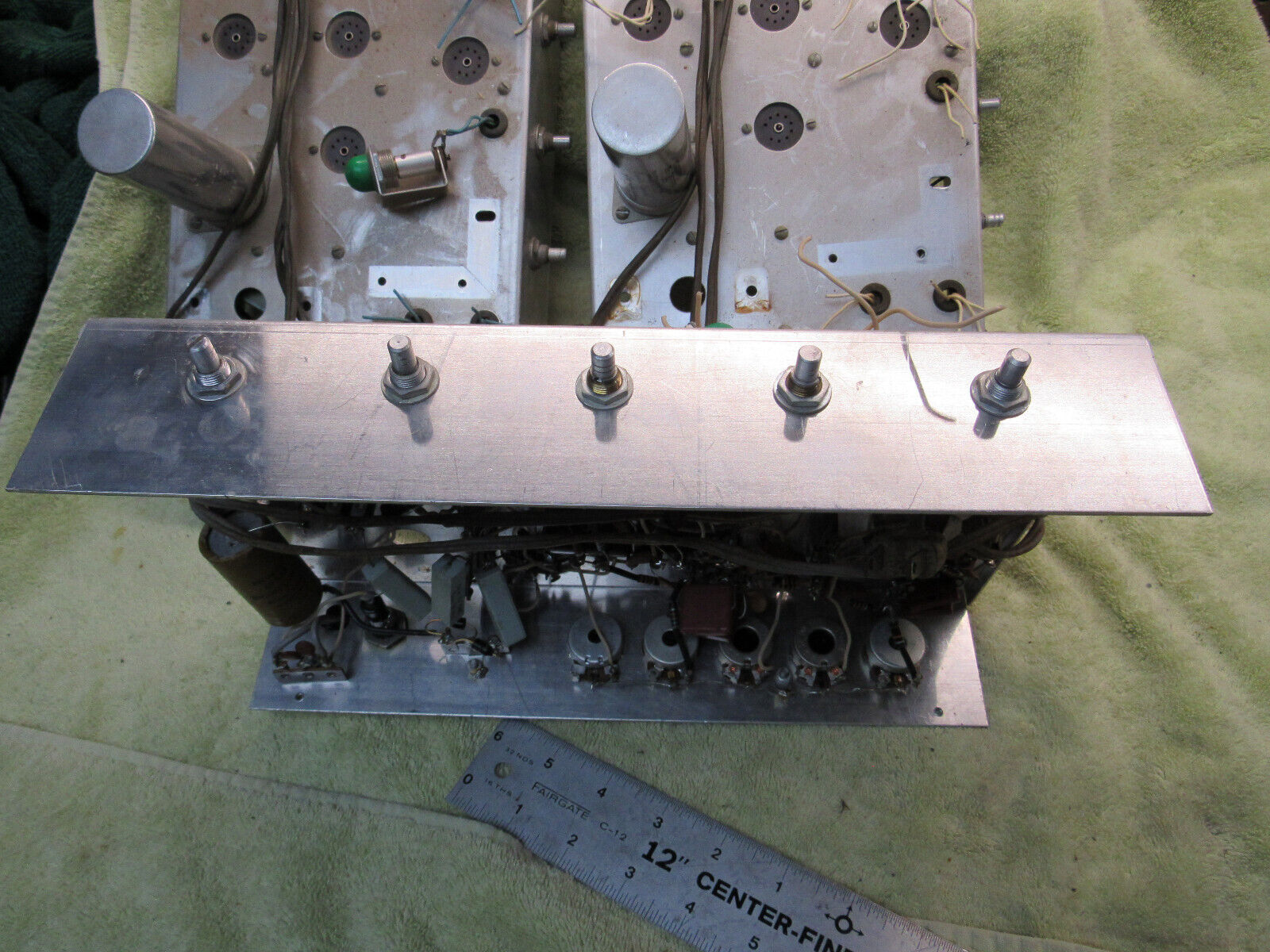

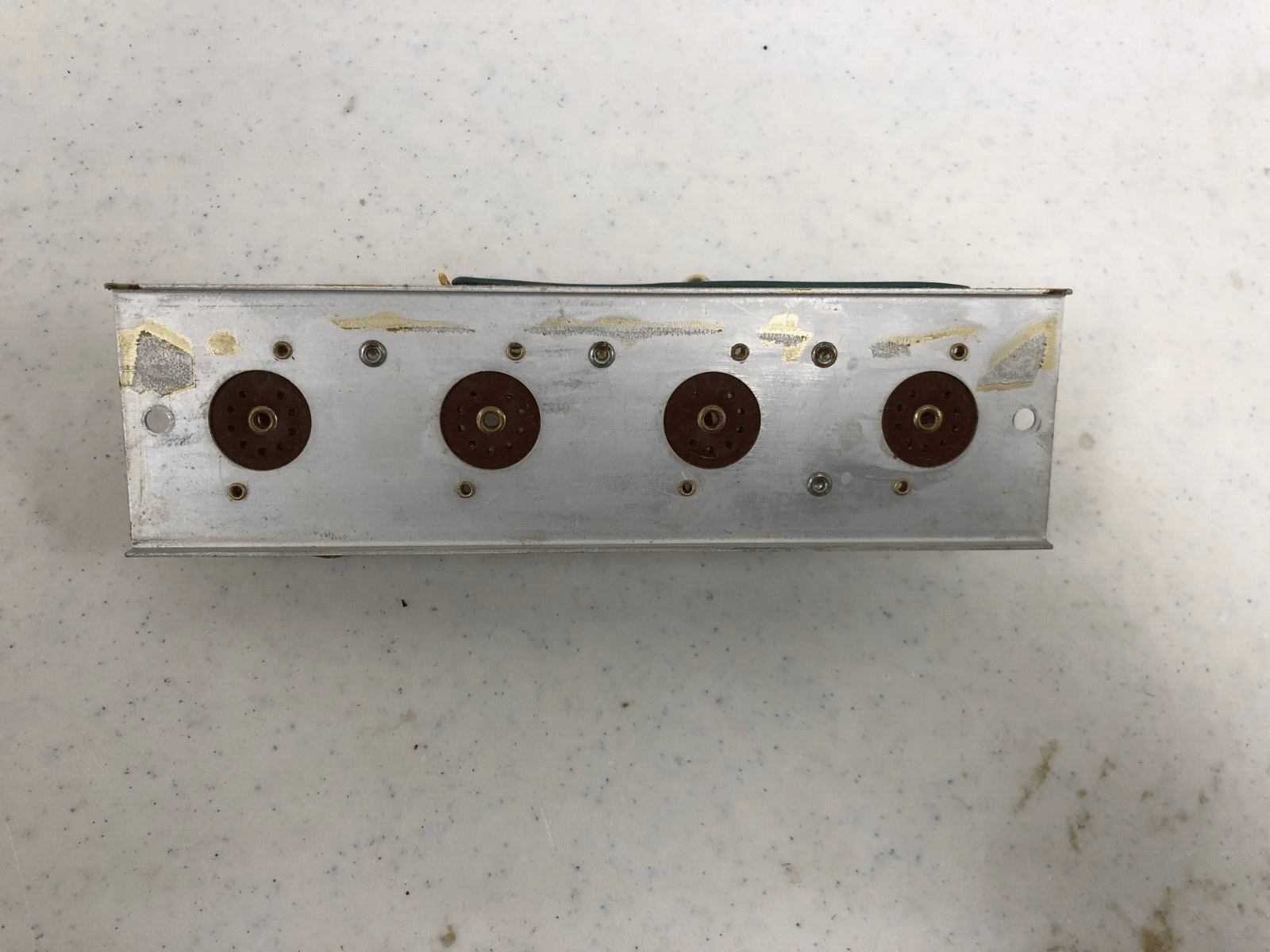

I looked but there is only a really ugly wreck and then it risks getting lost in the wiring between the inhibition/mute circuit, the opts circuit etc etc etc.Ami Rowe ex jukebox amps are also great starting points.

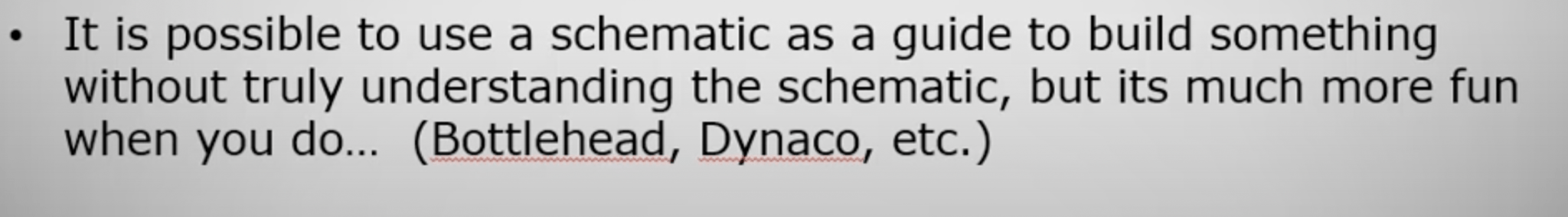

I am not going to deep dive into amplifier designing, just going to build an amplifier which has the correct components specified. Designing one seems far worse selecting a schematic that has only been built a few times, or once.
There is this interesting statement from Blueglow Electronics:
Based on what you said previously, they are opening themselves up to liability (someone builds an amplifier, like a Dynaco ST-70, and doesn't do the required checking of every component, and damages their speaker wire.
So the statement every single schematic has to have every component and circuit evaluated doesn't make since, especially as the Dynaco ST-35 was recommended to me.

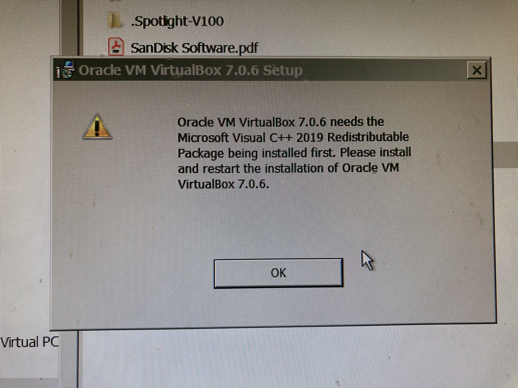

I tired to get Windows XP going and ran into this:
Here's the file at Microsoft.
https://learn.microsoft.com/en-us/cpp/windows/latest-supported-vc-redist?view=msvc-170

You don't have to be interested in amplifier stuff. Maybe you are you still interested in solving your computer problem?
if you are running WinXP and you want to install a currently supported C++ redistributable runtime, then you may out of luck. Sorry, not my doing.
Maybe this would help:
- Windows XP Support: Microsoft ended support for Windows XP on April 8, 2014. Current versions of the Visual C++ Redistributable for Visual Studio 2015-2022 only support Windows Vista, 7, 8.1, 10, and 11. The last version of the Visual C++ Redistributable that works on Windows XP shipped in Visual Studio 2019 version 16.7 (file versions starting with 14.27). The Redistributable is available in the my.visualstudio.com Downloads section as Visual C++ Redistributable for Visual Studio 2019 (version 16.7). Use the Search box to find this version. To download the files, select the platform and language you need, and then choose the Download button.

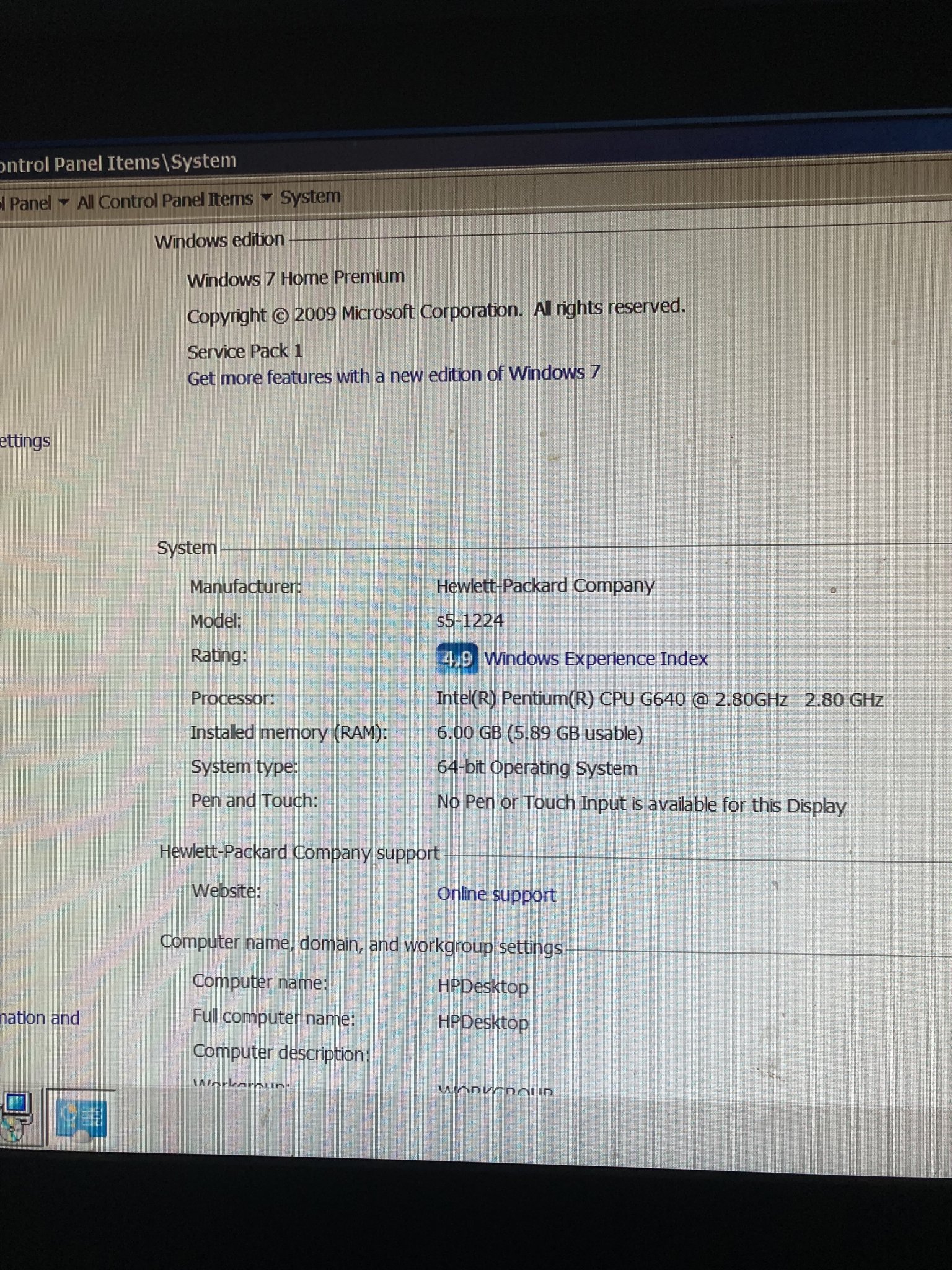

What operating system and version number are you running?
Thank you! 😀
It has been so long I forgot how to check, then your question, suddenly came to me.
I think see an issue, installed x86...
