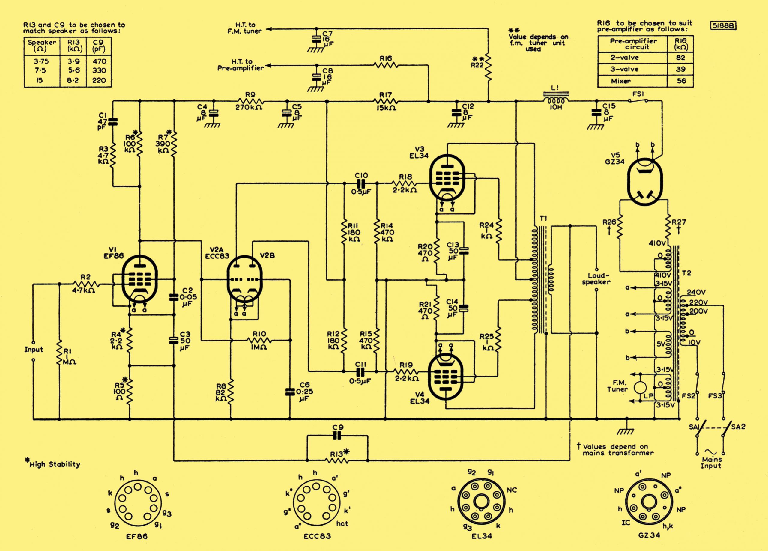

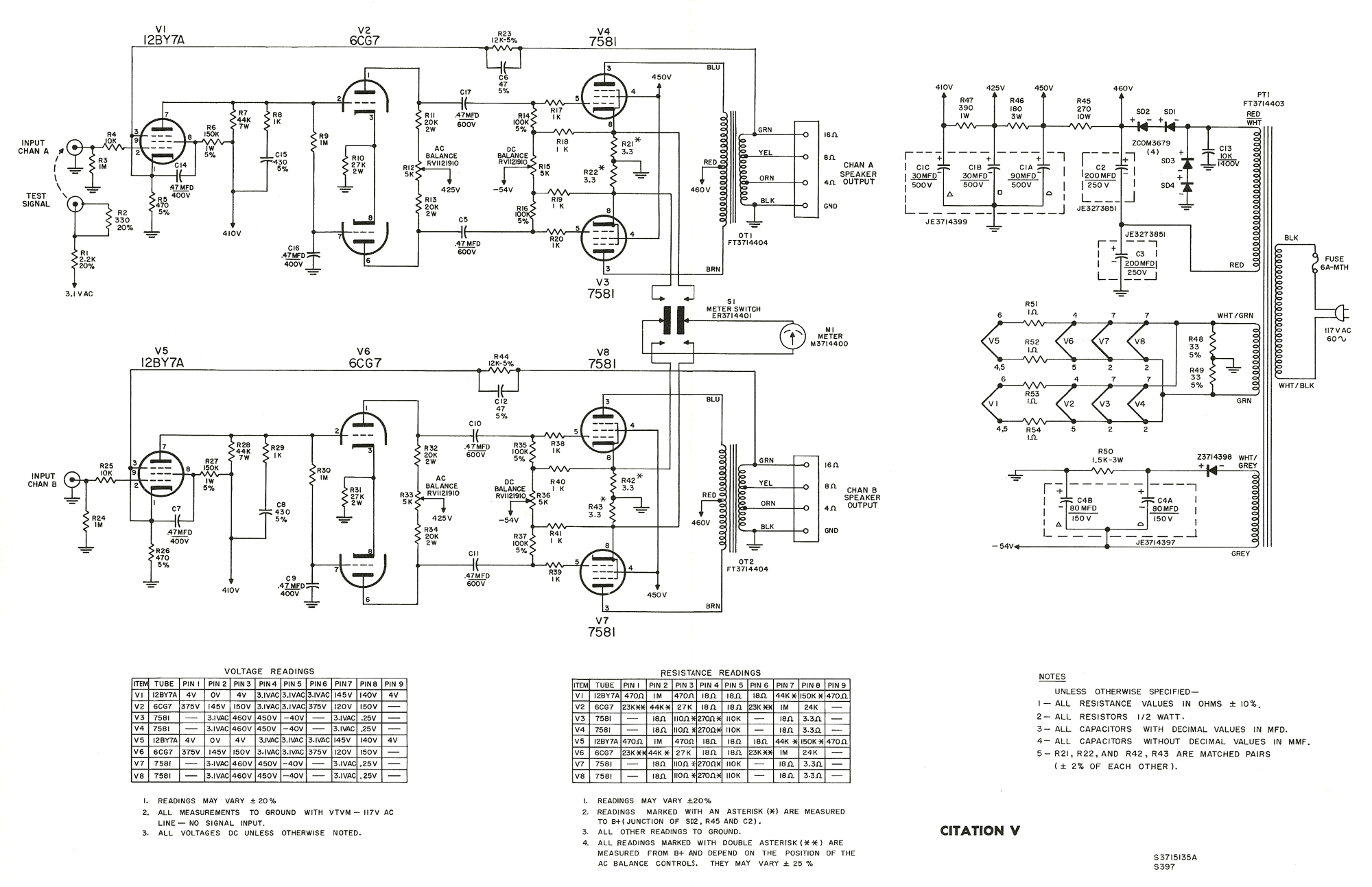

A "Mullard" frontend is a voltage amp coupled to a differential pair inverter. google Mullard 5-20 circuit. I used a pentode voltage amp coupled to a split load inverter on mine, with 17 dB feedback as I recall.
Perhaps the "best" implementation of Mullard style topology can be found in the H/K Cit. 5. Notice the high gm small signal types. The 12BY7 shown is getting scarce and is (IMO) best saved for already built units. A 6922 cascode that replaces the 12BY7 is provided.

The Fisher 400 10k primary output transformers are absolutely first rate iron. You won't have any trouble building a stable amp with these. I built a very nice 22 watt per channel amp using 7868 finals with these transformers. Some of the best measuring iron I've seen.
Ok . . . So this is starting to coalesce. But a few questions - I was under the impression that a “power amp” generally involved just the phase splitter and the output tubes. These foresee a voltage amp before the phase splitter tho. That’s fine from my perspective because I imagine this is more appropriate for the inclusion of a volume and balance control.
I DO want these bits - so does that mean they are situated before the voltage amp, or after (ie., between the voltage amp and the phase splitter)?

There are several topologies that work. In a Mullard-type frontend, you would place the voltage amp before the inverter (the inverter fulfilling both duties of phase inversion as well as driver for the output stage), and if you wanted a volume control, assuming the design had enough gain for the amount of feedback you want to add, you would place the volume control in front of the voltage amp.
For example, if driving a 7868 or 7591 output stage using a Mullard type frontend, you could use a 6SN7 or 6FQ7 inverter stage with another 6SN7 or 6FQ7 voltage amp stage in front of it. This setup will provide enough gain, even with a moderate amount of feedback (say 12 dB), so that a volume pot could be utilized. The amp could then be driven from a mobile phone, for example. In this case you'd have input sensitivity of about 0.5V RMS*, which is about right in my opinion for driving with a mobile device. But if the amp had more than say 0.7V input sensitivity, I think it would be wise to use an external active preamp.
*Drive requirement of a 7868/7591 push pull output stage is approximately 12V RMS to deliver 22 watts output across a 10K primary load. A 6SN7 differential pair inverter/driver stage will have gain of approximately 7.5x from each output leg to ground. A 6SN7 voltage amp stage configured in common cathode arrangement will have open loop gain of approximately 12x, and with 12 dB of feedback applied, closed loop gain will be approximately 3x.
Therefore closed loop sensitivity of the amp will be:
12/(7.5*3) = 0.53V RMS.

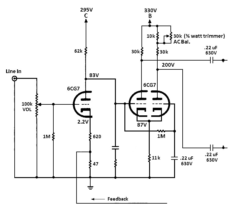

Here's an example.
I’m having trouble with that “phase inverter” circuit. If we suppose the signal driving the first triode grid of the phase inverter tube is (+) then the signal will be (-) as it exits the plate (ie, grid to plate inverts). But the second triode’s grid in the phase inverter tube is also being driven by the same (+) signal as the first. Ie, it’s plate will also be at (-). These signals are still in phase. How can they drive the push pull OP tubes??
Do we need one more (or one less) phase inversion step?
The second triode in the phase inverter is being driven by its cathode, so it does not invert. Its drive signal comes from the first triode's cathode. Notice the second triode's grid is held at AC ground via the 0.22 uF capacitor connected directly from the second triode grid to ground.

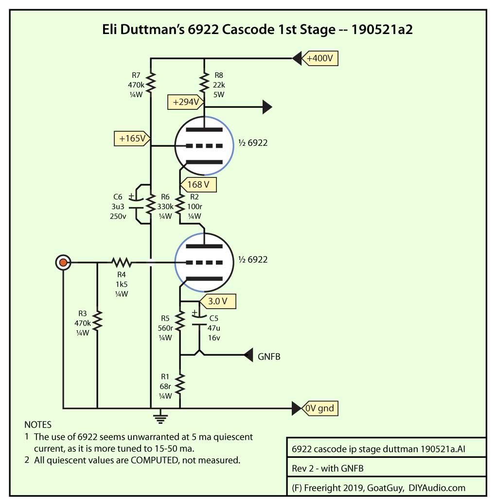

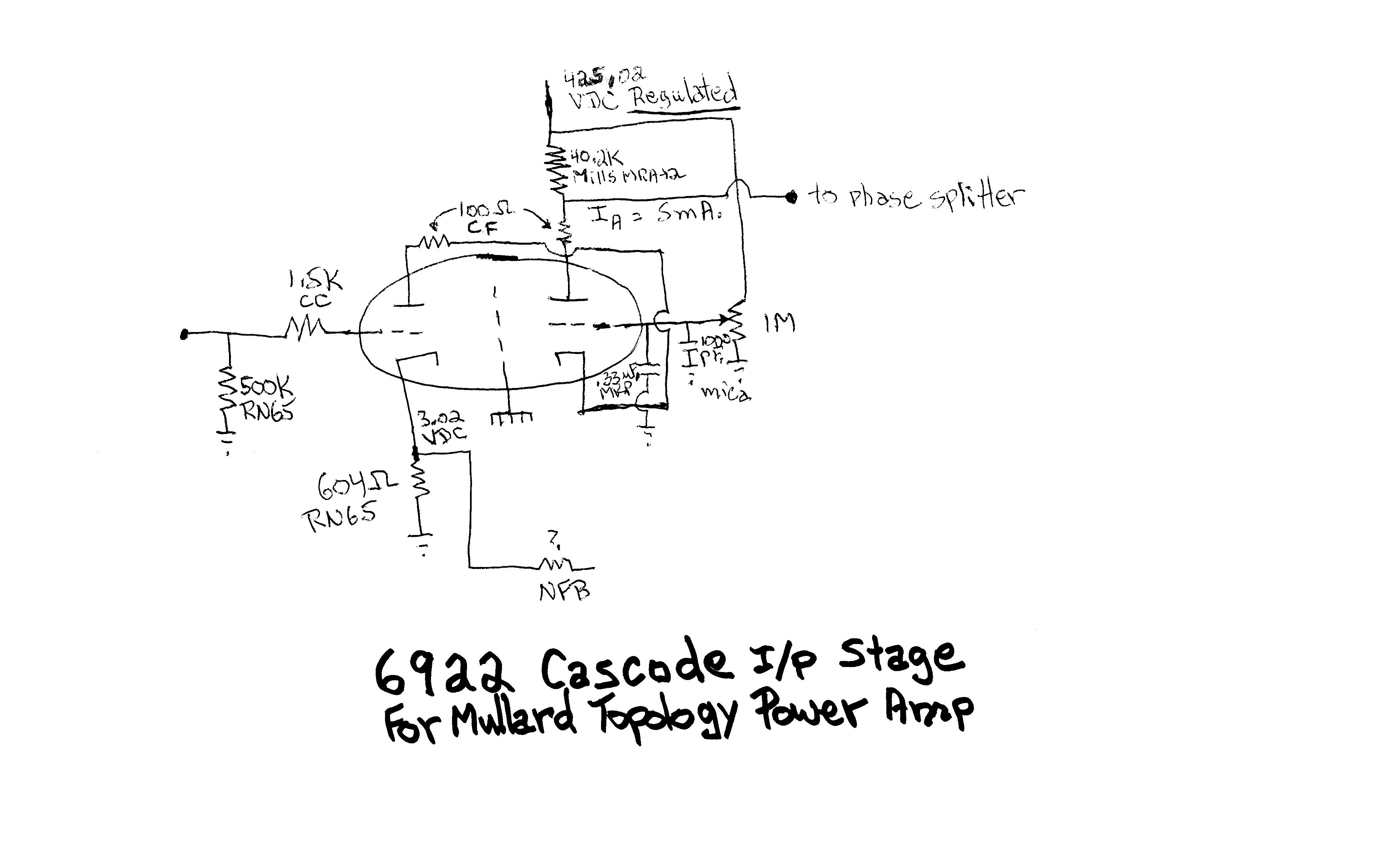

Hmmm... had to redraw, to wrap my brain around ''cascode''.
REV 2 - with GNFB, adjusted values. Thanks KodaBMX
5 mA. is low, but a larger current requires a very "tall" B+ supply. Remember, this cascode is intended to replace the 12BY7 voltage amplifier in a H/K Cit. 5. The B+ rail is what it is, not the object of one's desire.
Stu Hegeman & Co. did not bypass the voltage amplifier's cathode bias resistor and I followed suit.
5 mA. is low, but a larger current requires a very "tall" B+ supply. Remember, this cascode is intended to replace the ¹²BY7 voltage amplifier in a H/K Cit. 5. The B+ rail is what it is, not the object of one's desire.
Yes, well then we agree. The 6922 is also expensive insofar as I can tell on the open market. Good (reputation) ones might run $25 to $75 apiece! That's pretty expensive as a cascode-in-one-bottle solution, which in the end, kind of emulates a small-signal pentode.
Stu​ Hegeman​ &​ Co.​ did​ not​ bypass​ the​ voltage​ amplifier's​ cathode​ bias​ resistor​ and​ I​ followed​ suit.
Yes,​ I​ know.​ ​ But​ then​ I​ saw​ that​ KodaBMX​ posted​ a​ cute​ circuit​ with​ the​ prop-up​ style​ GNFB​ as​ per​ his​ (and​ then​ with​ REV​ 2,​ my)​ drawing.​
Lastly,​ no​ quote,​ but​ a​ new​ thought...​
The​ point​ of​ a​ non-capacitor-bypassed​ cathode​ resistor​ on​ a​ line-stage​ amplifying​ triode​ is​ to​ squash​ most​ of​ the​ C-bypassing-R​ triode​ ³⁄₂​ power​ law​ response​ curve​ of​ the​ triode​ and​ ''tame''​ it​ to​ something​ almost​ linear,​ at​ reduced​ gain​ (LNFB,​ effectively),​ and​ offering​ less​ ''tube​ 'color'​ ''​ to​ the​ amplified​ signal.​ ​
I​ generally​ agree​ with​ the​ sentiment,​ yet​ having​ somewhat​ greater​ gain​ when​ working​ the​ GNFB​ angle​ is​ also​ important.​ ​ Hence​ why​ I​ included​ the​ C-bypassing-R​ cathode​ approach.​ ​
Just​ saying...​ GoatGuy
