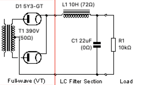

The design could be problematic because of the use of an RF triode/pentode the ECL80 and because it's has a high gain stage. Notice the RC stabilising networks? C9/C7 & R8, that shows the designer had stability issues and needed to roll off the frequency response to stop a stage oscillating. Also the first stage is direct coupled to the cathodyne phase splitter. These aren't big issues and if the design works you may have no trouble at all, the design is just less straight forward than triode front end RC coupled to a long tail pair with AC heaters all round. To be honest I'm probably nit picking and being over cautious.
Is there a way to simplify the power supply? It depends, you could use silicon rectifiers, big caps and no choke, but if you already have the mains tfmr stick with the original design.

Please correct me if I am incorrect, my understanding is the resistor must be at least 12kΩ (not 10kΩ of the original) to prevent melting speaker wires and maybe damaging the drivers. So you leave the 12kΩ in and adding to it reduces the amount fed back. I did read the text recommended, only explained what feedback is, not how to design it.
All that matters is B+ is supplied with 300 to 325 volts, correct?
Look at all those resistors and capacitors, gobs of them don't exist in a tube rectifier power supply was my observation I was trying to say.

RE the ECL80, it's a pentode and triode, the designs first stage is very high gain, it's a pentode with a big anode R. pentodes have higher gain, the bigger the Ra, the higher the gain. The desiner did this because the cathodyne PS (phase splitter) has two low OP's.
Stabilising network is to stop a valve self oscillating: you can add a resistor and cap to roll off the gain at a frequency a tad below were it is oscillating, this is what the designer did I think. It's a big subject, if you watch some of my terrible videos on my channel I explain it somewhere.
