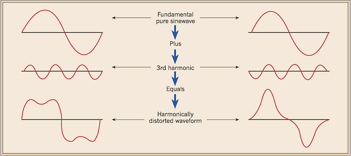

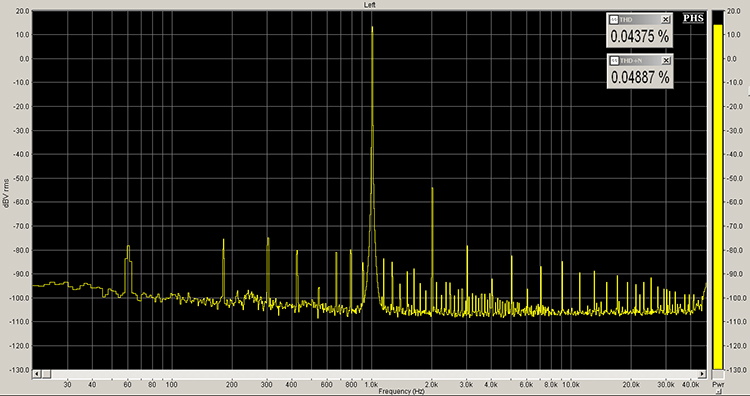

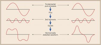

You should decide what you want to measure. I guess you don't want to measure hysteresis in general, there is plenty of illustrative text on that.
Maybe you want to look at a waveform (think sine wave), to visually judge whether it is distorted. Maybe you want to do a frequency analysis to see the same thing in an easier to read format.
Maybe you should become familiar with REW as it does both of these. Apply a sine wave signal, and feed your speaker terminal voltage back to your sound card. Ensure its safety, use a voltage divider to reduce the level as required, get your grounding right.
