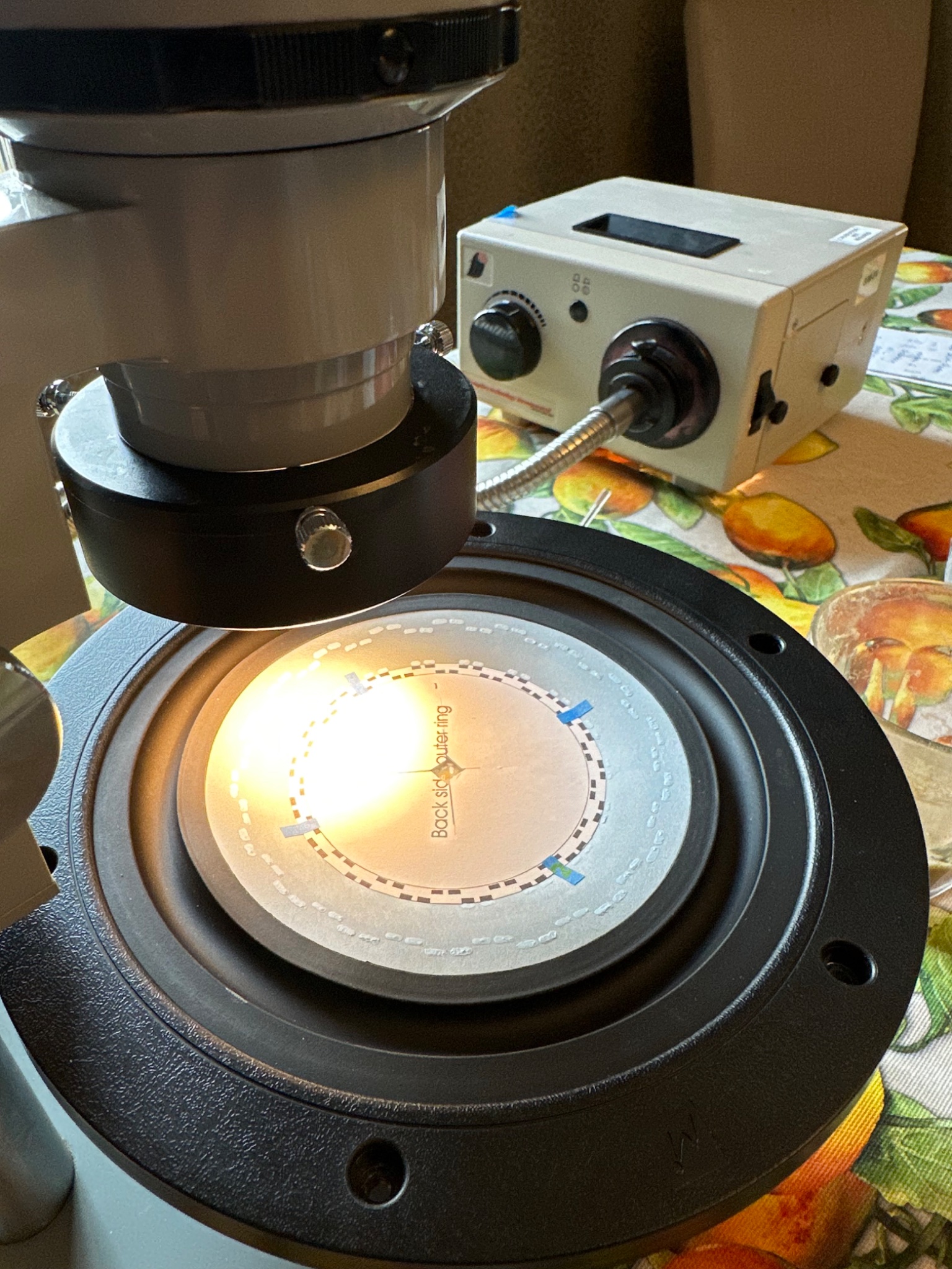

I do all the spots using a stereomicroscope - even the large ones. The magnification helps with precision and suppressing those age-related tremors. (I learned a few tricks over many years doing microneurosurgery in research).
