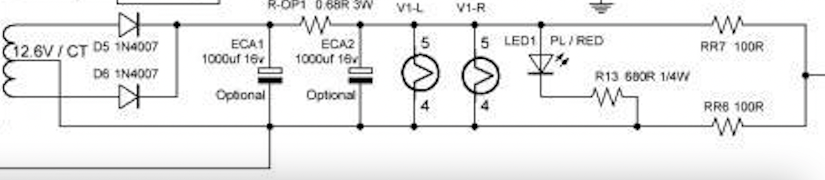

Another learning opportunity: understanding the purpose and how to specify a LED. Looking on Mouser I was overwhelmed with the plethora of choices. How does one choose?

Since it's just a power indicator, it doesn't matter at all. Pick the colour you like and run with it. Adjust the value of R13 to adjust the brightness to your liking.
I appreciate your help, thank you. 🙂
Now I see what you mean and why R13 rated at 1/4W compared to the others.
Yup. In fact, R13 and the LED are "optional parts"... You can leave them out if you want - you just won't have an LED for the power 🙂
Ah, I have heard sometimes used in the circuit for some purpose, forget now, do appreciate coming back and providing additional information. 😀 If serves no benefit other than an indicator, I myself choose green, being seems more logical and my favorite color. 😛
Green it is. 1k resistor will probably be fine. 5k1 if it's an "ultra bright" since they are blinding with even microamperes of current.
