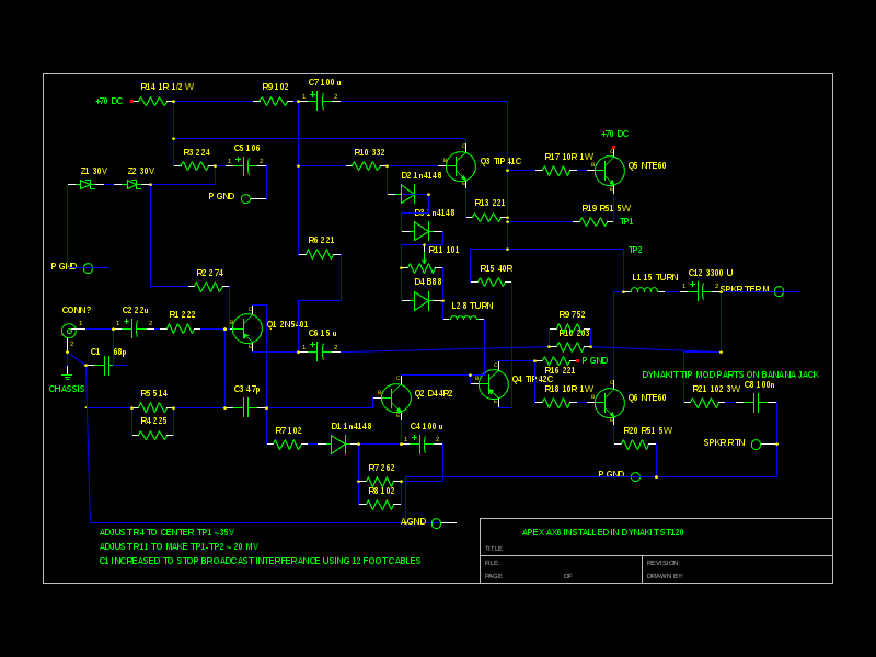

Check out this thread. It may check all your boxes and has superlative performance.
This amp meets all 7 criteria. https://www.diyaudio.com/forums/solid-state/236256-retro-amp-50w-single-supply-42.html My point to point build put out ~75 watts for 5 seconds on 8 ohm speakers. Page 42 shows my point to point boards on 1/16" Nema CE laminate. (micarta/textolite/garolite see mcmaster.com). The heatsinks were much bigger than post #4, something like a Pentium II heatsink. I have fans, PCAT power supply ones run at 7 VDC. Reason I did not use the PC board on page 1, too tall to fit in a dynaco ST120 chassis. I used 69 v 7 A power supply regulated from 72 v open circuit. NTE60 outputs were white box MJ15003 I believe from the datasheet. TIP31c/32c drivers were replaced in final version with MJE15028/29 for better highs. Q2 VAS could be MJE15028 also, D44R2 is a 20 mhz TO220 part. Output transistors and heat sense is on a remote heat sink from the driver board. L2 is close to the driver board to keep feedback from the 6" long wires to the heat sense diodes causing oscillation.
Sound is very good. When it was working properly I couldn't tell the difference at 1-75 w between this and a Peavey CS800s. I tucked the chassis behind the record tower to avoid the sound of the fans. Ran for 4 years up to 14 hours a day then I knocked a wire loose and when I replaced it now it hums some. Now using a Peavey M-2600 however that does not use fans so the RCA input cables can be 2 m instead of 4. C1 was increased to 150 pf ceramic to avoid picking up sports talk AM radio on the 4 m RCA cables. I live 2 miles from the transmitter.
Reactions: bedrock602

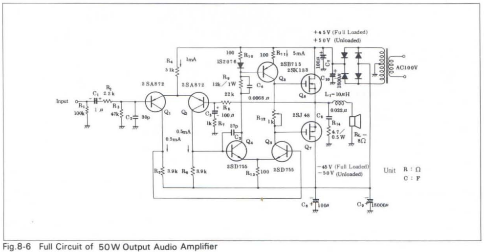

People have modified the Classic Hitachi Mosfet to thermal track enhancement/vertical mosfets
or just a BJT output instead. Or Hunt down laterals/ use modern equivalents
Schematic from Hitachi Power Mos Fet Application Note
R4 often changed over to a 1ma current source instead, among other changes possible
Probably unbeatable simplicity for the performance.
