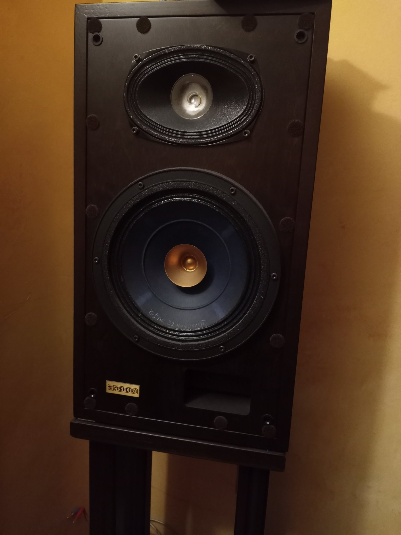

Your opinion is as valid as mine and I guess you have a lot more expertise and practical experience. It's a speaker after all . It's built like a speaker and behaves like a speaker so regardless of what you think about the idea behind it your input in regards to laws of physics is absolutely valid and valuable. We just try and help to make people happy and not necessarily " right " . These are two different things.
This is my speaker so you know from what angle I look on the topic 😉 All the best

I don't think this is a job for a beginner. The idea of buying drivers and putting them in a box, and that honey and milk will flow out of them, is not realistic. I assume that it is not a small investment.
The only thing acceptable in this case is a verified project for that driver.
Interesting claims, someone oughta put a measuring mic to that!The parameters of the speaker are well matched with the dipole charge; indeed the Qts varies from 0.6 to 0.45 in the field of variation of excitement tension. The sensitivity settles around 95 dB/W/m. The linearity is extraordinary; we are impressed by the response extended to almost 20 KHz and most of all for the absence of destructive interference, usually 3-4 KHz between main cone and whizzer and here completely absent.
