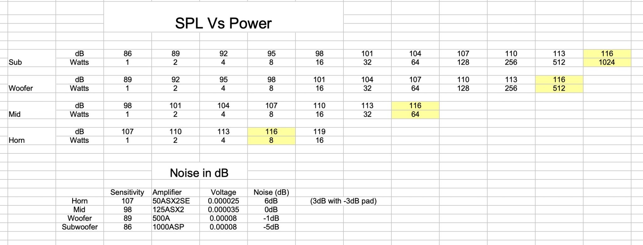

I'm trying to understand if the measurement I got is in a reasonable range for a class A/B amplifier with a switching power supply (i.e. Emotiva XPA Gen3). As I commented previously, reviewers love to discuss dynamic range of amplifiers, but I haven't heard them mention this noise floor with no signal present.
On my amp I measured 15mV, so 15,000µv, and ICEpower is claiming 20-80µV. If my measurement and their ratings are both correct, then I should have built my own amp long ago. But the difference is so large that I'm tempted to think something is wrong with either my measurement or their ratings.
And if a good class D amp really has a noise floor that is ~45dB lower than an A/B amp, why isn't that making the headlines? I would have built my own amp in the beginning, if I knew it would be so much quieter!

Assuming that ICEpower's specs are accurate, this is what seems like the best solution for my specific 8 channel amp requirements. Here I am assuming that all drivers should achieve the same SPL, and I am factoring in their sensitivity to determine how many watts is needed.
In the SPL Vs Power section, the highlighted number is the rated amplifier output for each amplifier, except for the horn. The amplifier I list for the horns is actually 25 watts into 8 ohms x2, but it only requires 8 watts to match the output of the other drivers. So I have some room to pad it down. This should guarantee zero or near zero audible hiss.
The amplifier modules themselves will cost just under $1400. I would anticipate spending a few hundred more, but I'm starting to feel like I understand what I'm getting into, and that it'll work well as a complete system.

I was given a schooling in math over at the ASR forum. It's actually really helpful to understand the relationship between the different characteristics, and especially how to derive specs that are not directly stated to compare products directly.
https://audiosciencereview.com/forum/index.php?threads/minidsp-flex-htx.49512/post-1906197
Through this explanation we are able to determine that my signal processor is quite noisy, and it is made worse by the high gain of my amplifier.
Based on Michael's fromulas (From ASR thread), I was able to determine that my Emotiva Amp has ~80µV residual noise, which is on par with many ICEpower modules, even while the Emotiva has higher gain. So it is pretty good.
So the plan. I need to get the quietest components and reduce the number of components, to reduce noise up stream from the amp. I think this means I'm buying the new MiniDSP HTx processor.
And then I need to get a lower gain amp that is also low noise, something like the 50ASX from ICEpower. But most of the improvement will come from the MiniDSP, so I'll start with that.
