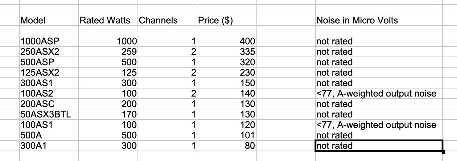

What specification did you read? For what product? I read the data sheet for every ICEpower amp that Parts express sells, and what did I find? Well, I'll show you!Just read the specifications - it's right there.
Absolute output noise in uV. Preferably unweighted (unfiltered).
10-20uV is quite quiet ;-)
The fact that the 100AS1/ AS2 are given a rating means that they were designed to be better? Missing ratings always mean the ratings are not good enough to brag about.
The "<77" means I should expect it to be right around 77....but how does this compare to all the other amps? I don't have any ratings for other amps, and unfortunately Amir at Audio Science Review does not include this output noise in his testing, so that number means next to nothing to me right now.
So I'm hoping someone can provide info on what measurement value is actually good? Is rating of 77 particularly good? Or is it more "meh"?
Amir has a review of the 125ASX2, which is $100 more than the 100AS2. The 125ASX2 landed in the top half of his amplifier ratings, but it was not exceptional. So it seems unlikely that the 100AS2 is a quieter amp at a lower price point. But it has a noise rating that none of the other amps have...
Ok, figuring this out a little. I found µV measurements on the ICEpower website, under specifications tab. But µV measurement is missing from their data sheets? I typically expect data sheets to have the most complete information, so I've been slightly confused.
Would there be any meaningful difference between amps with 20 and 25µV noise?

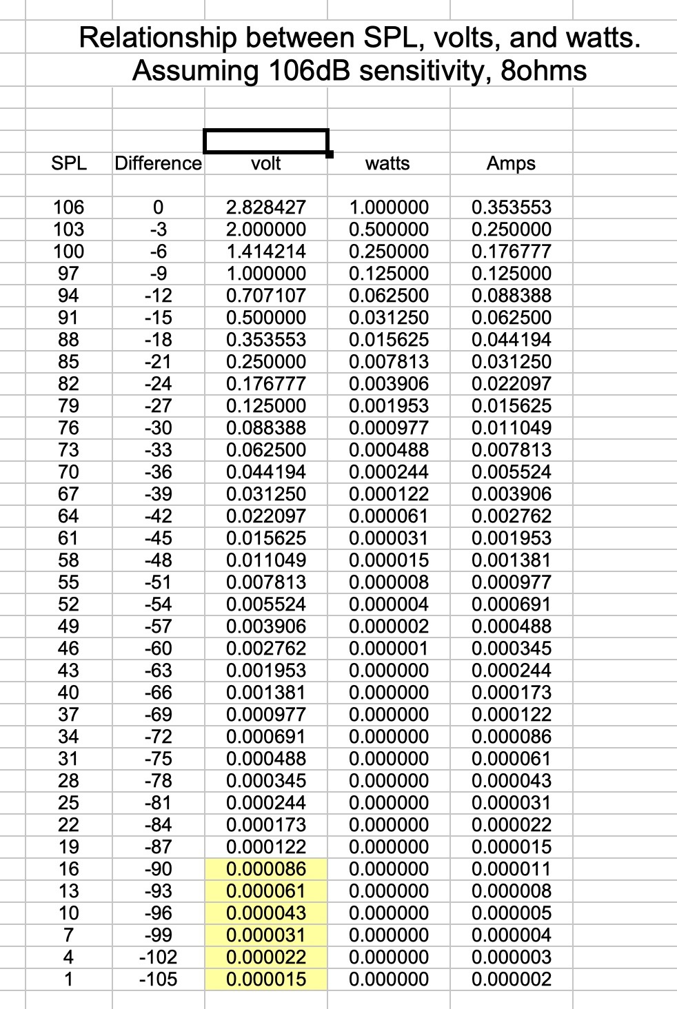

I see how you got the -2dB relative difference, but it is referencing 1v. But the sensitivity measurement of the driver is based on 2.83v
So I made this spreadsheet. Let me know if I got it right? This is from first principles as I understand them, where half the power (watts) = -3dB. So I'm calculating what the voltage and amperate needs to be for each successive power level. My results seem pretty similar to the results from the online calculator, so I'm hoping it is right?
If these numbers are roughly correct, then the noisiest ICEpower amp would produce less than 16dB at 1 meter noise when connected to my horns. The ambient noise is well above that, so it seems output noise is a non-issue with these amps?
Or am I missing something?
I found a good data point for me, atleast. The Genelec 8040A, which I used to own, has a self-noise rating of <= 10dB at 1 meter. I remember hissing being slightly audible when I was close to the speakers.
So it was a mistake to say 16dB noise is inaudible.
Based on my numbers, 20-30µV noise on my horns would be the same or less than the self-noise of the Genelec. That's good enough for me. But is my estimate right? Not sure....
