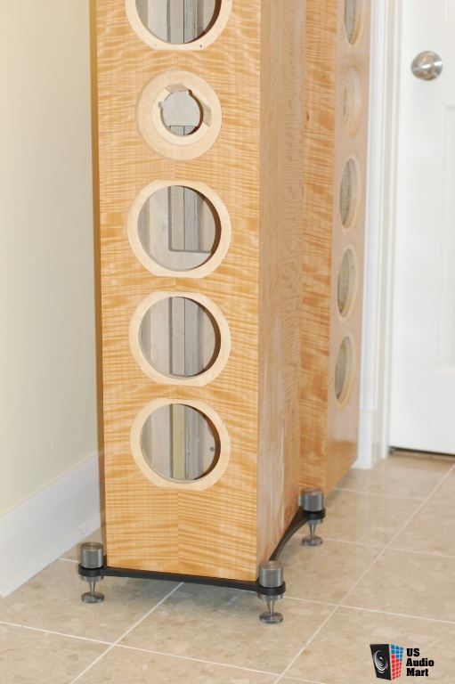

-with a more traditional design, definitely the Elsinore(s).
It's got good extension in-room, and a fantastic crossover (phase response) + a very easy impedance. The crossover is easy (electrically speaking w/ components and wiring). The driver's aren't expensive, and the waveguide for the tweeter (though not inexpensive) is of very high quality.
The "Elsinore Project" Thread
Elsinore Speakers DIY
All with a reasonably narrow baffle ..and the baffles can be done to look good:
