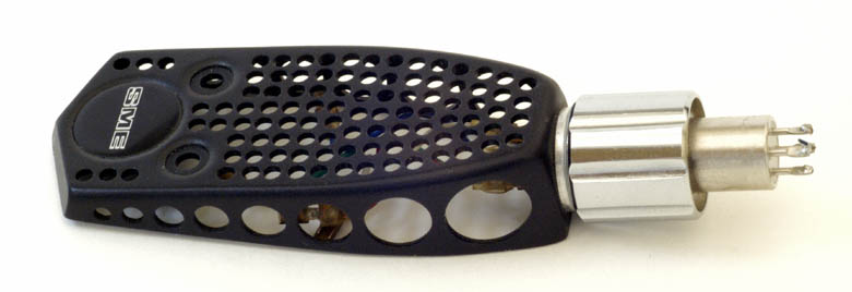

Thinking of which, why can't I possibly just use on these types of headshells after removing the on-board socket and sliding the headshell over the end of the arm tube(and tightening it up with the screw) ?

Because your cartridge needs to be at an angle. All the removable headshells I've seen are for SME-type arms with a curved arm tube.
I dont know exactly how much wide those cartridge mounting slots are in the first two headshells but isn't it possible to mount the cartridge at an angle in one of those ?
although is it neccessary that all of the mounting surface area of the cartridge makes contact with the headshell ?
for the last two they already have some amount of angle so it seems like it'd be just a matter of "fine-tuning" the zenith.
percy said:Although is it necessary that all of the mounting surface area of the cartridge makes contact with the headshell?
Oddly enough, I was looking at an SME headshell and wondering that exact same thing a few minutes ago. I've always made my headshells like the one in the photograph because I've usually made my arm to suit my cartridge, and none of my cartridges have had any mounting surface forward of the screws. But what if you had a Koetsu or something that was effectively a big rectangular block with screws in the middle? If you imagine that you only support at the screws, then it's easy to imagine the cartridge rocking at that point. Supporting at each end would stop that rocking. So, I conclude that if your cartridge can be suported at each end, then your headshell should do so. In which case, my design would need to be extended forward a little.
I doubt if the slots on a straight headshell would allow you to rotate a cartridge by the 22 degrees typically needed (9" arm), and even if it could, it would look rather messy.

EC8010 said:You can make a headshell out of 1 1/2" aluminium angle (1/8" thick). I made this with the assistance of a Black & Decker power drill in a stand, a junior hacksaw, and a few files.
EC8010, would you by any chance know how much this headshell weights ? just the headshell without all the mounting hardware and leads and stuff.

percy said:![]()
EC8010, would you by any chance know how much this headshell weights ? Just the headshell without all the mounting hardware and leads and stuff.
I'd weigh it on the kitchen scales I got as a Christmas present but the headshell is now on an arm in Hong Kong. You can calculate the mass by knowing that aluminium has a relative density of 2.7 and the headshell was 1/8" thick.
