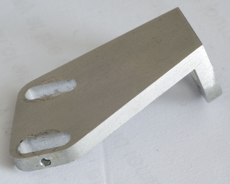

I am thinking of dumping the plastic headshell on my BIC 960 turntable and see what I can do to put a better headshell with a better contact with the tonearm. Here is how the end of the tonearm looks like after removing the stock headshell -
First, are there any ready made headshells that I could clamp/sleev over the open end of the tube ?(The outside diameter of the tube is 5/32"). Like the one on this Formula 4 arm -

Thanks bulgin. The headshell in the photograph was originally simply glued with epoxy to a Thorens TD166 arm "wand". Two years later, the bicycle style cup and cone bearings in the arm wore out, so the arm was ditched but I kept the headshell. The headshell is now on a Minisonic arm, and now that I have a lathe, acquired a bush to allow better fixing.
About twenty years ago, I made another headshell to the same design but cut a slot in the headshell near the arm tube hole using a jeweller's saw, then drilled and tapped 8BA across the slot to make the headshell clamp the arm tube (thus allowing adjustment). That headshell is still on a friend's Dual 505.

EC8010, that is exactly what I had in mind!
I am also tossing around the idea of removing the socket from readily available headshells and then fitting the headshell over the wand. Or keep the socket and trim the locking pins if the entire socket fits inside the tube.

oh so they dont have the slots which allows a cartridge to be mounted at an angle. That's not gonna work. I need a 24°-25° degree angle (based on John Elison's spreadsheet for calculating Baerwald or Loefgren alignment).

Actually, making that headshell wasn't nearly as hard as you might think, it just required patience. Sadly, I'm reaching the age where you begin to see the point of hats...
