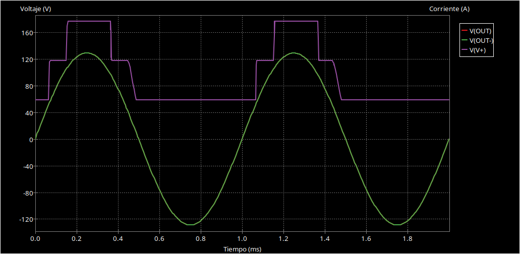

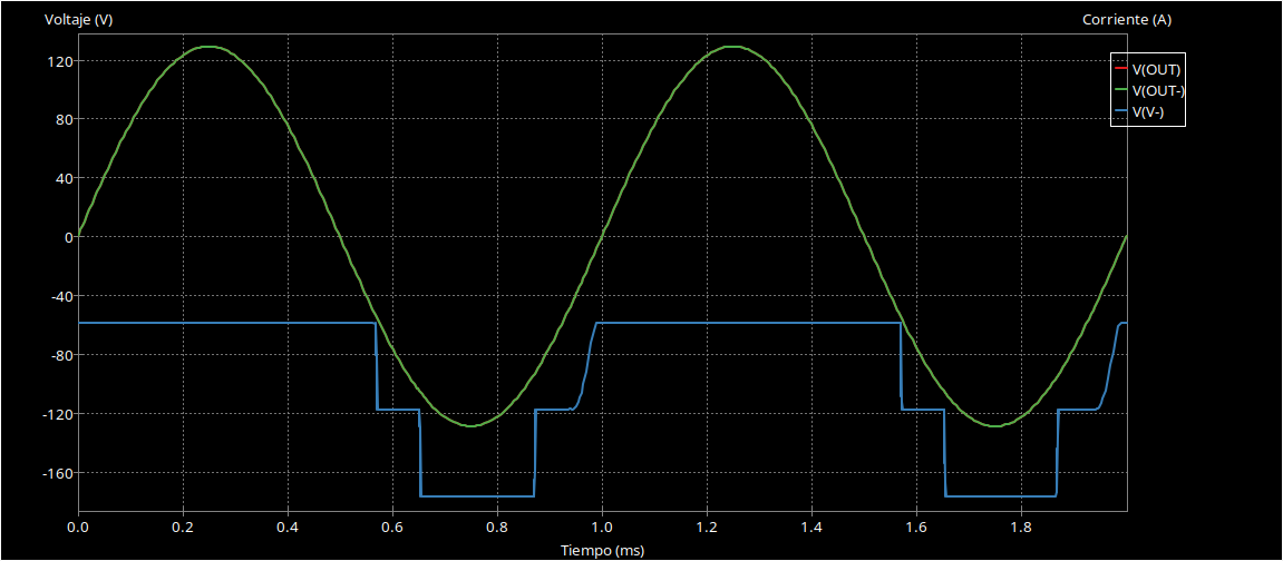

Multiple rails - at least 3 step. One I’m (still) working on is 4, on +/-165V. I had a lower voltage prototype working well on +/-140, 3-step. The unit just didn’t lend itself to road use - but bench tested fine.
High efficiency - won’t be class D efficient, but still power savings over class AB is dramatic. Even going from 2 to 3 steps is a huge boost in efficiency at normal music levels. The boost becomes less as you push it to war volume, because that’s when 2 step is at its best. 2 step is HORRIBLE if you are using active limiting ahead of the amplifier (to protect speakers). It can never approach full output but is being constantly driven hard enough to switch to the high rail. Not a good combination. The more steps you have the better off you are when using active limiting.

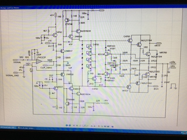

Best BJTs to use - there is only one logical choice, MJL21193/4. Do not use mosfet output transistors at this power level or attempt to use 2SC5200’s. Mosfet switches are required - look for 5 milliohms or less, in TO-247. 60 or75V types are all thats needed. Types offered for sale change almost daily. You might not be able to buy the same ones twice.

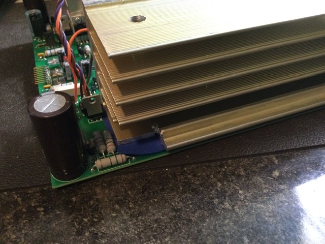

Layout guidelines - keep the power switching at the opposite end from the audio stage. Use a pair of clamshell heat sinks which put the inputs next to each other. Put all the supervisor/protection on a daughter board - you may be able to share it between two channels.

The 3 tier did just under 1400 wpc. I don’t think there is a full schematic for it - it is literally pieces. It’s an amp that I’ve used before with rail switches added, with a daughterboard for the preamp and supervisor circuits, which were developed separately. I can probably dig up the pieces. I never actually measured distortion on it, but the old +/-127V class AB cascode output amp that it was based on did about .02% at 20k. And melted the plugs off the extension cords one 4th of July evening. I was running lab horns with them at a fireworks show. THAT convinced me I had to go to H class to do any real gigs with. I bought some used CA18’s that were retired from touring.

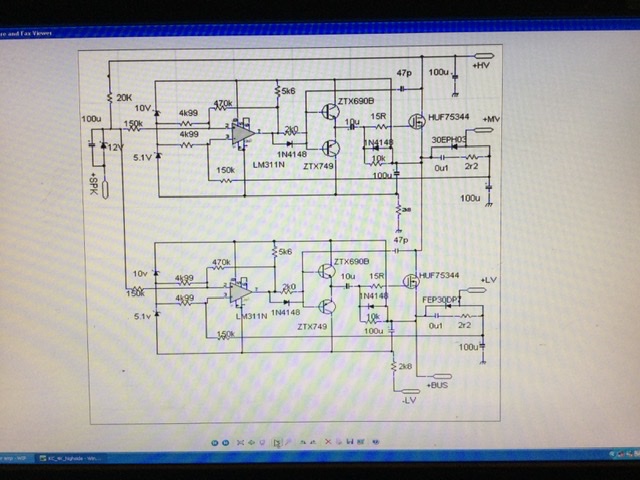

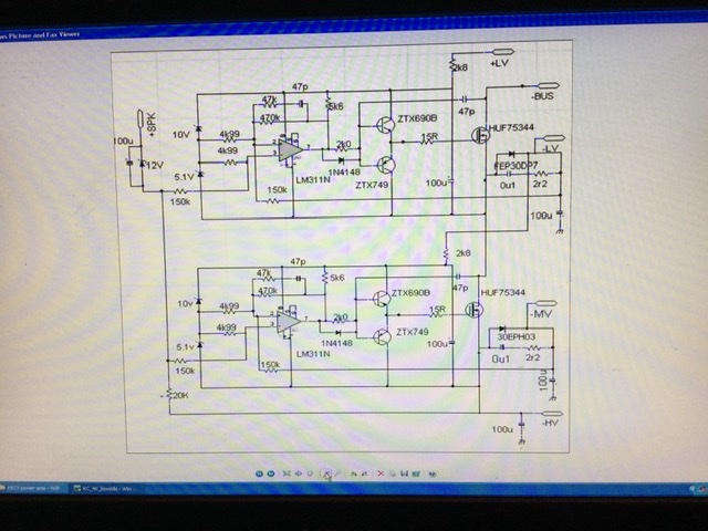

I’ll see if I can get some good legible pictures off the screen of my CAD computer this evening. It literally cannot talk to the machines I use for entertainment, which this qualifies as. Neither can my financial computer. The air gap is the only true security measure, unfortunately, unless I throw continuous money at the problem. Even then, s*** happens. I’d rather put more money into more transformers, rather than some stupid subscription-based security solution. Paranoid? Damn right. Cheapskate? That too.
This is the audio section from the 3 tier. The amp itself is not really that complicated. Only one pair of outputs is shown, but it uses nine pairs, plus the drivers. Preamp and protection stuff is on another board.
The only full module pic I have right now isn’t a very good one. I’ll see if it’s possible to unpack easily, and get something better.
