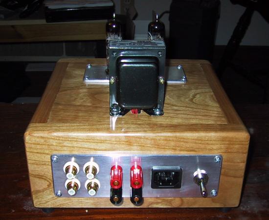

Hello Grahamn;
I've run into the same problem ("short" components with thick wood chassis) and now use 1/8" thick aluminium sheet stock as "mounting plates". Just buy some 2" wide (or 3" wide or whatever) stock and cut off the right length with a conventional saw and mitre box. Then round the corners using a file and drill holes using a punch to establish centre and a conventional power drill (you do need to clamp the piece down to a scrap piece of wood - otherwise it's got a tendency for the drill to "screw it's way through the wood", which makes it hard to control).
Don't know if this is what you're after, but it's just a thought.
Good luck with it!

Hi Grahamn;
>>>...Nice tube amp, Morse. What is it? Nice woodwork, too...<<<
Thank you. That's the Gnat, a 6BM8 miniamp I built a while back. It's got about 3 wpc, and cost a bit over $100 in it's current configuration; the biggest limitation is the poor bass response due to the cheapie output trafos, but I plan a nicer version with better iron. You can see pics of some of my other amps at my site: http://home.earthlink.net/~shidenkai/index.html It doesn't include pics of any of my chip based headphone amps, or the TDA2030A that I (finally) got working about 10 minutes ago. That's playing in the background now on it's breakin trials and Gary Puckett and the Union Gap sound just fine.....
