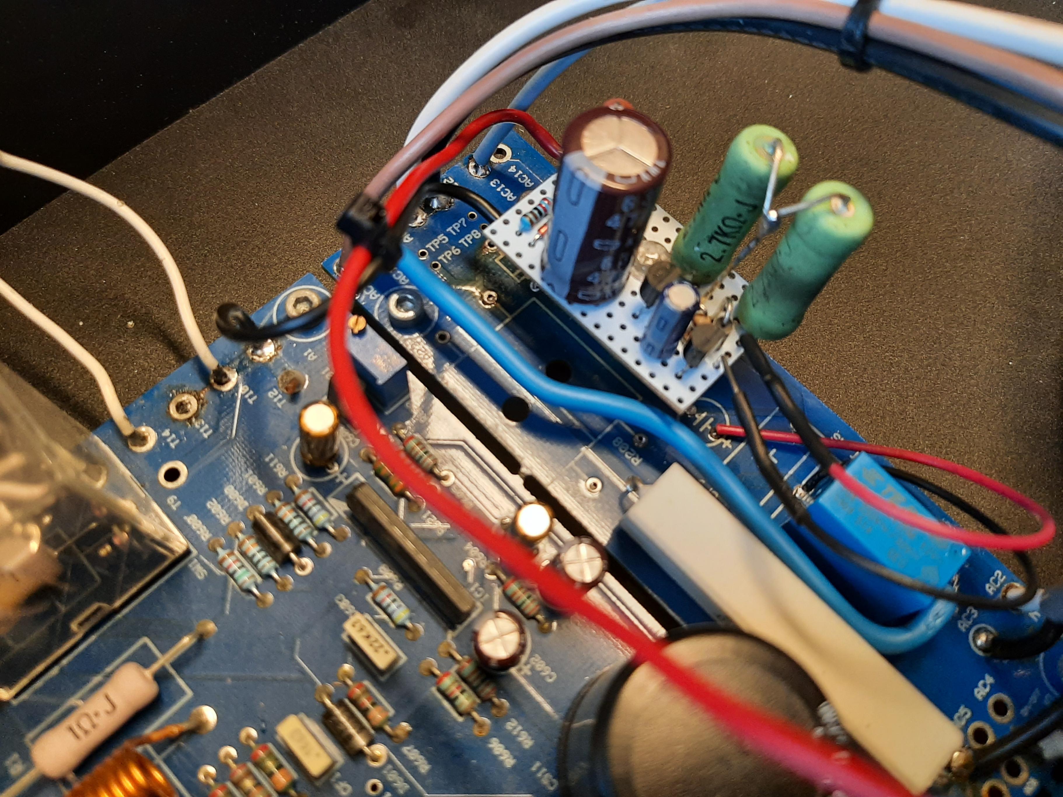

Did a series of tests powering up one of the amps with no bulb limiter and softstart bypassed. No problems. I would prefer to include a softstart circuit though, and are currently looking at a few options. One option that crossed my mind is to keep the relay and limit resistor, and tapping in to the DC on PSU board driving a delay circuit based on a 555. I have a few of those already

Some useful soft start circuits here:
Soft-Start Circuit For Power Amps
Will run of secondary side instead of the mains side. If you want to run at lower voltage a good soft start will run it's own supply though (separate transformer) to avoid any issues with fuses not blowing under fault conditions, if the main amplifier supply voltage doesn't reach full voltage it can stop the soft start relay engaging. Could result in the soft start resistor smoking/catching fire and the fuse will never blow...
Thanks for the link! Very informative. I'm going to read a bit and see if I can't make some decition of what to do.
Seems like a good point though to have a dedicated transformer powering the inrush circuit
I had planned to update and end this thread earlier but spare time is scarce. Anyhow, I went out and got myself a scope, had to learn how to use it. Then I built a iteration of the circuit in the latest link. This has worked nicely and amps has been in use for some time now. A (late) thanks to all contributions
