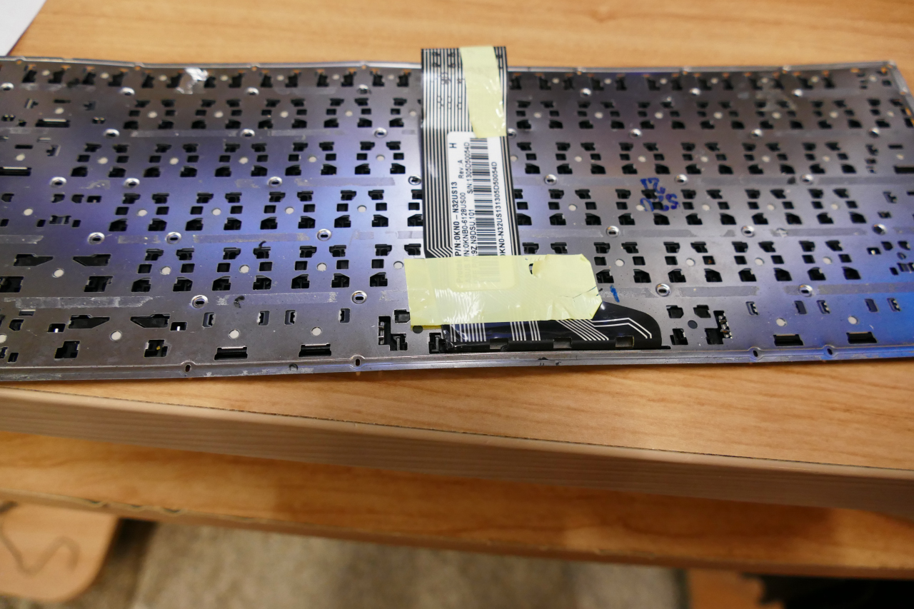

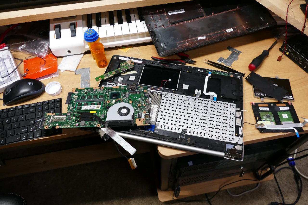

Check Amazon and Ebay. I got a "replacement" keyboard for a 5 year old Asus laptop form Amazon for $20 direct shipped from China. For that price I expected a pull from a dead machine, but the keyboard I got was new, and better quality than the one that came in the machine when new. It took a bit of surgery to to a keyboard transplant, but the patient lived and is still kicking today after over a year.
The laptop had been intermittent since it was about a year old, then finally lost several keys. The flex circuit on the keyboard had been rubbing against the laser cut edge of the hard drive bracket, which eventually cut the flex. The broken trace is on the left side at the bottom of the picture where the flex is crushed and torn.
