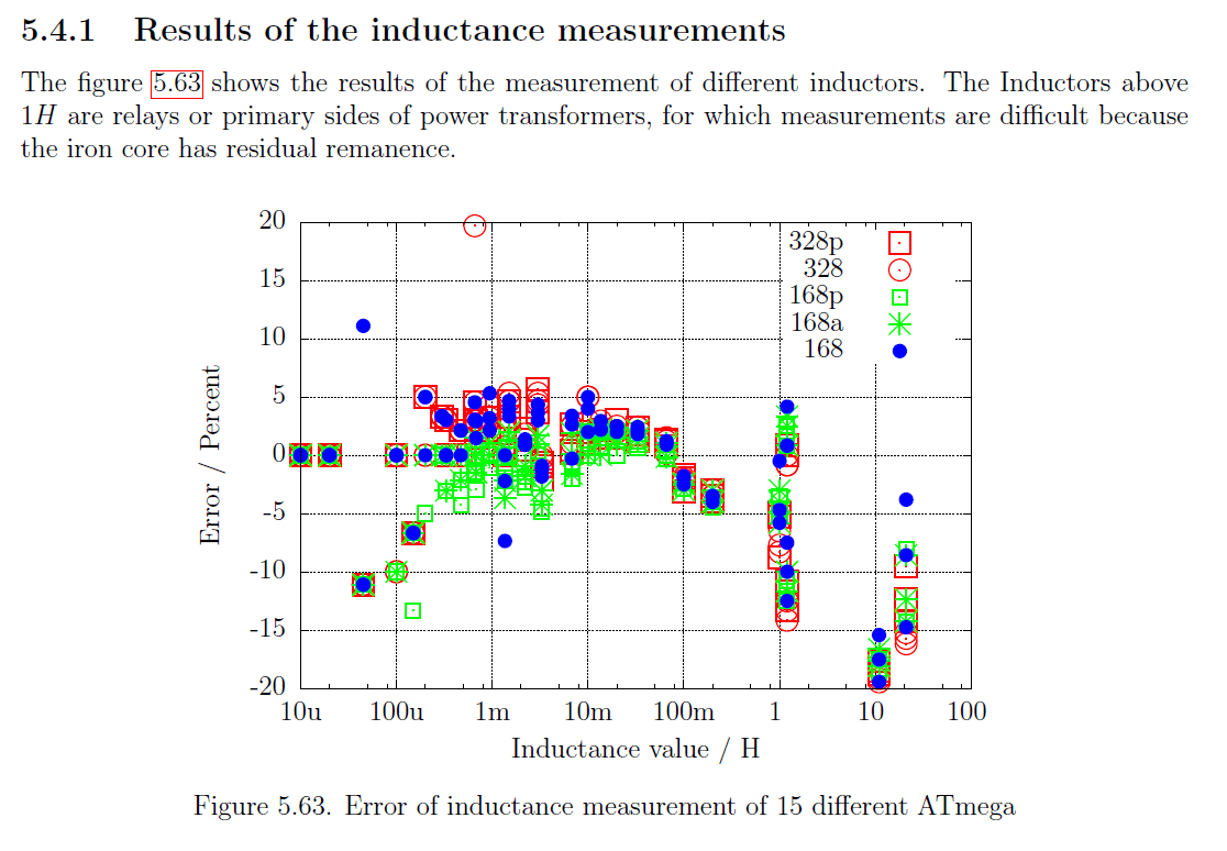

They all copied the original Mega328 firmware written by Karl-Heinz Ku:bbeler for his original thesis project. Lucky for us, his thesis is available on the web: "TransistorTester with AVR microcontroller" and I am sure that bing.com or duckduckgo.com can find it easily.
Here is a graph from that thesis. It shows that the error between Mega328-reported inductance, and actual correct inductance, is approximately 10 percent for a 60 microhenry inductor. If you need better accuracy than that, spend more money and purchase a grown up instrument like a DER-EE DE-5000 LCR meter from Amazon (most expensive option) or eBay (least expensive option)

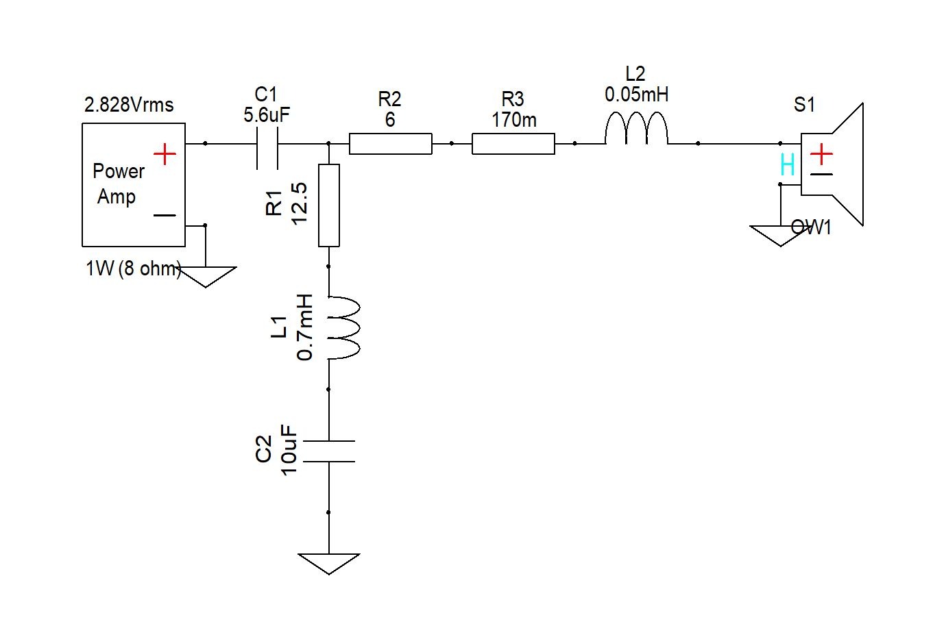

Madisound has a 0.05 mH / 0.17 DCR inductor HERE. I wondered how much of a difference it would make in the response. So I converted the OW1 frequency response and impedance graphs (LINK) into .frd and .zma files respectively. I then created a XSim project with the original inductor and then the Madisound inductor. Here's the modified Xover and response plot of both Xovers. The red plot is the original Xover and the blue plot is the modified Xover.

Thank you for all the replies! I've decided if I decide to build the CAOW1 the best (and maybe simplest) thing to do would be get an LCR meter and commence unwinding. I won't be contacting retailers for "custom" inductors.
