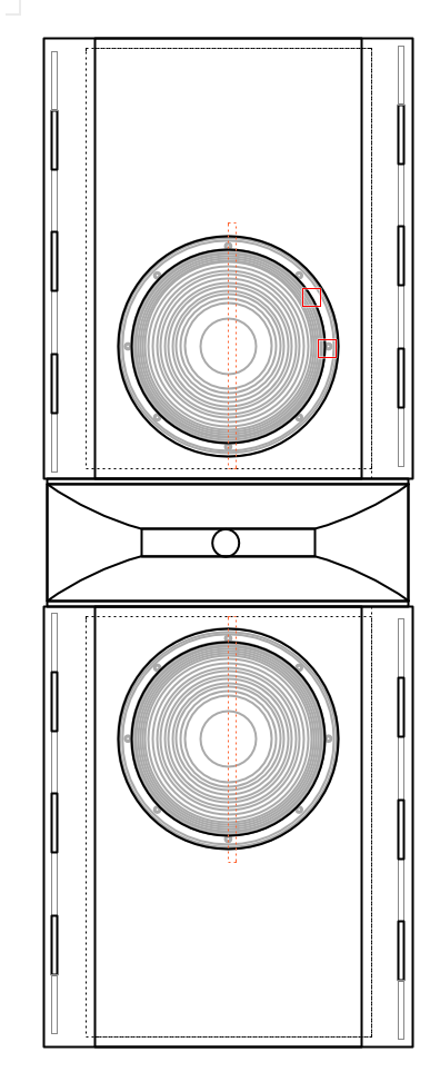

I have a pair of TAD TD-2001 I planned to use with a A-480 Yuichi Arai or Joseph Crowe ES-600 horns.
My original plan was to pair them with Fostex FW305 (12 inch) and cross around 800hz give or take.
Now a pair of TAD TL-1601A (15 inch) became available for a good price. So I’m wondering if i should change course and go with those instead.
I haven’t seem many people online use these two in a twoway system, usually they pair them with a bigger 300hz horns and 4001’s (4 inch). Like in the 2402. Although the 1601’s seem te be useable to about 1,2kHz.. so im thinking why not?
Only problem i can think of would be the directivity matching. Let me know your thoughts.

if not in need of high spl, cross the TD-2001 lower on Arai 480 or Yamamoto SS-500 ?
Then the TL-1601A is a better choice.
Clever use of cabinet shape can help shape the directivity.

FW305) pros: smaller box for similar bass extension, wider beamwidth (less directivity) at 800Hz
Cons: more excursion required for same SPL output (hence more distortion at HIGH SPLs)
TL-1601A (or -B)) pros: less excursion required for same SPL output (hence less distortion at HIGH SPLs)
cons: narrower beamwidth (more directivity) at 800Hz, bigger box for similar bass extension

I believe that you can use the shape of your loudspeaker as a waveguide.
I've mentioned this offhand in a few threads, but I thought I'd provide some evidence. Basically I'd been obsessing about the shape of my newest loudspeaker and some people were wondering why I was being so obsessive about the width and the depth of the enclosure.
The answer? Because the width and the depth of the enclosure act as a waveguide.

For example there is a reason why most 'pa' speakers using a 1" and 12/15" crossed high for spl uses a trapezoidal enclosure.
Look at examples from JBL, Yamaha, Peavey, Meyer etc.
sorry for the short answer, but there is plenty to read. And im busy for some days.

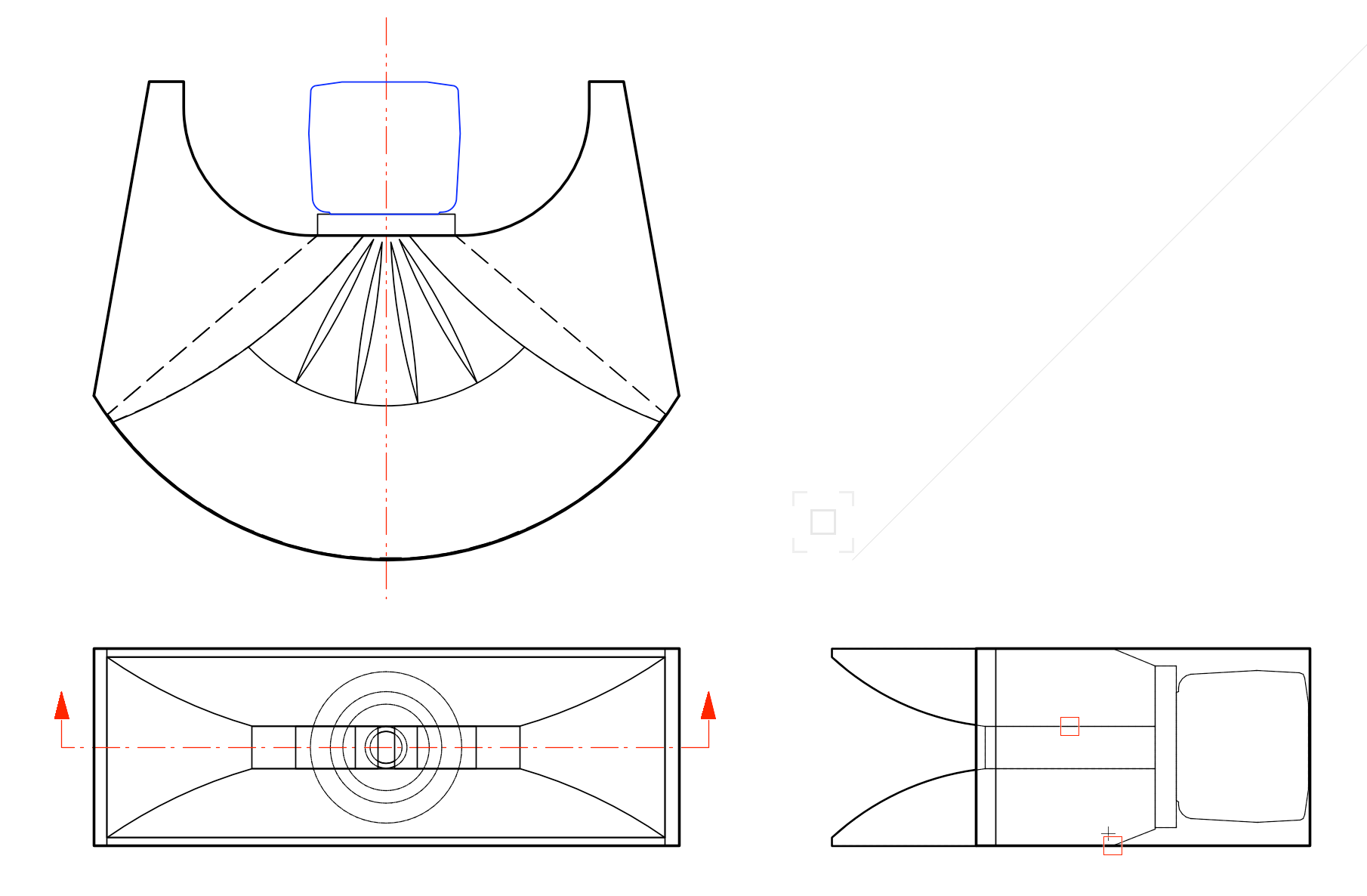

@planet10 Looks like the example you send uses a bigger horn then i intent to use. Sorta mitigates the problem I'm facing. Or does that cab adress some directivity issue like Arez mentioned? Looks good though!
It is a Yuchi horn, with extended termination and made to the size of the woofer enclosure.
