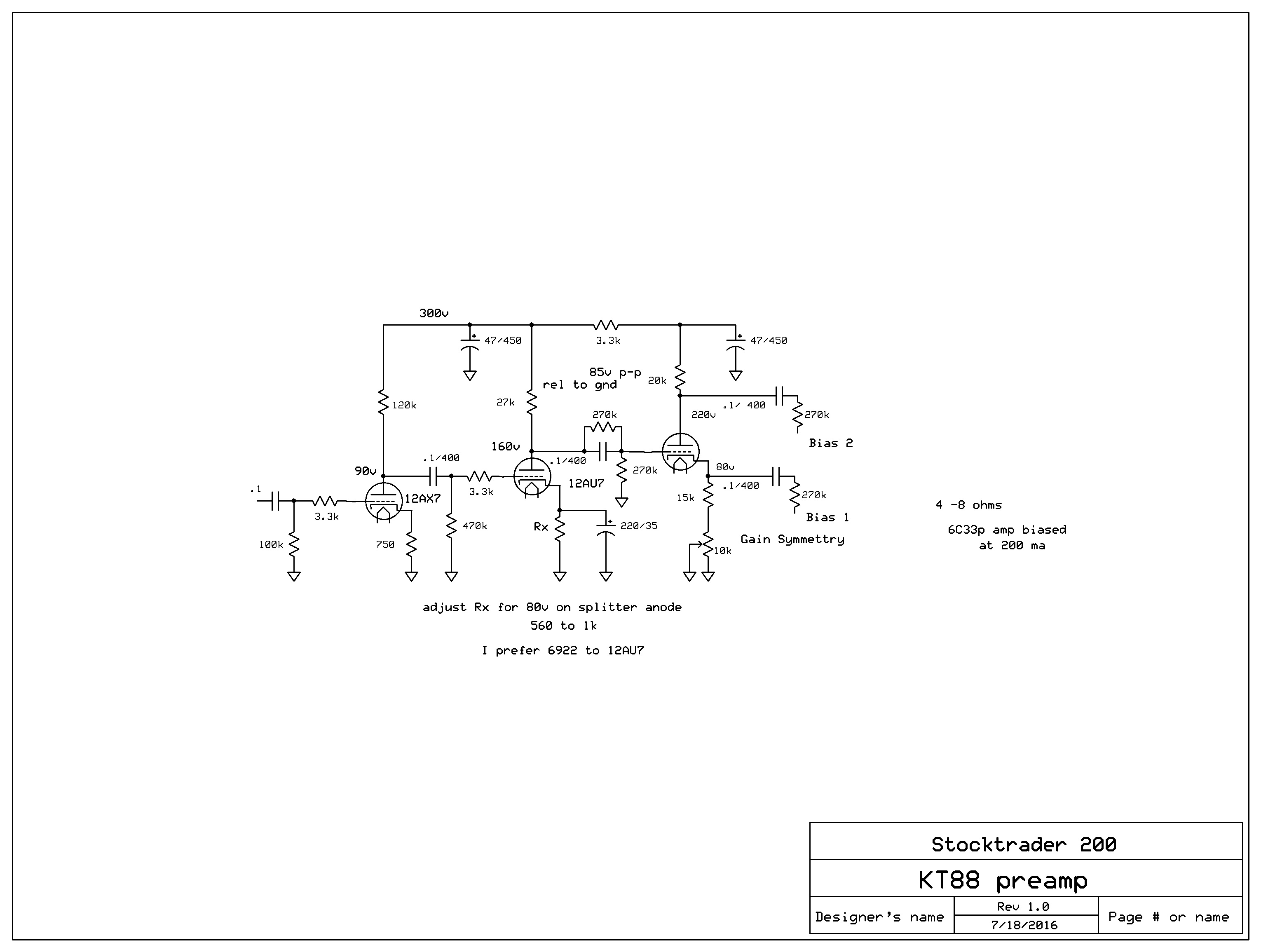

I would use the 1/2 12AU7 for more gain after the 12AX7 and then feed the other half 12AU7 used as splitter concertina with about 6 ma bias on it.
As it sits, the gain between both halves is not guaranteed to be the same.
it also requires 1 less triode.
Here is what I would build, shown with 4ma bias @300v
I pasted from another cct , 90 v on 12AX& should be 200v *6C33 error sorry

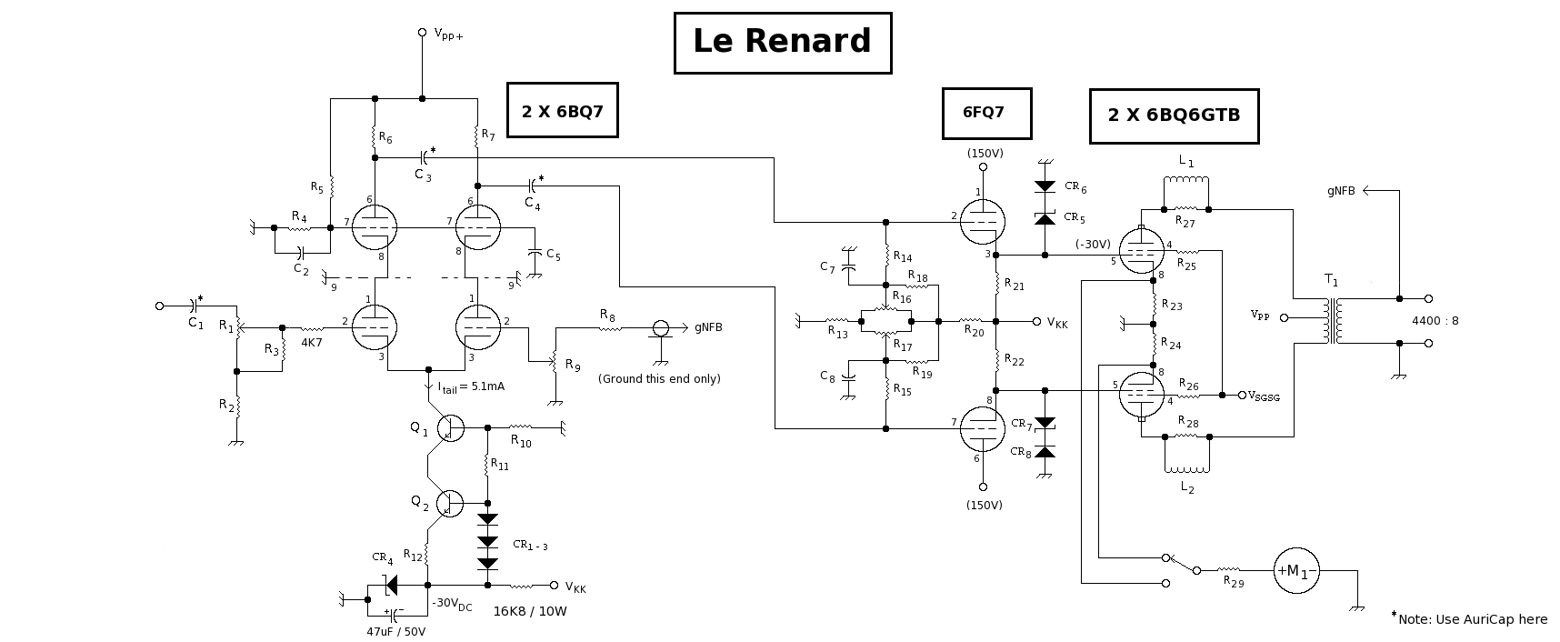

Tubelab (George) participated in a thread where he helped member Chrish design a push-pull 6L6GC class AB2 amp with a 6SN7 LTP feeding a 6SN7 differential pair driver. Read into the thread to get to Chrish's final version. I'm sorry I don't remember exactly where it is in the long thread.
http://www.diyaudio.com/forums/tubes-valves/133034-6l6gc-ab2-amp.html
