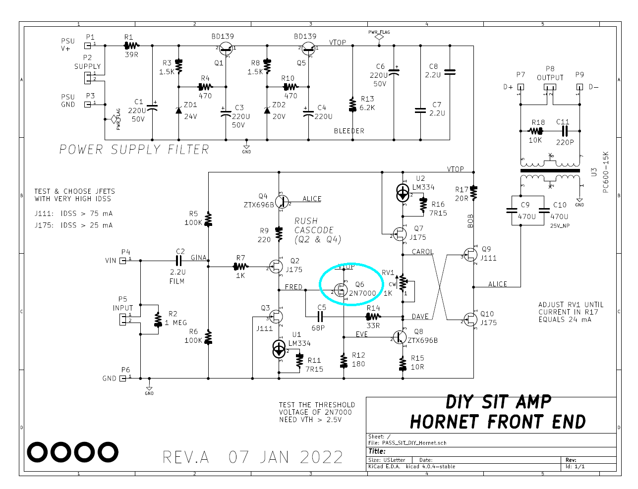

Here's one in an audio amplifier. Thanks to ZD2 and Q5, the MOSFET sees waaaay less than 60 volts from drain to source.
The input impedance of the MOSFET follower is extremely high, in fact it's higher than the output impedance of the cascoded current source (U1 + Q3). Thus the input stage operates at enormous gain:
Gain = gm_q2 * (rout_q3 //parallel_to// zin_q6)

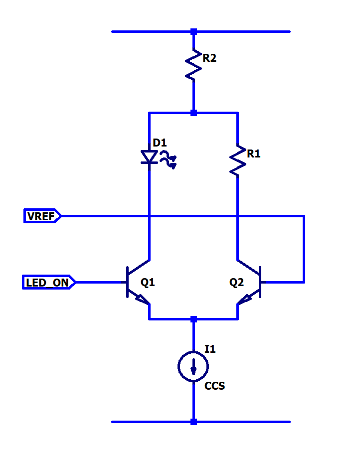

I am re design a microphone preamplifier for ultra low noise. Eight in a 1U rack.
The challenge is not so about circuit noises, well known topics, but hum and noise from grounds.
This asks for differential circuits well balanced. Extreme common mode rejection. Low noise PSUs and PSRR. This I have acheived. Most runs from +15v 15v with about nothing tied to 0v analg ( virtual ) ground. PSU current is near constant.
Then I must add a LED peak level detector to indicate audio overload.
This is quite simple, basically a comparator ( LM393 ) to flash a red Led when audio level is more than +12 dBu rms.
This circuit is single ended, the issue is to not mess the analog ground. Mess from Led current that jumps 0mA / 4mA and Led control.
I try not to go all the way with separate ground and galvanic isolation with optocouplers.

Use a standard trick from the digital guys, specifically NPN emitter coupled logic:
Leave the LED current source on all the time; never switch it off. Instead: steer the current. Either steer it to the LED, or steer it to a dummy load. Voila, the constant current remains constant, and nothing is injected onto the supplies or the grounds. I seem to recall Douglas Self doing something roughly similar in his Small Signal Audio Design book, in one of the last few chapters.
Here's one possible implementation. When the voltage at LED_ON is greater than the voltage at VREF, Q1 steers the constant current into the LED ("D1"). And when the voltage at LED_ON is less than the voltage at VREF, Q2 steers the constant current into dummy load resistor R1. As desired, the LED blinks on and off, but there is no noise injected into the supplies. Clearly the current in R2 is equal to the current in the CCS. So the top supply rail sees a constant, unchanging, current. Same as the bottom supply rail.
You probably noticed that R1 and R2 are completely optional; they are only included to make the drawing simple and symmetric. The circuit works equally well when R1=0 or R2=0 or both.
This sort of thing is done fairly frequently when the LED is a laser emitter and the constant current is hundreds of milliamps.
