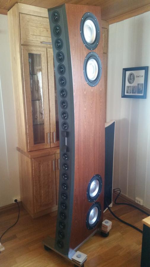

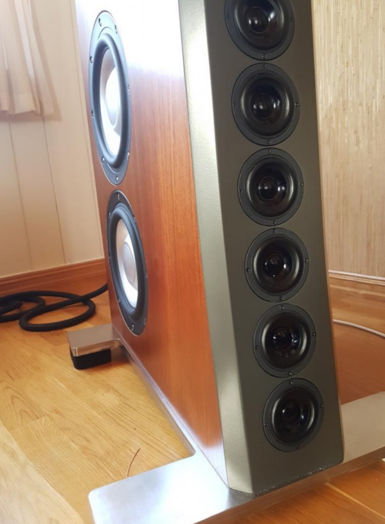

xo point are 180hz/4th LR and 3500/2nd LR. Woofer delay is compensated by DSP.
Later the tweeter was upgraded to Raal 140-15D AM AG with Cornell-Dubilier bypass caps at the 40 uF safety capacitor adding more "air" ( at least mentally ;-) )
It's Hypex DSP and 6x nCore. I did not witness the DSP tuning detailing, so I do not know the exact details here.
